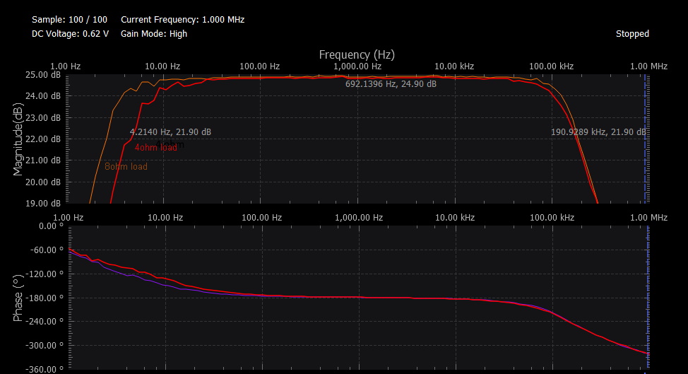

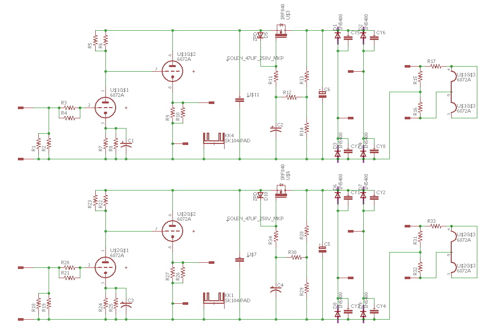

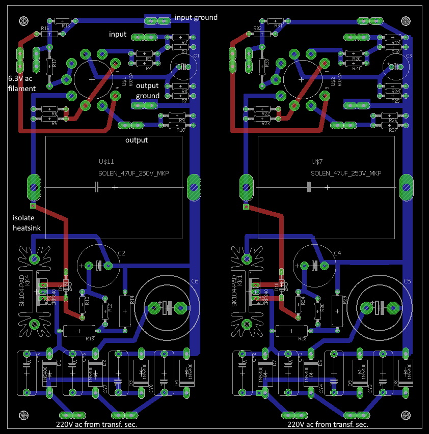

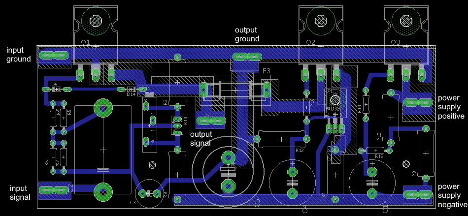

Here the measurements and the files to produce the pcb.

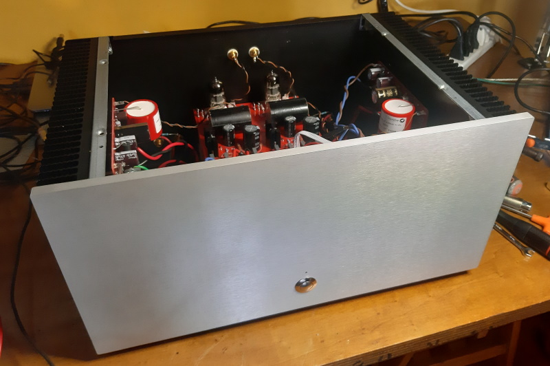

Here the photo of the final product.

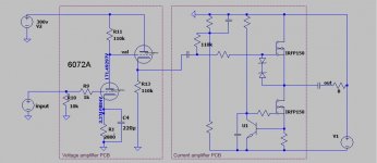

Help me to think about other voltage amplifier stage, the target should be a Rout < 500ohm, an amplification factor of about 30dB and the current is not a problem because the load is only 110Kohm.

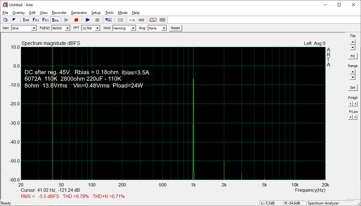

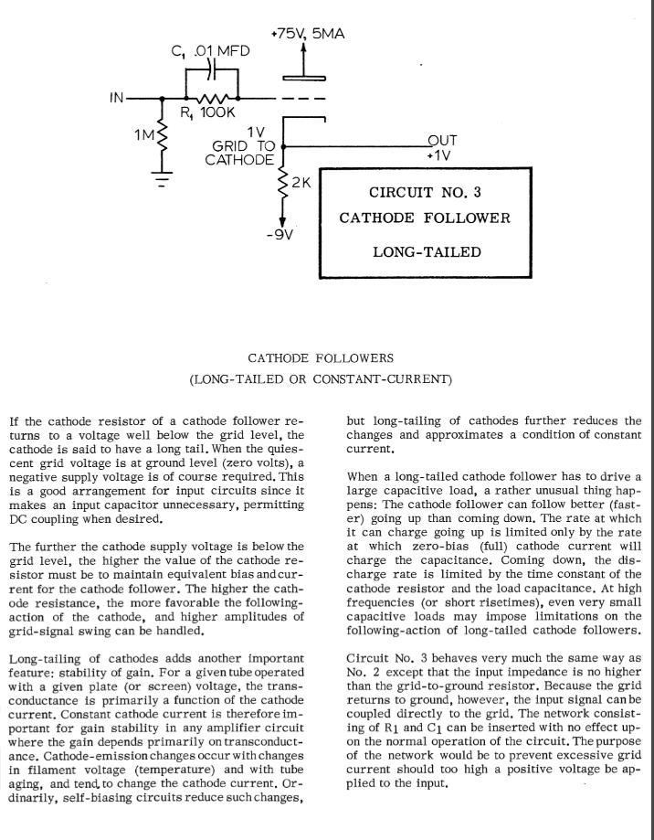

Nice. I too have the Vas issue. My front end follower is using a CRD in the negative supply. Attached pic from Tektronix Tube Circuits.(Cathode resistor replaced with current reg diode)
With +-15vdc supply have 6vrms input compliance.
6Sn7 , very low distortion and no high order harmonics. H2 is dominant with 3rd close to floor. DC coupled input.
What software are you using?

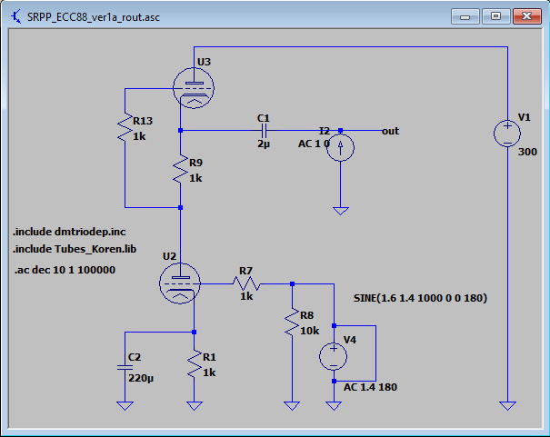

One option is the SRPP (Shunt Regulated Push-Pull) tube amplifier with ECC88/6922 like used in the old Bartolomeo Aloia pre-ampl.
Rout about 500ohm
Av about 31dB
These are perfect parameters to be integrated with the Power Follower current amplifier stage.
Many years ago I tested the SRPP and the sound was not liked because it seemed very cold compared to a normal common cathode triode amplifier but it could be interesting to make new tests on this configuration.

Since you're overtly promoting your design, I feel it important to note a few things.
GREY design:
[1] R10 is rather low for an all-purpose amplifier. I prefer 22 kΩ to 47 kΩ, standard value.
[2] C4 is ridiculously oversized. Using formula
C = 159,000 / RF​
where
R = 2800 Ω
F = 10 Hz​
we get
C = 159,000 / ( 2800 × 10 )
C = 5.7 µF​
See? I fully understand “plussing up” to the next, or next-next nearest common value, since in this position, precision of the capacitor isn't desired. So, 6.8 µF or 10 µF, would be perfect. Choosing 200+ µF just enhances this amplifier's ability to reproduce wow-and-flutter-and-rumble. Not desired.
[3] R13 being equal to R11 is nigh-short of useless. Do try harder! 22 kΩ, 5 W is a much better choice. Much sturdier driving capability. Still only 7.8 mA nominal.
The right side of the design has no values, so… moving to:
WHITE design:
[4] R10, 11 being dual-ganged is mind-bogglingly pointless: the one thing you do not need when creating a resistor-tapped voltage divider that will be supplying nearly no current to the amplifying MOSFETs is to have it drawing large amounts of current. Seriously! That's what C3 is for!
… the better values would have been R9 = 22 kΩ, R3 = 12 kΩ, and R11 = 5 kΩ. Multiturn or not, hardly matters.
[5] No reason to double up R6, 7. Not for power dissipation, not for noise reduction, not for anything I can think of.
[6] No reason to double up R4, 5, either. Same reasons.
[7] There's no value for RBIAS. Except for it being a 5 watt resistor. Which does not seem unreasonable!
[8] Not sure what the 1.0 kΩ, 2 W resistor is for across the output. Safety?
[9] The same critique № 4 applies to R8, 13. They do NOT need to be anywhere near as low-value as stated on the circuit diagram. Just wasting power, to no benefit.
[10] C5 is significantly undersized. Since you have a power supply around 40 V, and you're planning on delivering quite a few amps in peak output, the optimum value is around 22,000 µF.
NET… i'm sure the amplifier sounds just fine. Great even. But it has power-wasting design overkill which doesn't accomplish anything in the end. Maybe it is a personal ideal, but I really prefer “right sizing” components from a position of mathematical justification. I've never — ever — had a mathematically 'sound design' amp fall short of the design due to an unforseen problem that 'over-design' would have invisibly cured.

Sorry these are the final components used for the driver stage
R1,R2,R18,R19, 220Kohm 1/2W 1% Mouser 594-MBB02070C2203FCT
R5,R6,R22,R23
R9,R10,R26,R27
R3,R4,R20,R21, 1000ohm 1/4W 1% Mouser 594-MBB02070C1001FC1
R11,R34
R7,R8,R24,R25 5600ohm 1/4W 1% <<< 5600ohm for 6072 and 4000ohm for the 12AX7
R15,R16,R31,E32 220ohm 1/4W 1%
R17,R33 3.3ohm 2W Mouser 660-MOSX2CT52R3R3J
R12,R30 100Kohm 1/4W 1% Mouser 594-MBB02070C1003FCT
R14,R29 150Kohm 3W
R13,R28 18Kohm 2W
C1.C3 220uF 6.3V OS-CON Mouser 667-6SEPC220M+TSS <<< not use for 12AX7
C2,C4 33uF 400V Mouser 647-UVY2G330MHD
C5,C6 100uF 400V Mouser 647-LGU2G101MELZ
CY1-CY8 10nF 440VAC RS 335-066 o 80-R474I210050A1K
U$3,U$6 IRF840 Mouser 844-IRF840APBF
U$11,U$7 33uF 400V Solen MKP
D1,D2,D3,D4,D6,D7,D8,D9 UF5406 Mouser 625-UF5408-E3
D5,D10 zener 10V 1W
KK1,KK4 Extruded Style Heatsink for TO-220 Mouser: 532-513102B25
Isolator Bergquist SP400-0.007-00-54 RS 169-2177
Isolatos TO-220 nylon platstic Insulator hole size M3
The connections are 63862-1 (CUT STRIP) by TE Connectivity / AMP (cod. Mouser 571-63862-1-CT, cod. RS 718-7987)
Using the 6082 in order to keep the Vkf under the max value it is necessary made a modification adding 4 resistors 2 x 56K 1W and 2 x 150K 2W and cut the filament ground wire on pcb.

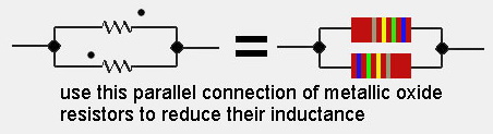

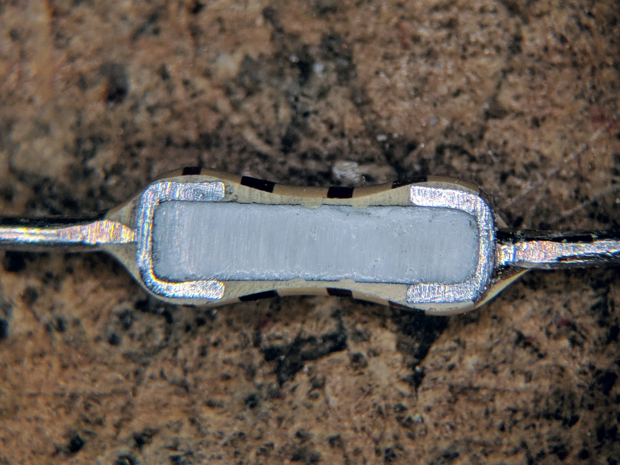

All the resistors on the signal path are created with a parallel of two resistors in opposite phase and obviously with the double value.
This allow to use normal 1% resistors and get a sonic result near to the MK132 Caddock considered my reference.
