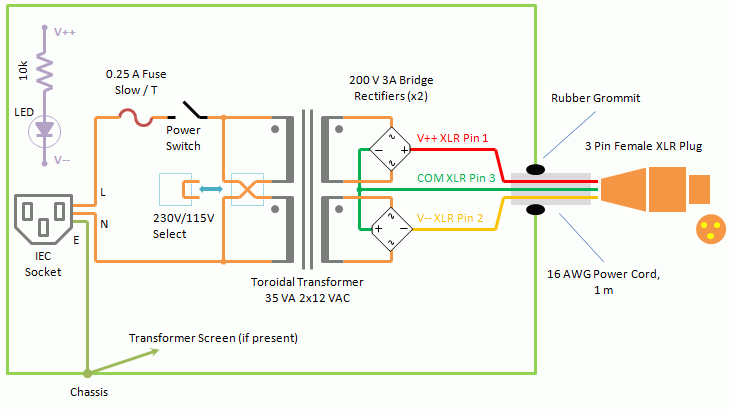

VSPS300 Power Supply Info
I am just beginning my setup stage for the VSPS300 Phonostage and have noted that the power supply info states that the power supply should be separate (which makes much sense.) I am wondering though which board is used from RJM Audio? There is no offering for a separate power supply PCB that I have been able to find. I searched on "VSPS power supply" but got no results. Help would be appreciated. I am thinking it is the same board but am not sure. Newbie to phonostage here...
From the construction guide, which is supposed to gives the details of the "non-board" sections of the Phonoclone and VSPS.
I didn't actually state that there is no power supply board. Sorry, that could be made clearer. I've flagged that section for review.

Thank you Richard. Now all i have to do is decide how much i want to spend on a transformer. I think though that I will go with the basic recommended unit that is mentioned in the construction guide. If i went with a Plitron, is there a recommended unit from that manufacturer? There are so many choices, I could use help with a specific model number if i decide to spend the extra money.
Thanks for any help,
Jerry
Jerry
You just need something with two 12 VAC secondaries. The size is not critical, 25-180 VA.
There are the low profile PC mount 700XX series from AMVECO if you want to put everything on a circuit board. AMVECO (formerly Talema) also has the miniature low profile 620XX series which have a potted core for convenient bolt-through mounting. These are sold at Digikey. I often use the 62062. Much the same thing is available from Mouser as the Triad VPT24-1040, without the potted core. I've given 25VA examples, but you could go with 35VA or 50VA.
If you want something bigger, Hammond comes to mind, and of course Plitron. Plitron is great if you live in Canada. The pricing is such that buying anything smaller than 160VA makes no sense, so consider the 160 VA model 057012201.
The Plitron transformers you really want are the custom units with the electrostatic screen and magnetic shield. Unfortunately they don't sell them in anything less than 5 unit batches, last I checked - it was some years ago now.

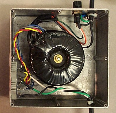

talema
Dumb question but can someone please tell me how to hook up a talema 62072 for 120v mains? I tried tying the yellow to red and black to violet on the input side and green/red and brown/blue to the rectifiers. Is this correct? Unless I'm measuring wrong(very possible) I get a much higher dc reading on my multimeter than I should and no sound. I had it hooked up and running a couple years ago and only unhooked the transformer when I put it away.
