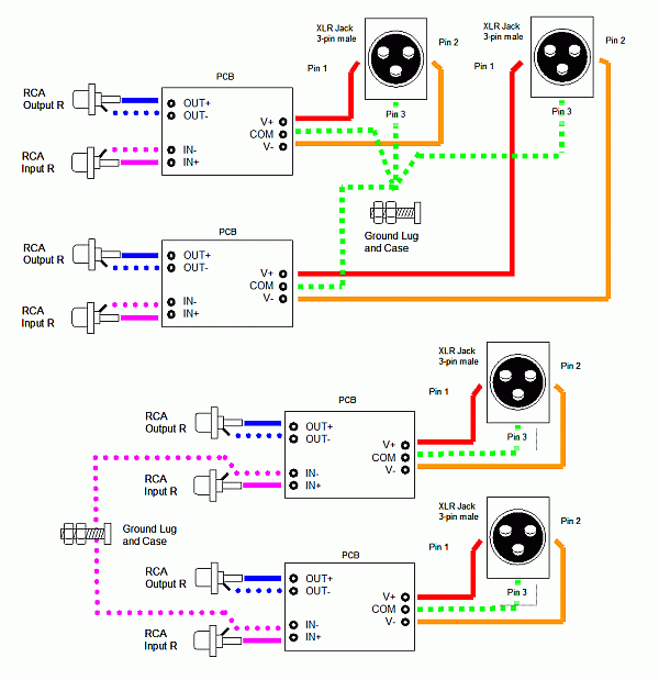

I meant:
only tie the input grounds together, ie ground of left channel connected to ground of right channel.
Just as if you used uninsulated RCA jacks for the inputs on a metal case.

Grounding scheme for dual mono supplies
Ok, I've though it through and done a little experimentation. I found I can get my phonoclone to hum, quite badly, if I disconnect the two TT ground wires (one runs from the arm, the other the motor/base assembly) from the phonoclone TT ground lug, and power on the turntable. With the turntable turned off, there is no hum even with the ground wires disconnected. I dont get any additional hum when the turntable motor is spinning compared to when it is stopped. Reconnecting the turtanble motor ground wire cures the problem completely. Recommening just the arm ground wire gets rid of 70% of the hum.
My turntable is direct drive, so all the above means is the hum is coming from the power transformer located underneath the platter. Properly shielding the offending source by grounding the surrounding metal case to the phonoclone chassis solves the problem.
When the ground wires are disconnected, the whole system is much more sentive to RFI and weirdness (I can kill the hum when I touch the case, for example, and clicking noises induced by the WiFi router sitting nearby is greatly enhanced.)
Conclusion: the arm and turntable should be fully shielded and grounded to the phonoclone case via the TT ground lug. It could well be that the phonoclone circuit is more susceptible to this interferance that other designs, due to the inverting, zero impedance input. I suspect this is so, but I cant quite grasp the whole situation well enough to explain it at this point. Those of you with DIY tables and arms seem to be having problems, while those of you with commercial decks seem to be OK ... limited statistics, but this is the trend so far. Commercial units tend to be properly shielded ... DIY units not always so well.
Lastly, there is only one way to properly connect the grounds when a single transformer is used. Its the way shown on the web page. It involves a compromise layout due to the fundamental decision to use one power supply for two separate circuits (ie. shared COM). Most of the time, however, its fine, and anyway there is no alternative. This is the "case-to-COM" scheme.
There are two ways to connect two power supplies. The first is just add a second unit in parallel, according to the standard "case-to-COM" scheme. All COM, both power supply and PCB, run to the case TT lug. If the system runs properly with one shared power supply in this configuration, adding a second will also work properly.
The second is "case-to-IN-" scheme, shown below and described in earlier posts. This is actually the textbook correct, no compromise way to do it, and a direct advantage of the full dual-mono design choice. (it will not work with a shared supply) Fran tried it and found it worked for him, I suggest Tube300 also try it soon. The easiest was to do it is remove the plastic spacer from the back of the RCA jack, but you can run wires from the RCA tab to the chassis TT lug if thats what you prefer.
Why should case-to-IN- be better? In principle connecting to the input return at the input jack should have more immunity from noise pickup, especially at RF. Its worth a try if you are having problems, but please note that its not addressing the real source of the problem, which is an improperly shielded and grounded turntable.

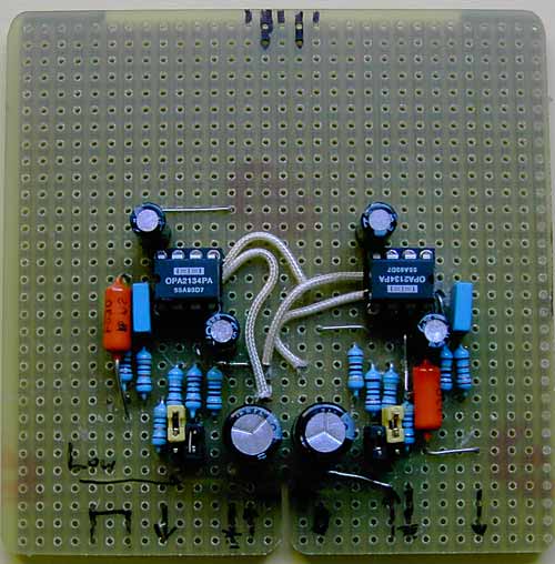

Smallest VSPS?
Hi there,
I've also build a VSPS. As I wanted it to plug in my converted Quad 33 I've build it very small. Just point to point on a piece of strip board. OPA 2134 as op-amps. Capacitors polyester and polypropylene. Gain adjustable by jumpers (to the best Quad tradition).
The sound is actually better than my previous try, a Rod Elliot project 6 (but comparison is not fair, I've used that one with an asymmetric power supply).
For details on the Quad 33 see this thread: http://www.diyaudio.com/forums/showthread.php?s=&threadid=79794
It might be interesting to know that the board is fed by a two stage power supply. First stage regulated to about 24V with LM317/337. Then a second stage to 16V again using LM317/337. On the board you see two caps two have some reservoir near the op-amps.
Greetz, MArco
