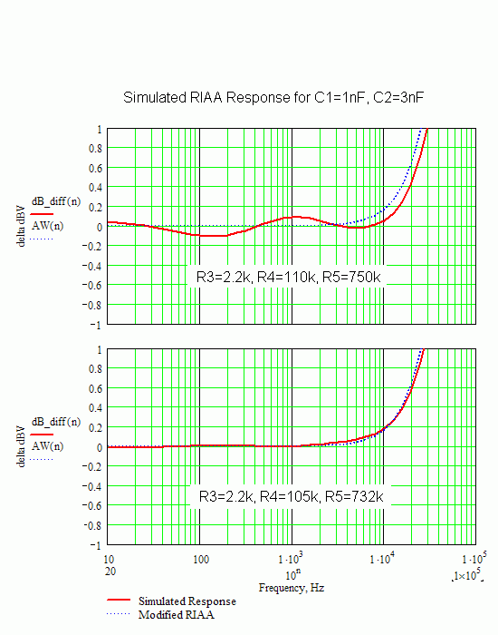

Richard: have you got the new RIAA correction curve with standard resistors?

You mean this? Its also on the VSPS page, btw.
/R
P.S. And before you ask: I know the upper curve looks bad, but it really isnt. (+/- 0.1 dB is bad!? Most of my phonoclones that I have built were worse than this!) You arent going to get anything like the bottom trace anyway unless your capacitors are also matched to under 1%.
/R
getting the 1uF and three parallel 1uF to match to better than 0.5% is easy. Getting both channels to match is nearly as easy. Getting absolute accuracy is nearly impossible due to inaccuracies in our measuring standards.
If all the caps are matched perfectly but sit 1% low or all sit 1% high, what do these two response curves look like?
Can you eliminate the 0.6db rise @ 20kHz?
How high does that peak go and at what frequency does it level off?

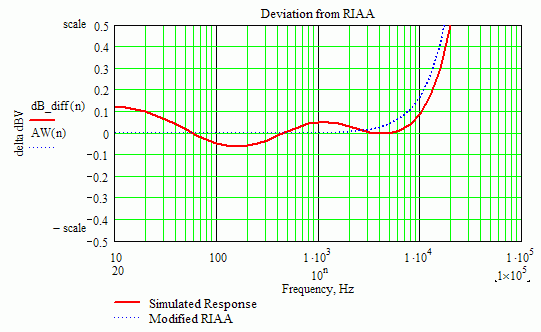

1% will be trivial deviation. 3% willl be about 0.1 dB, see attached for 732k, 105k, 1.03nF and 3.09nF...
No, not with the non-inverting topology. You can shift it to higher frequencies somewhat though. As explained on the web page, I have set it deliberately to follow the Allen Wright modified RIAA response.
Since the curve is referened to the RIAA response its not a peak, its a levellling off of the RIAA high frequency cut. It continues until the op amp runs out of bandwidth.
