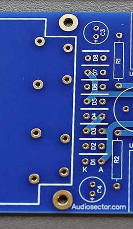

I'm using 2 x 12V transformer, which unloaded produce approx 14V AC per secondary.
In attached pic, you can see 4 pads (on a left). Those pads are for external transformer connection: first two from the top are for one secondary, the other two for the other secondary. You will need approx 19V after rectification and 15V regulated. If you can get 15V because of too low voltage on secondaries, settle for lower regulated voltage, it will not affect anything (adjust with changing R7 and R8)
As both positive and negative regulator circuits are completely independent, the secondaries do not need to be in phase; you can also use two separate transformers with single secondaries.
