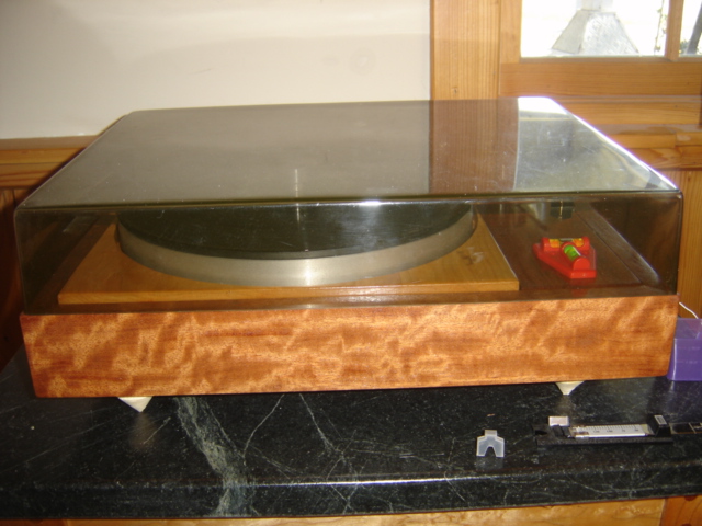

Continuing work I have done the following:
1) Soft wooden feet. It is harder than it looks to turn a good cone of wood, but finally succeeded. The feet made an improvement. and reduced feedback.

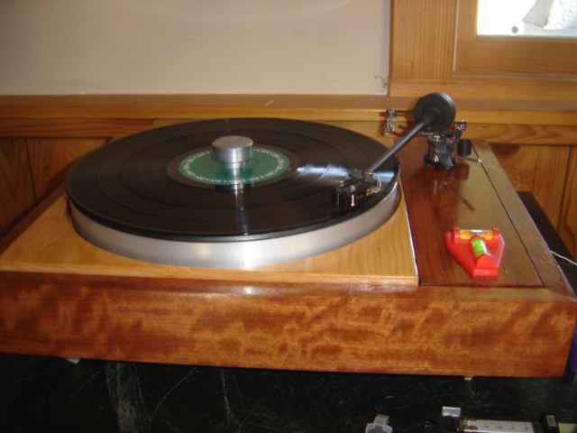

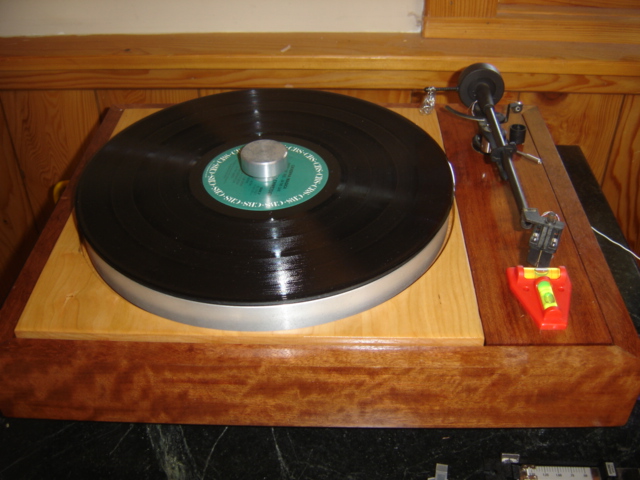

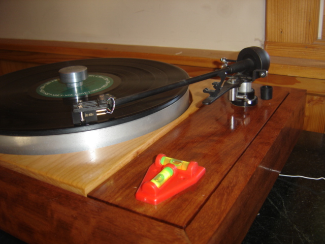

The phenox has had a few changes recently and now is in a place at which I will keep it for a while. The major changes are primarily related to the tonearm board and it being rigidly coupled to the plinth.
I went to the acuna wood for board as I liked the wood and wanted to try a harder more dense material. Acuna is like a light ebony in its characteristics.

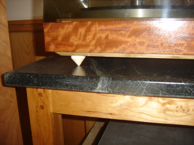

You can see the wooden cones. Made those from a piece of soft maple root I had in the stores. It is soft and doesn't ring at all when rapped on.
There is very little transfer of energy when the table top is knocked on. As expected the plinth has become a little move lively when tapped as the tonearm board is coupled to it.
In general the sound is very lively with good base. The table is very quiet given the parts used.
I may try in the future elastic feet but will make that change after I have listend to it for a while.
