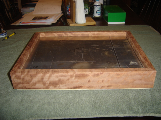

The time has come to redo my butcherd Ariston Audio RD80. In my youth, I had this great idea of improving the original design and ended up messing it up. Recently I did get it to work quite well when I built the Simplistic JFET RIAA. The problem is that the Simplistic RIAA FAR outclasses the table by many orders of magnitude. Hence, my decision to rebuild it.
My goals for the project are:
This is an interim project. I plan to experiment with materials in this build so I can build my Super Table at some point in the future. I want to keep the costs within reason for that reason.
Re-use bearing, platter and AC motor. I have the Magnapan tonearm with its slightly off mounting dimension so I would build it for that arm, but yet have the plinth compact enough to play with arms like the Nanook or Schroeder in 12" versions. Size is also important later when I want to externalize the motor.
I have decided to forego the suspension and go the route of absorbing materials and mass.
An aluminum plate will be sandwiched between instrument grade wood and a cast Silicone / Leadshot composit mass cast underneath. I hope the drawings and picts explain the ideas.
The tonearm board isn't shown but will be made of instrument grade curly maple.
Despite having no suspension, energy dissapation and absorbtion will be important in the design. The plinth, bearing, and toenarm will each have their own masses which are decoupled from each other. The mass for each will be significant enough to sink the energy.
I am very open to ideas, thoughts and experience you may have had building a table. I appreciate all comments both positive and negative in that regard.

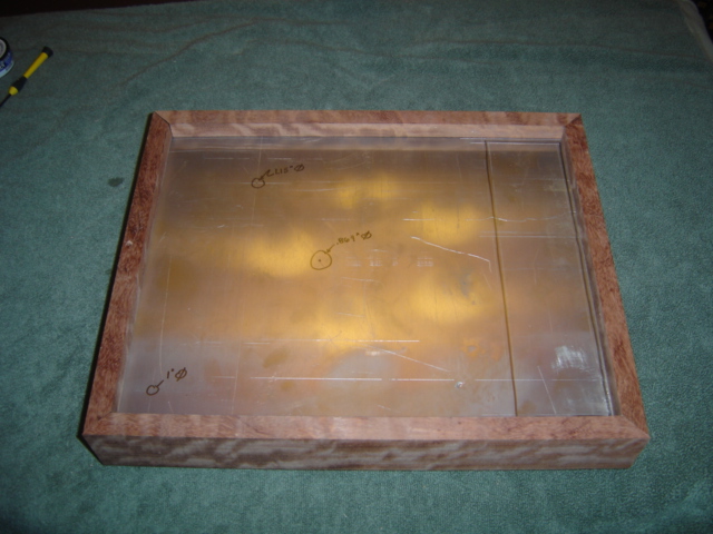

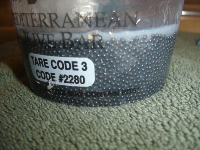

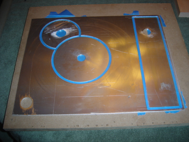

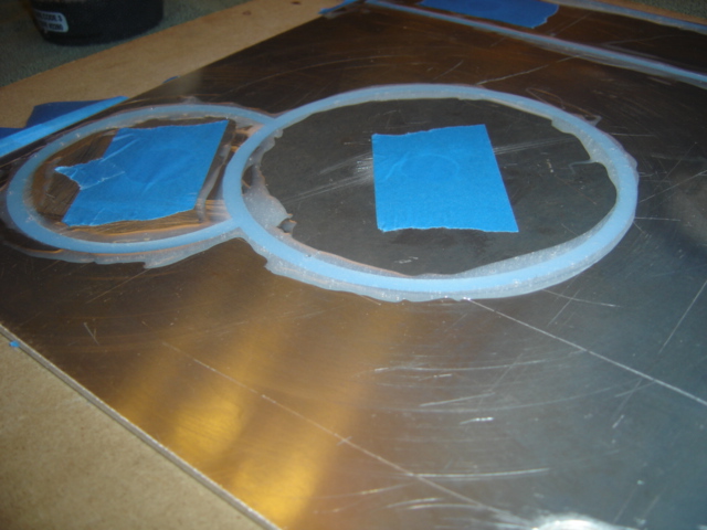

Ok, here is the aluminum sheet for the top plate, now routed out. You can see how the bearing plate, motor mount and tonearm board will be decoupled from each other. The second photo shows the gaps being filled with silicone. The final picture is of the silicone mixed with lead shot.
When I am ready, I will make a mold on the bottom side of the plate to pour each of the masses needed in-situ. They will be seperated by a gap which corresponds to the routed passages. The bearing and tonearm masses will have a cavity for sand as was sugested above.

Top Plate
Had an hour or so to play in the shop.

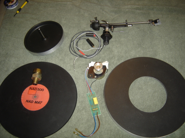

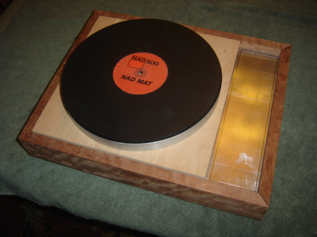

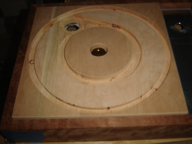

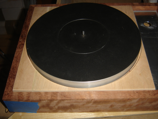

Here is the plinth top plate viewed from underneath. It is routed to create a relief for the bearing plate and motor plate.
The second photo is to top of the top plate which is relieved to accept the motor pulley, inner platter and outer platter.
The inner platter installed
and finally with the outer platter.
The platter sits into the grooves and mantains a 1/8" clearance to the top plate. The wood will be epoxied and screwed to the aluminum plate for strength and rigidity. I can rigidly couple the bearing plate to the wood as well if need be.
Based on suggestions previously, I am now contempating using a "super light and rigid" approach vs. the super mass. The chassis is allready built super rigid. I do want to dampen the bearing, the question is how much weight to cast underneth the bearing plate. The other decision I have to make is what wood to use for the tonearm plate. I cave Leopard Wood, Curly Maple, Wenge, Regular Maple, Cherry, Oak, and I think some Cocobola. I also have a little extra wavy acuna like the chasis is made from. Any thoughts for a starter?
