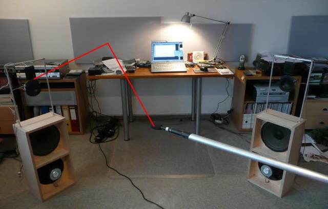

By phase coherence I am referring to phase and magnitude of frequency components of signal being maintained in output. Square wave is convenient example even with band limiting imposed by sampling rate.
The direct sound waveform received at listener position will correlate highly with output of speaker along design axis for smoothly produced wavefront. This is basis for how mind sees rest of room with ears.
Picture is worth a thousand words; frequency response, phase plot, and knowledge of minimum phase all pass at 300Hz and 1200Hz precludes stable square wave across most of operating band.
Attached is zip of swept square wave from about 100Hz to 3kHz captured on design axis of DSP implemented Pluto type speaker over 10 seconds. File is intended to look at with editor in lieu of numerous pics.
Diffraction as off axis frequency/angle dependent radiation leads to splotchy illumination consistent across source material, leading to identifiable sameness imparted to listening experience of system/space.
Similarly, baffle edges, sound reflecting off magnets and baskets, along with insides of cabinets that comes back through driver(s) impact resolution of system and identity as projector.
The panning experiments with modified bandwidth and uncluttered sound field reveal classic difficulties in achieving repeatable reference monitoring regarding sound image.
