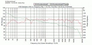

I am not sure you looked at the phase part of the curve, there is no “all pass” crossover phase shift like Butterworth, linkwitz riley and other named slopes produce.
The high pass hf crossover alone for example has a 4th order ultimate slope which normally would put 360 degrees phase rotation centered around 1200Hz which is not present. The phase response is as if it were one driver, not 7 with a 3 way passive crossover.
Here is an old link to some square waves if curious;
http://www.diyaudio.com/forums/multi-way/71824-making-square-waves.html
Yes, I looked at phase, and time reference and windowing play into display; PDF of SH-50 from your site shows full 360 degrees smoothly over bandwidth:
This is quite an accomplishment with passive crossover, and horn version of slanted baffle, that goes further by folding up an WMTMW. Likewise your 250Hz, 1kHz, and 2.5kHz show all classic motifs of phase effects present with 4th order passive filtering; soft shoulders, droop, and significant overshoot; but fairly clearly produced from square wave source.

The SH-50 (Synergy horns) are unusual in that they can be very largely phase correct without DSP and by radiating a segment of a sphere over a wide band act / measure /sound like as if it had one crossover-less driver and so it presents a very uniform spectrum across the listening area.
Phase plot has relatively smooth slope, thus fewer large inflection points, really approaching limits of physical design with analog processing.
