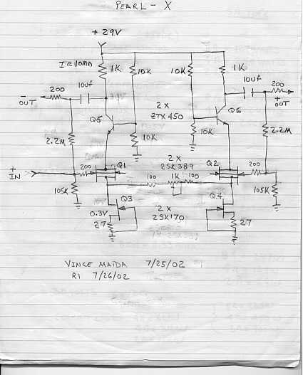

I started building the Pearl phono stage and decided to go with a balanced output stage. Because of all the information that now exists on the forum for the X topology I thought I might try one in this application. My goal was to improve the perfomance of the pearl output stage but still stay close to the original design and keep it as simple as possible. The resistor values for the cross-coupling are a guess taken from the P1.7 preamp. All of Nelsons comments regarding unbalanced operation of the X topology I hopefully have implemented correctly! As far as the feedback is concerned I have no clue at this point. It may not have enough excess gain to give any away in my particular application. I left the source resistor out so the J-FETs run at IDss, about 10-12ma.
I hope Nelson and the rest of you will please comment on the attached schematic. This is my first attempt at audio design in recent history so try not to be too tough on me.

I would drop the 3.9K's to ground for this
application, which is single-ended input.
Probably you will end up with the pot at 0 ohms,
but that's OK.
Oh yeah, and add some output series resistance for
HF stability, 100 to 220 ohms.

5K and 10K votage divider should be changed to 15K and 10K.
500 ohms too small for collector resistor, Very low open loop gain.
What is the closed loop gain that you want? Do not design until you know.
DO NOT RUN JFETS AT Idss. 3 to 5 mA in each Jfet is probaly enough if this circuit is to drive >= 50K loads.
SK170s should be biased less than Idss each half of SK389.
Gate resistors on SK389.
You need a negative voltage supply also.

Nelson and Harry thanks for the help. I'll be driving a 22K balanced load (P1.7 Input) with the phono section in the same box. I'd like to obtain a gain of about 24dB-30dB out of this circuit.
As far as power supplies go I'd like to stick with a single supply to make this mod as painless as possible since the basis is the Pass labs Pearl PCB.
As soon as I get further along I will post an updated schematic.

This version incorporates Nelson's and Harry's comments implemented correctly I Hope! The changes are:
1. Deleted 3.9k's dangling to ground(Nelson is this correct)
2. Added 200 ohms at the outputs and gates of diiff pair (HF
stability)
3. Rebiased to less than Idss (10ma) and added another dual J-
FET to the Diff pair (more gain)
4. Increased collector resistor on cascodes(more gain)
5. Added feedback, gain is about 21X I think, which is enough for the second stage since my High output MC puts out about 3mv.
Thanks again and any additional comments are greatly appreciated.
Vince

I think the following might be helpful.
http://www.borbelyaudio.com/ae599bor.pdf
http://www.schuro.de/Daten/Japanhalbleiter/2SK170.pdf
http://www.schuro.de/Daten/Japanhalbleiter/2SK389.pdf
The circuit needs a negative supply for DC coupled inputs.
The open loop gain is much lower than you think.
Design for Green bias group is recommend since those are easiest
to buy.
Use matched diff pair for both halfs of circuit (one SK389 for both output phases or you lose any advatage in using a matched pair device and might as well use 2SK170s for all fets.)

My suggestion is somewhat different
I am completing design of a 2 stage DC coupled balanced Pearl. No X, though -- probably not worth it in this application if you ask me.
I use 16 n-channel JFET's for the input in a long tailed pair (pair of 8) driven by a current source. Degeneration on each source. I also use cascoding to shield the devices from Miller effect. Very similar to a doubled up stock Pearl input if you know what I mean.
The second stage is identical except it is p-channel, and by careful choice of components and voltages brings the signal DC back to where it came from -- let us call that zero ... This stage is also very similar to a stock Pearl stage 2.
I am gunning for 70-80dB gain at 1KHz after passive EQ. I am also re-evaluating whether I want to use passive RIAA, combined RIAA or active RIAA. I had originally planned to do the RIAA across phases instead of to ground. I still hold this as the main gain plan, but I need to figure out a way to cut gain at DC, and I was really gunning for no coupling caps. Hmmmm. I could do a combined or active RIAA and cross between left input and right output (and vice versa) in order to get the required negative gain, or do the gain stuff across each gain stage which should be quite possible. At this juncture though phase to phase with some LF rolloff generated somehow looks like the winner.
