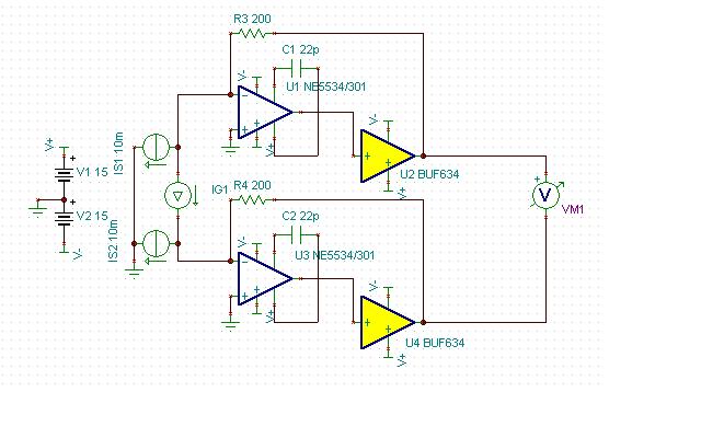

This is what I suggest. Block the DC at the input and balance the input and feedback resistors so that the DC offset at the output will be 16uV, which is insignificant. Noise is still good with S/N near 140dB. AC response is flat from 1Hz to infinity apparently. It's just a flat line. THD is extremely low. After looking at the schematic for the NE5534, I realized that I'd played around with discrete opamps before, and so I realized that it's incorrect to just tie one of the input bases to ground. There needs to be a resistor there that is equal to the feedback resistor. Also, I have realized that a blocking capacitor is necessary for good DC balance in the circuit. I have further realized that when the DC balanced is achieved, then the opamp performs better. So, this is what I came up with now.
Actually, this may not work with the DAC because it appears to want a DC path to ground. I'm not sure of that now. Why would the DAC need a DC path to ground? I know I read about it in some application notes, but I don't see why this would not work. We're only interested in the AC signal after all.

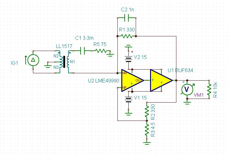

In the original schematic, there was just a capacitor between the transformer + and ground. I found I needed a huge capacitor to get good response with low feedback resistors and there was still a nasty peak. I reduced the capacitor and added the resistor to dampen the response, which is now nice and smooth down to about 1Hz. The bad news is that the 75 ohm resistor adds to the input impedance as seen by the current generator. I think it's about 50 ohms or so. Still, this DAC seems to be OK with higher than zero load impedances.
The circuit is just a variation of the single opamp balanced to unbalanced converter, where the first resistor on the - pin is replaced by the transformer secondary winding. I don't know why the capacitor is required. So, R3 has to be set to the DC resistance of the transformer secondary and R1 and R2 have to be equal.

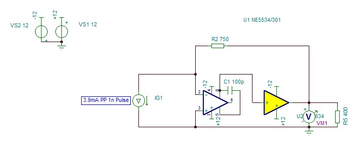

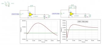

The NE5534 is often cursed as the "bad" Op Amp. However I would like to show you some some simulations in Tina, How the NE5534 actually deals better with glitches and fast pulses then more expensive types.
You can try two approaches. 1, To avoid/filter out the fast rising glitches of the DAC completely. Or 2, Let the I-V converter follow those steps as accurate as possible. (Or of course a combination of both)
See the simulations below. The current generator is set on a 1nS, 3,9mA PP Pulse.
IV TEST1: Shows the NE5534 with 100p miller compensation. As you can see it follows the pulse very accurate.

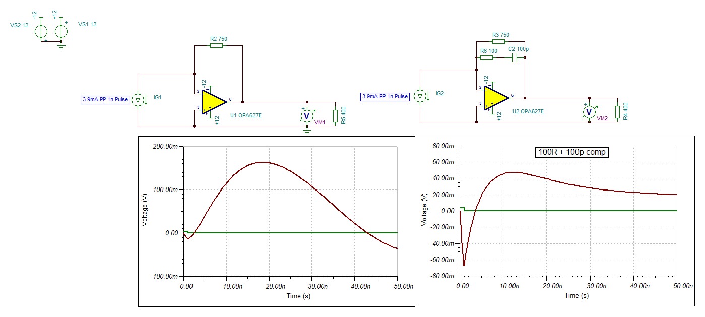

IV TEST2: Shows the OPA627 with feedback compensation and without. With compensation we can filter out the glitch to round 50mV at it's peak.

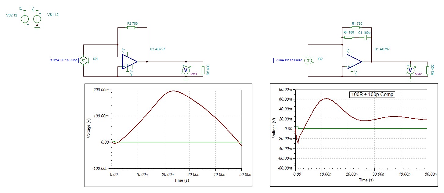

IV TEST3: Shows the AD797 with feedback compensation and without. With compensation we can filter out the glitch to round 60mV at it's peak.
Pick your poison....
Of course this are just simulations with many variables and errors possible. But based on that alone I would prefer the NE5534 as I-V convertor. TI isn't so silly after all for explicit choosing this Op Amp for IV duties in their high-end DAC.
Secondly, unlike most Op Amps, the NE5534 is designed to drive impedances as low as 600 Ohms. So even without buffer, it would be able to deal better with the low impedance input from the following lowpass filter/instrumentation amplifier. I think this is another reason why TI picked to NE5534 on this occasion.
One question for those who work with Tina. Why is it that when I set the current source value on e.g. 7.8mA PP that I don't get a differential 7.8ma PP? I should get 3.9mA PP in opposite phase on each leg of the current source.... But I don't. I get 7.8mA PP on each leg.
With kind regards,
Bas

Hi Bas,
What model are you using? Macromodel or transistor level or something in between? Your plot for the 5534 simulation shows a 200mV step in well under 1nS - that's a slew rate of >1V/5nS or better than 200V/uS. How can this come out of an overcompensated 5534 which only gets 13V/uS with no comp cap?😕😕
Curious how TI's application doesn't look much like your schematic - from what I recall they have something like 2n2 across the feedback resistor, no 100pF comp cap.
Hi Abraxalito,
Good to hear from you! I hope everything is okay your side. My sincere apologies our contact got cut off. I have bin sick for a long time. However I am active again as you can see 😉
This is the Macro model I used in Tina. Me too think it is an error in the model. However Consistently I get amazing results with the NE5534 in simulations.

Hi Bas,
I think there's something wrong with the spice model of the NE5534 in Tina because the first circuit doesn't perform very well at all whereas the second one is outstanding. I see from the schematic of the actual chip that it does make sense to take the output from pin 5, but the spice model appears to be different.
Dear dirkwright,
There is an error in the spice model of the NE5534. Pin 5 out is pin 8 in the spice model. Then it works 😉
So with other words, if you connect pin 8 to the buffer (instead of the actual output) then it works.
