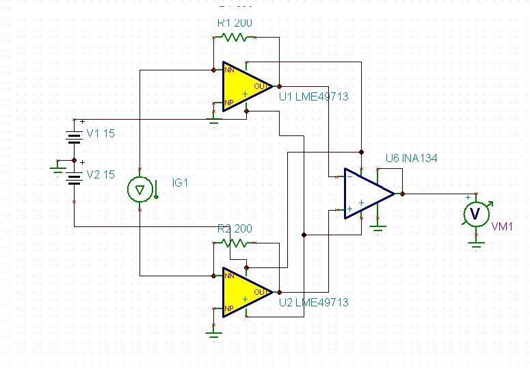

Yes, but we need current feedback because this is an IV converter and the DAC output is a current. At least, this is my latest idea.
We just need to pick a good instrumentation opamp now.
The INA114 looks like a good choice for an instrumentation amplifier:
http://www.ti.com/lit/ds/symlink/ina114.pdf
Though I have not modeled it yet. I think the noise is a little high.
INA129?
Or just make your own with three good op-amps? That would only be 10 op-amps total for the output stage... lol.

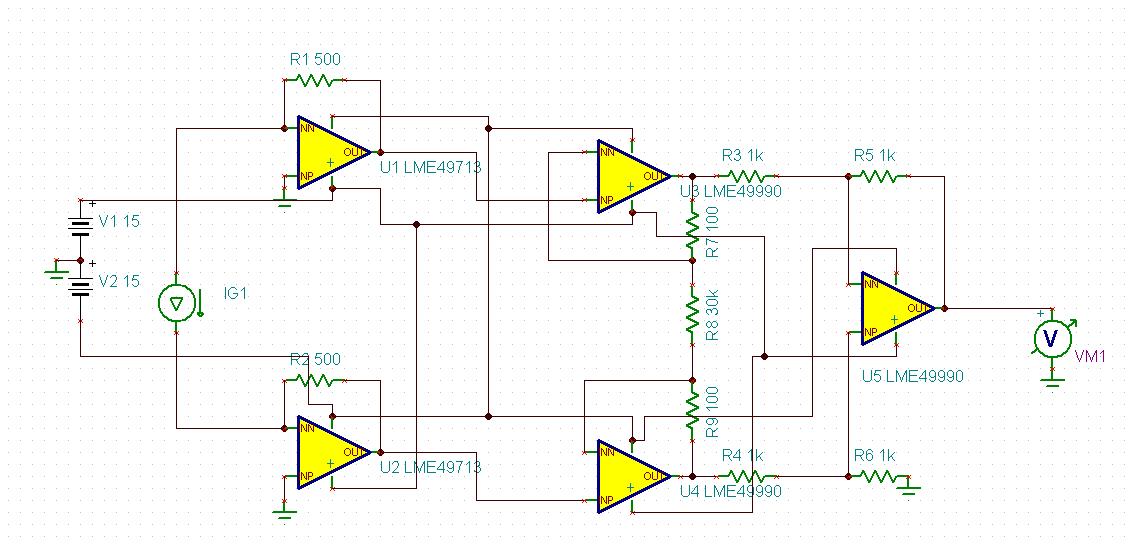

That one has lower noise @ 8~10 nV/Hz1/2.
We may have to use 3 opamps for our own instrumentation amplifier to get lower noise. If so, then the previously mentioned LME49990 (x3) would be a good choice. I'm not afraid of SOIC devices. I can start modeling in Tina when I have time. Anyone else want to start modeling also?

Ken, what do you think of this idea of replacing the NE5534's in the TI schematic with a CFB opamp like the LME49713? Also, what about the idea of replacing the output opamp with an instrumentation opamp (or 3 of some other opamp)? This is what makes sense to me, but I don't have enough experience to know for sure. I have not had time to model this in Tina SPICE.
Dirk, I must admit that I stopped experimenting with IC op-amp based I/V circuits quite some time ago. I achieved by far the best sound quality via a simple passive (resistor) I/V which is subsequently A.C. coupled directly (without any intervening active circuit) to my discrete FET based linestage for voltage amplification. Although, the linestage itself is functionally a discrete op-amp. The transparency of this configuration far surpassed the current-feedback IC op-amp based I/V converter I was using until then. My FET linestage has plenty of gain for this application (the fullscale signal from the DAC is about 0.4VRMS), so an active I/V stage located on board the DAC would be one active stage too many. So, I couldn't honestly offer you an opinion on the latest current-feedback IC op-amp based I/V implementations.
OK, thank you. This is my experiment so far. I don't have the resistor values right yet, but it's looking promising in the sim. THD and S/N are good.
Here it is with a line receiver instead of an instrumentation opamp. Performance is not as good, but the circuit is far more simple. The input impedance at the NN pins is extremely low, far lower than anything I've seen before, like 0.001 ohm.
OK, wait a minute, that line receiver is nothing special. Duh. Let me redo this one.
