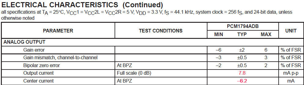

no one read the data sheet - the very 1st post basic premise is wrong

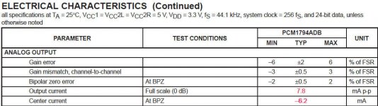

the 1794 has a -6.2 mA DC bias on both outputs - biasing the I/V op amp outputs into Class A

The DAC output swings 7.8 mA Pk-Pk, therefore the DAC output swings from -2.3mA to -10.1mA, i.e, the swing never crosses zero. The I/V opamp has its non-inverting input grounded. Since the current driving the inverting input never crosses zero, the opamp output never crosses zero. It never drives less than 2.3mA through Rf to maintain the voltage at the inverting input the same as the voltage at the grounded non-inverting input. Therefore it is always biassed into class A.
The fact that R4 on the output of U2 is grounded via R6 simply means that U2 is driven further into class A because it has to supply current through these 2 in addition to maintaining the net current at its inverting input at zero via its own Rf. A slightly more complicated situation pertains in regard to R3 and R5.

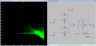

Ok i admit, i´m only human... and i make mistakes, lots of them.😡
But i try to be polite.
I have take a look to the simulation again,
U2 are working in class a for shure swings between 19ma and 4.33ma
U1 is swing between 22ma and 1ma
U3 swings to -12ma to +1ma and this make it work in class b not in class a.
At 5ma pk to pk all of them work in class A.
I will try to change some resistor values to see if i can make this better.

Something is wrong with your sim if U1 swings to 1mA. This would mean U3 is sourcing 1.3mA of current thru R5, R3 and Rf of U1 to keep pin 2 of U1 at ground potential, and you said U3 swings -12mA to +1mA. Since you quote 4.33mA for U2, I presume +1mA is not an approximation.

The problem is that the current imbalance caused by the voltage divider r5 r6 is not enough to put u3 in class A.
To do that you have to double r4 r5. Vout will be half 1 Vrms. And the noise increase
The resistance numbers are from the pict from post#1.
Please take a better look to the circuit. And remember that people sometimes do mistakes and that don't make them fools but only humans. Peace 😎

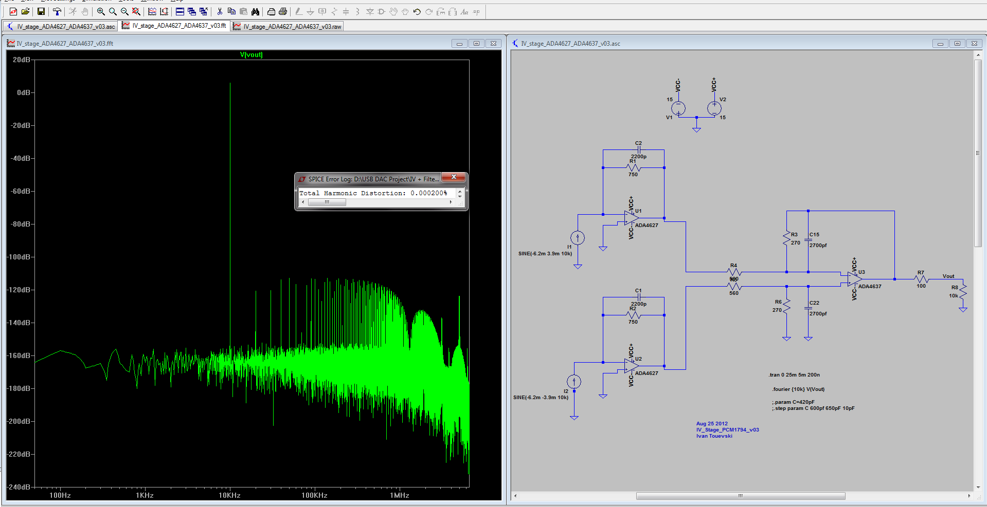

So, I have two designs for an IV converter. One has an input impedance of 3.5 ohms and THD (@1kHz) of 0.00057%. The other has an input impedance of 15 ohms and THD of 0.000058%. For both simulations, I use a current source set to 8mA in parallel with a 2kohm resistor to simulate the output impedance of the PCM1794a. Given that this DAC is designed to work into a virtual ground, would it be better to choose the one with lower input impedance in spite of the 10x higher distortion, or should I go with the one with the lower THD anyway? The noise for both is basically the same. Both have frequency response down to 1Hz at least. I should add that the one with the 3.5 ohm input impedance is made from discrete parts, so that in real life it's likely to be worse (possibly much worse) than in simulation, whereas the one with the 15 ohm input impedance is made from chips that are more likely to be closer to the sim in real life.
dirk
would you be able to post the schematics and FFT graphs?
I have been working on improving the pcm1794a by replacing the OpAmps on it. I had a thread going, looking at different op-amp combinations at the IV and gain stage of the pcm1794. My problem was that I was a noob in my LT simulation and you guys in this thread (and also another thread that is going on right now) have helped me run a proper sim.
I got some really decent results using the ADA4627 at the IV and ADA4637 and from the top of my head i think the FFT at 10kHz showed a 0.000015% THD.... I will post a screen of it later when I get home.
Anyways the ADA4627/37 combo was an improvement over the datasheet IV and gain stage.
Also I have been considering a current feedback op-amp athe IV stage but I need to know the output impedance of the PCM1794a. I have read conflicting opinions weather or not you need to know the output impedance of the DAC. Some posts have difinatively said that you are doing it wrong if you are looking at the output impedance of the PCM1794a.
How did you arrive at 2kOhm output impedance and 8ma current sourse simulation of the PCM1794 dac?
Well, my ideas are a little radical so I'm a bit shy about posting. I've posted them elsewhere before so they are nothing really new. My solution looks nothing like the TI schematic. I use an input transformer, for example.
Some folks think that lowest distortion is not the holy grail of good sound, but I don't know myself. Your results are really good though. Everyone does what makes sense to them. In my limited knowledge, I've come up with what makes sense to me, but it boils down to two different schematics.
Well, the data sheet shows max of 7.8mA output for the DAC, so I rounded up to 8. Someone else in another discussion suggested that the real output impedance of the DAC is around 2k ohms (in parallel with a small capacitor also), so that's where I got that. Current sources are usually high impedance, but this is the digital world, where strange things can happen.

Here are my simulations..... my figures arent as impressive as i thought lol. Well two of the graphs are at 10kHz
