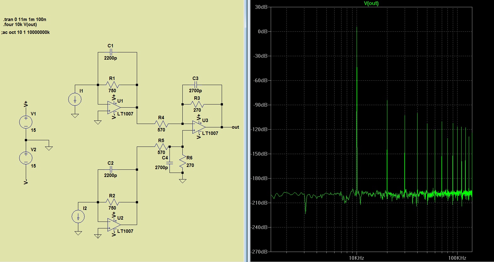

The I/V converter in pcm1794a datasheet is one good example of how you should not use op amp´s, and is because circuits like this that op amp´s have such a bad reputation.
Op amps normally have low quiescent current, and should use large load impedances if one want that they stay in "class a" operation (low distortion).
The circuit in pcm1794a datasheet use very low output impedances in the load of op amp´s and because of that, they work in "class b" (high distortion).
This circuit has 0.003% distortion at 10Khz

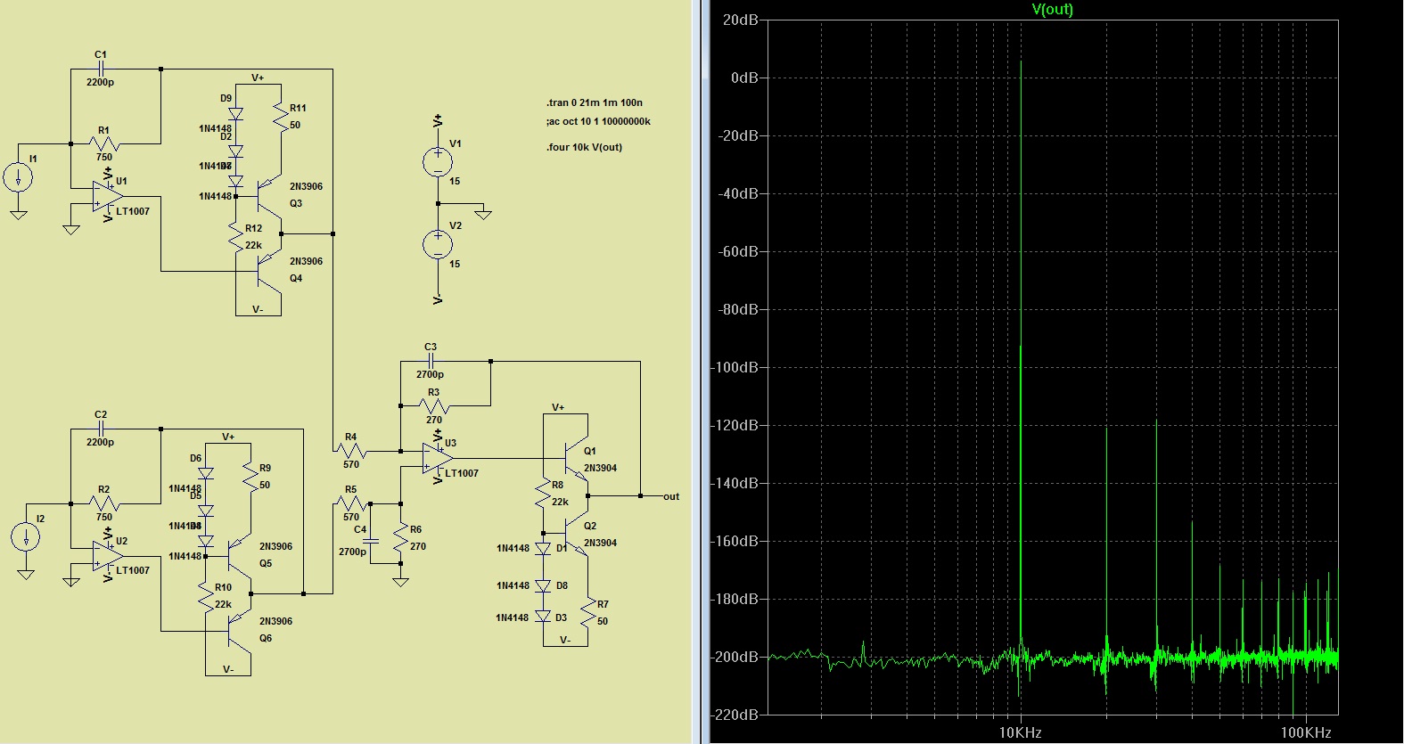

One way to remedy this is using a buffer at each op amp.
below is the same circuit but with the addition of 3 buffers, now each op amp sees a much higher load impedance and the buffers work in class a.
The distortion is much lower. Now we have a distortion of only 0.00007% at 10Khz, consisting only of 2º and 3º harmonics, the distortion is even lower at 1Khz (0.000005%).
This is a big improvement over the original circuit.

I think that with the buffers we can have both low distortion and low noise.
what you guys think? and what is your experience.
I learned something. thanks. Is the noise the stuff @ -200dB in your FFT for this circuit?
I suppose an IC buffer would be OK also?
No Dirk, unfortunately the noise floor will be higher. LTspice don´t simulate noise in transient analysis. You need to run a Noise simulation for that, so just ignore this -200db
the U1 op amp has a 21ma pp swing, so even a ic buffer may enter class b, and is more expensive.

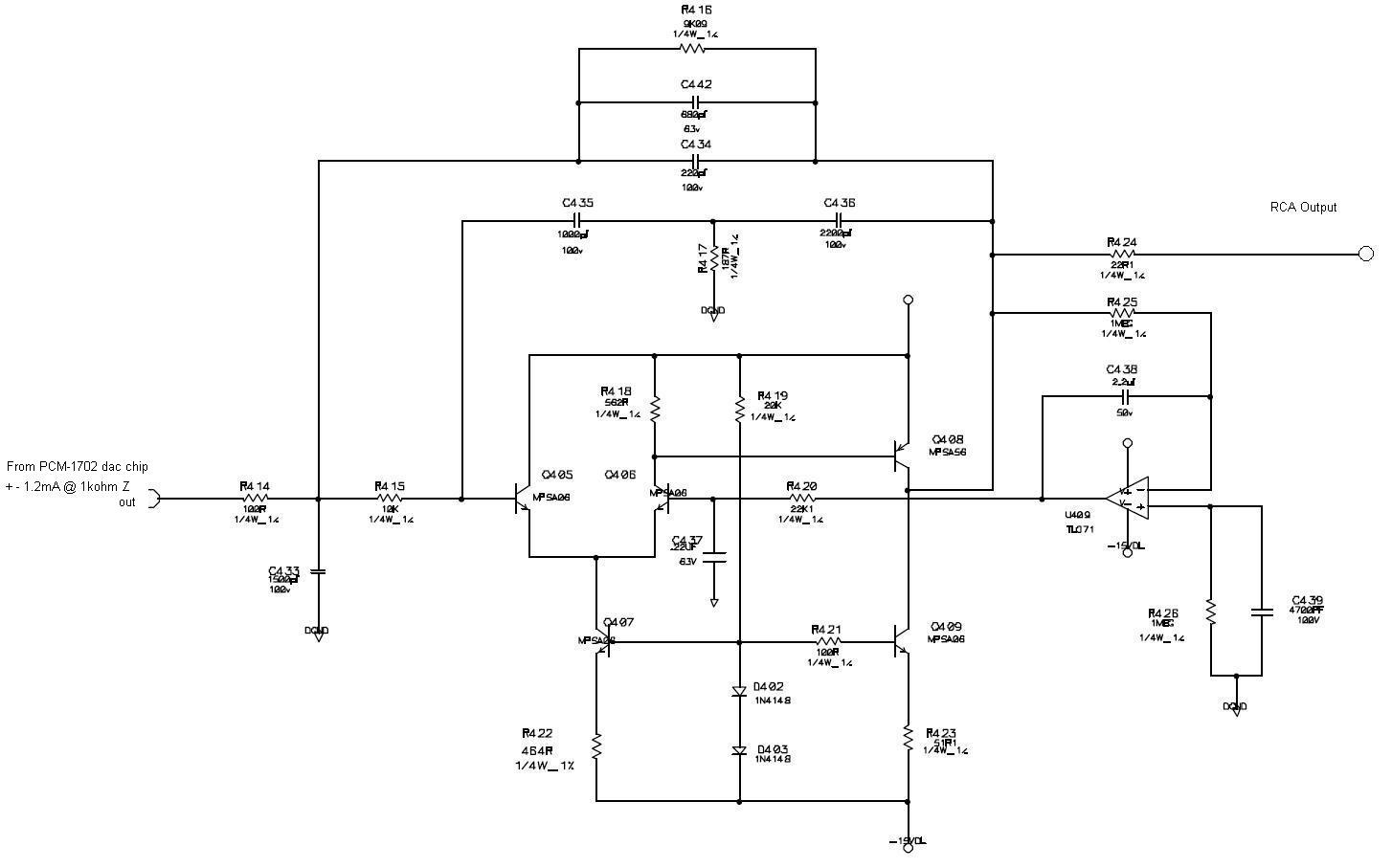

smms73, seeing your so handy at running sim's, could you do me a favour and run the sim on this, circuit.
As so far it has sounded so much better than anything I have ever heard, esspecially in dynamics from top to bottom, but what I have noticed is that it is very unkind to bad recordings, but if the recording is good it is very sweet sounding even with the massive dynamics it has.
