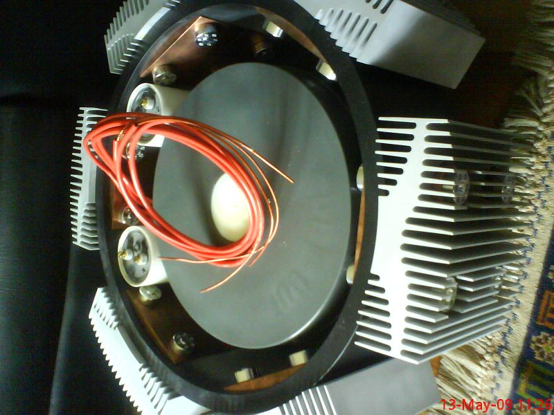

In this case, it already is around a 1000' spool of magnet wire, see pic 😀 It's on the wrong side of 20kg
To be honest, I can't possibly hear the distortion, but I have to admit that I was a little skeptical when I first saw the square being not all that square.
Magura 🙂
