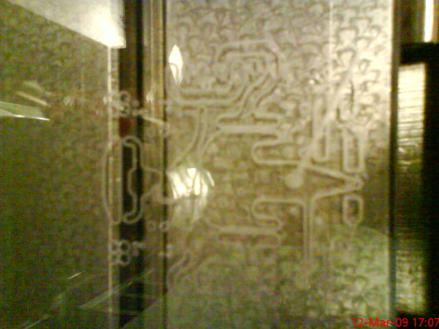

Ok, some test-porn.
Just made it to see if it works, to not waste my PTFE board, and test how the compensation worked.
The real thing is soon to come.

wazzat ?
plexy ?
ya know that I'm blind as Bat ........
or ya are lousy with cam .....

Yes, I used a piece of polycarbonate sheet for the test, to spare the end mills.
1) yes, I know you're blind as a bat
2) Bad lighting, cell phone camera, me operating it, and that's what you get.

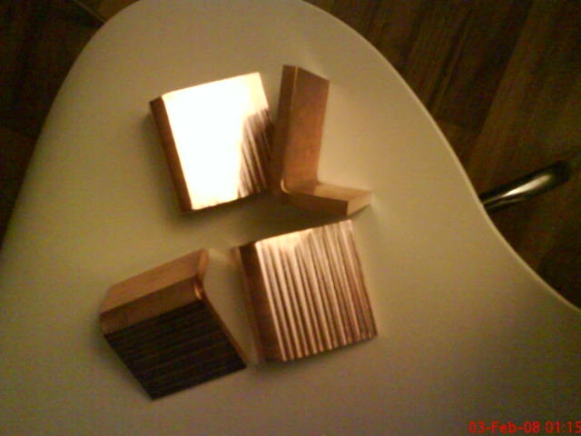

I was thinking for a 6" high heat sink, 4"x4"x0.5" .. too thick? 🙂 combination heat spreader and L bracket.
I've never seen copper L profile either my Danske friend... I'm not sure if one can stick copper plate in a sheetmetal brake either...
Originally posted by Zen Mod wazzat ?
looks like he used the shower door to me...
I have 😀
with a little skill, you can bend it in a sheetmetal brake, that's how I did it.
These are 10mm thick, machined on mounting surfaces.
And?
What do you find most important, a shower door, or a fancy PCB? 😎

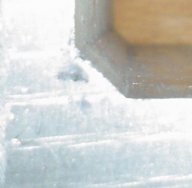

luvdunhill said:if I can cover the entire heat sink, that's good too
Are you sure ?
Suppose you go one step further and wrap the bracket around the entire heatsink surface, what happens to the heatsink's Rth ?
A bracket requires a reasonable flange thickness to prevent it from warping.
It's the cross-sectional area at the 90 degree angle crossing between both flanges that is of importance.
The prettier bracket will look like this =>

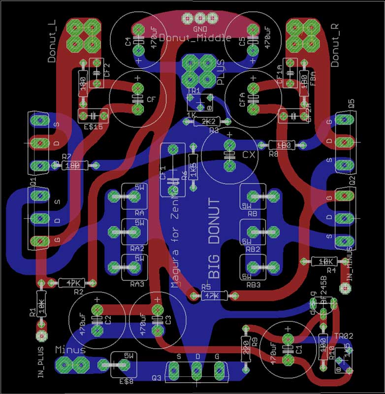

Zen Mod said:
whazzat ?
Still lacking a trim cut on the edges, and mounting holes.....but that's it.

fugly !
CNC-ed
whazzat ?
will it drive F4 ?
Zen Mod said:
fugly !
CNC-ed
whazzat ?
will it drive F4 ?
Yeah, as CNC'ed as they come 😎
Sure it will drive an F4, ok, maybe rather blow it, than drive it

another serbian/danske collaboration ......
some can say - they're
Yeah, that seems to be a re-occuring issue
Magura 🙂
some can say - they're![]()
Hmm, and we should not forget Slobo, after all he is the one whom got this on the track 😎
Magura 🙂
Magura 🙂
hehe
he's big enough ....... so I shouldn't try to even forget him for a moment ....
I'm just (back of ) napkin (drawing) man .......... and there is real result of Sloba's brainstorming (hehe) and MetalDanske polishing ......

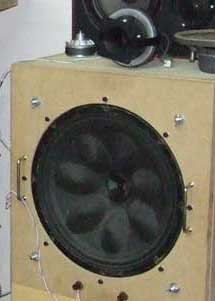

Tannoy 15 inch 385/HPD's are one of our primary in-house
references. We have three pair using Joe Sammut's extra-
special crossover in Jensen Imperial and Ultraflex enclosures.
Nelson Pass said:Tannoy 15 inch 385/HPD's are one of our primary in-house
I have just these ones - Poor Serbian Man Tannoys .......
