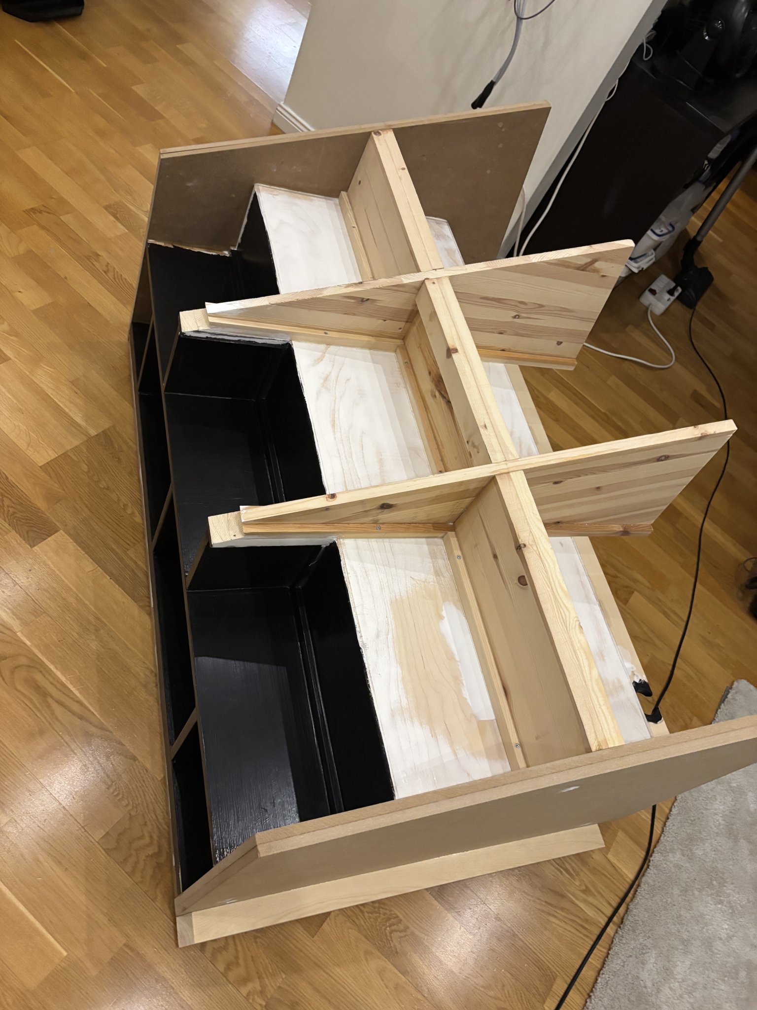

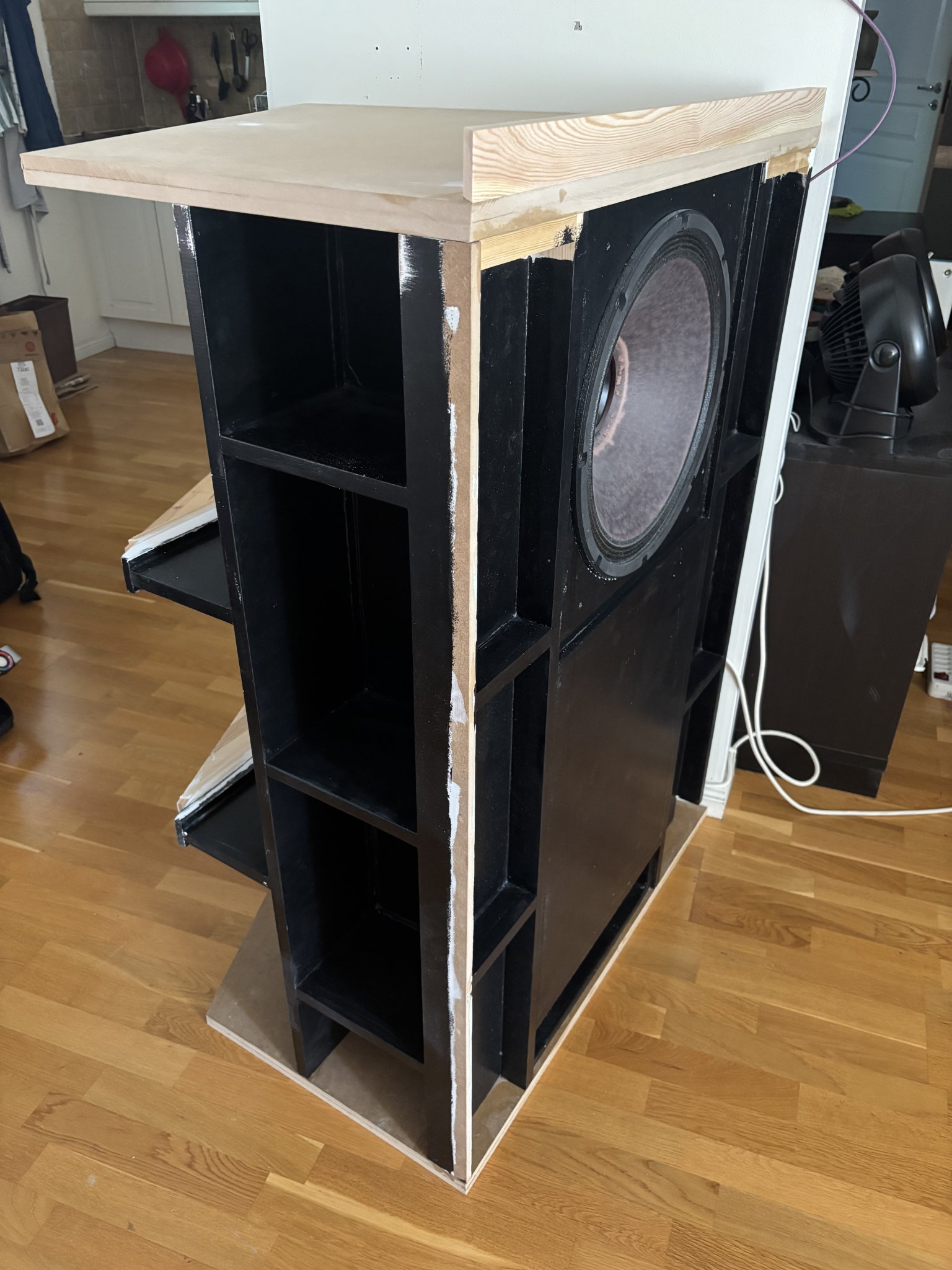

Right speaker treatment. Widening baffle and silencing the body. You”d be surprised how much your spks spks outside membrane.

It was not the sound enhancements that originally got me in to the idea of enlarging them. It was rather that they are already so big that they take up a lot of room and attention, and I thought, why not build them into kind of sideboard furnitures, so they blend in in a different way. But it was very noticeable how the baffle widening enhanced the low mid with less baffle step and diffraction. Next step is to dampen it with asphalt and isolation, then wrap it up with an exterior.
