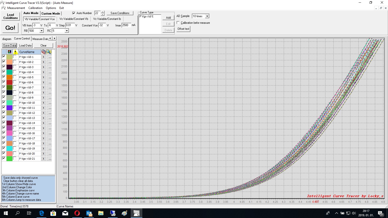

Some curves about IRFP9140s and IRFP240s.
There are not significant deviances, regarding types, at least with this type of measurements.
First 15 are IRFP9140, last 6 are IRFP240.
Sorry for being off topic, again. 😉
Question:
What can I expect, if I take apart all of my finished Pass Amps, for precisely matching FETs.
Good Old New Aleph has if I can remember correctly total sum of 36 pieces IRFP240s.
Aleph 4 has total of 24 pieces of IRFP240.
Balanced F4 has 6 pc. IRFP240 and 6 pc.of IRFP9240 in one side, and has 6 pc. IRFP240 and 6 pc.of IRFP9140 at other side.
Would be a brutal suc!k, thwere is a real question, is it worth it?
