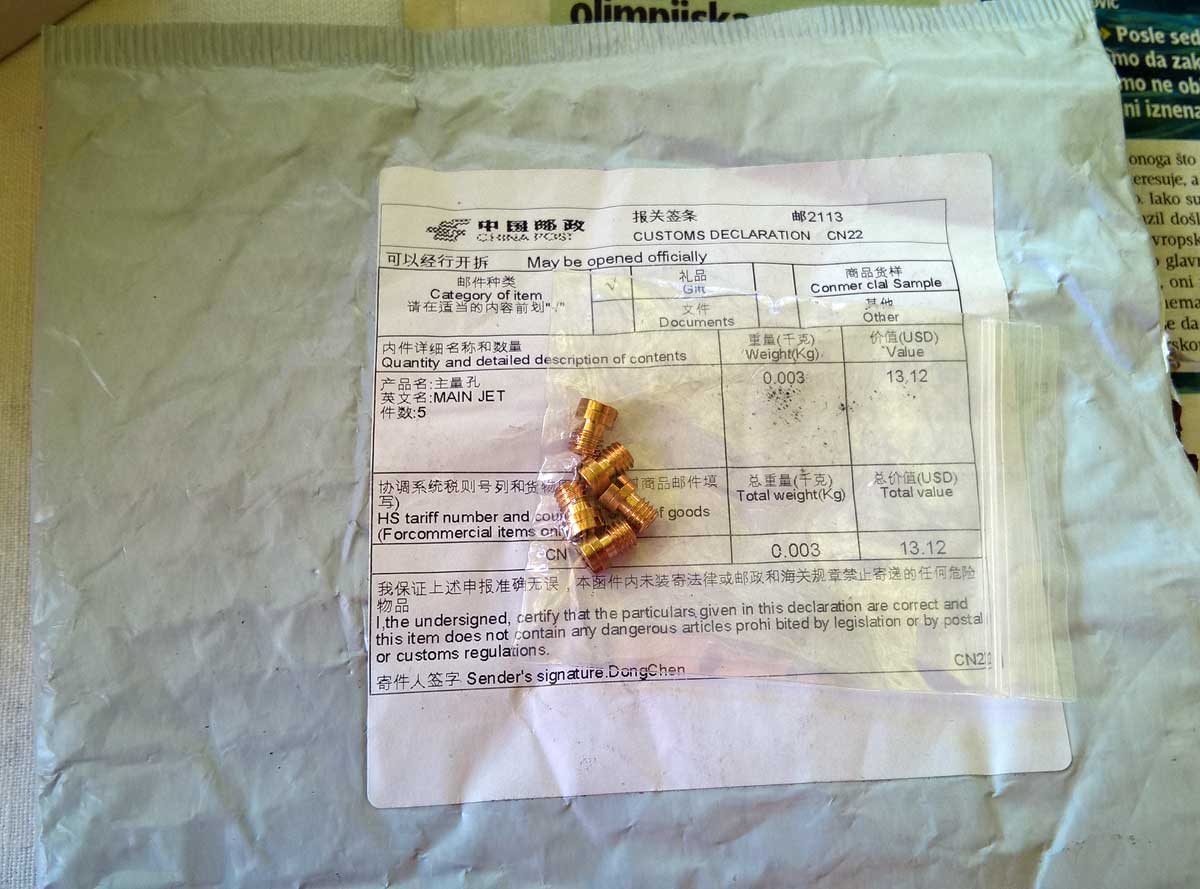

already increased idle jet , now got these
no more lean
this will arrive (delivered to friend in Vienna) in few days

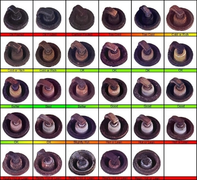

dude thats serious. why not just take a peak on the plug after a drive?
Edit: bad pic but whiteish to thin, black and oily to fat and chocolate brown good enough
Hard to tell what's happening at wide open throttle by looking at the spark plugs. Up to a point lean is faster and rich is safer.

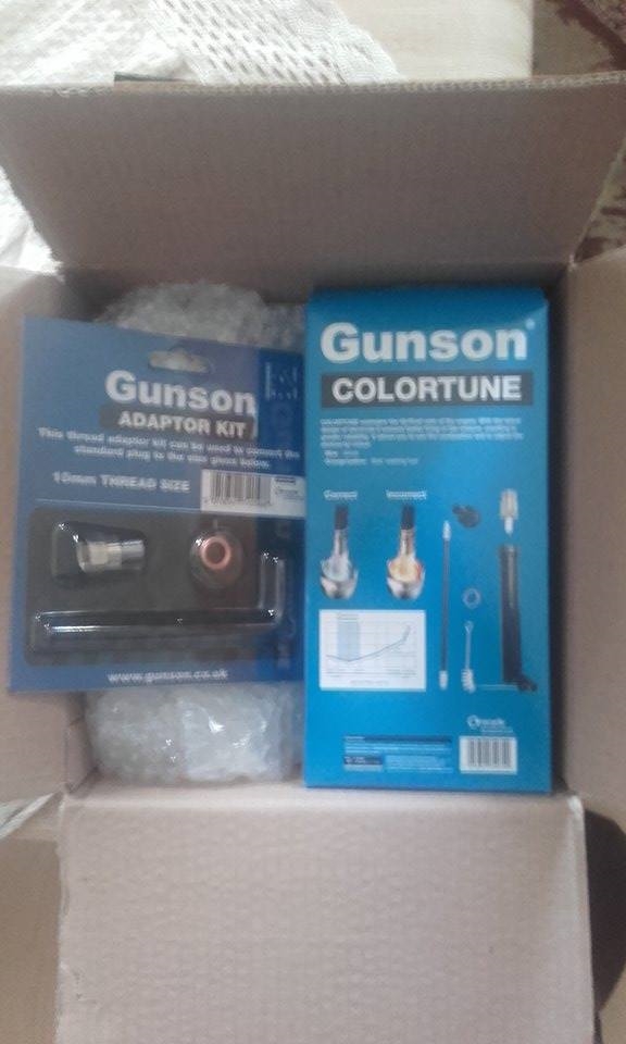

I would like to see anyone peaking thru that gunson att wide open throttle🙂
http://test.gunson.co.uk//items/PDF/Products/G4171_Chart.pdf
Colortune is , by my understanding, intended (and good) up to 3K Rpm
and , certainly must easier to work with than repeatedly pullin plugs out
however - considering nature and history of my little bike - carb Keihin clone, most probably too lean from factory , but I tossed one carb and kept just one , with 1 to 2 Rebel manifold , K&N filter (mounted on proper length intake hose) , and new (read - more open) mufflers ........ it's logical that I must increase both idle jet and main jet ..... and tweak needle position
all that much faster with Gunson thingie than change-ride-stop-pull plugs out ....... change-ride-stop-pull plugs out ....... change-ride-stop-pull plugs out ....... change-ride-stop-pull plugs out ....... change-ride-stop-pull plugs out ....... change-ride-stop-pull plugs out .......
OK , for now - I have original 94.5 main
got from China 98,100,102,105,108
hour ago , I pulled 94.5 out and put 100
it's already better
it'll stay in , 'till I get Colortune
edit: and , it'll be handy for my V35 Guzzi and , hopefully, Suz Savage 400 engine , put in second Chinese chopp
