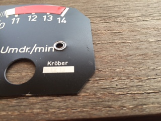

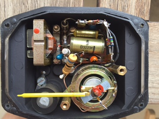

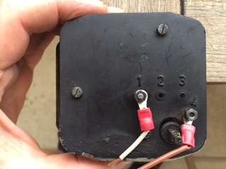

Heres inside, backside and something that says LZ13 very vaugely.
Some text found on internet:
LZ13 (universal rev-counter)
- on engines fitted with a transistor battery ignition @ 6-12 Volts that produces a spark every rotation of the crankshaft.
- on engines with magnetic point ignition with 2 or 4 magnetic poles, that rotates at crankshaft speed. The contact breaker interrupts the circuit every rotation of the crankshaft.
- on competition engines fitted with a BC ignition which produces a spark every crankshaft rotation.
Link to a forum explaining "A Krober must always be mounted 25mm away from all adjacent parts. It is always connected to the contact breaker by the lead supplied with the rev counter on terminal 1. The mounting bracket of the rev counter which is connected to terminal 4 of the rev counter by a short lead must make electrical contact with the earth of the motorcycle. If used with electronic ignition the main lead is connected to the CB side of the coil."

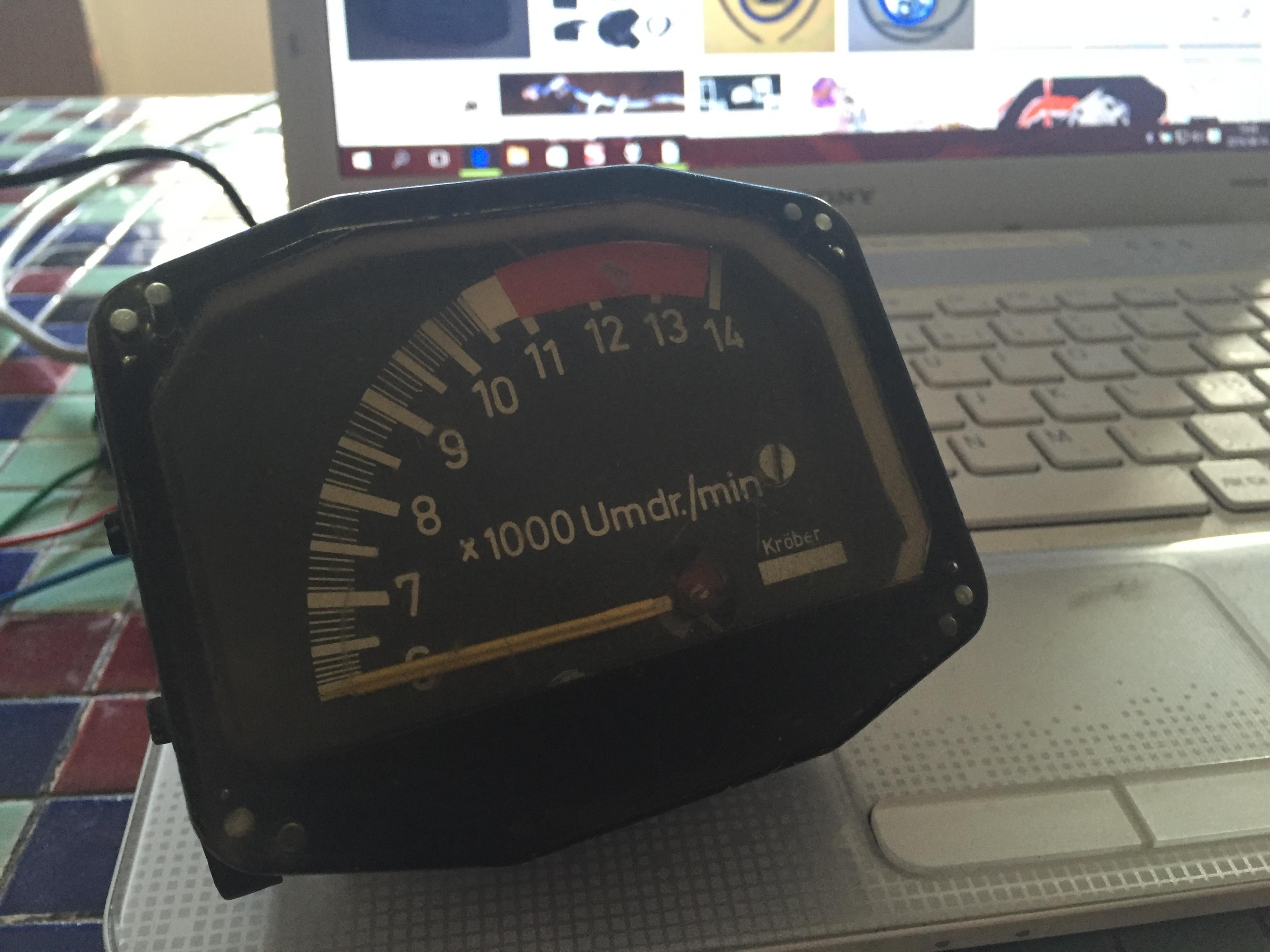

just connect it to siggene and crank it until movement
triangle wave best , rectangle after , but even with sine it'll work
replace tantal cap(s) just in case - with solid or proper elco
