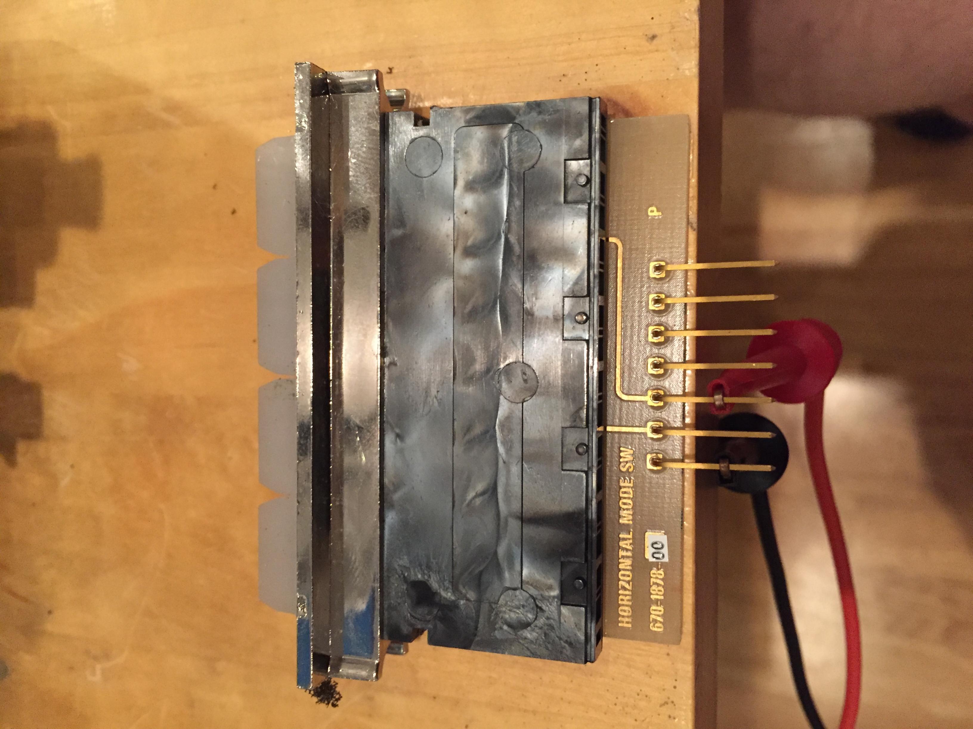

I think readout must work regardless horizontal switches.
Readout works. I smashed it together in joy when I thought I had fixed the horizontal mode pushbuttons, but found out I hadnt fixed it. Tho, when I separated the compartments a PSU connector cable got loose, an unfortunately it could sit in like 100 different ways. I tried all combinations on that until I got the little dot back in the corner on the screen. I will try to take the pushbutton thingy out and measure between the pins when I have the opportunity. Thank you for support Gyuri.

It is not nothing, but I suggest you must have to read service manuals.
Regarding loose cable, they usually marked pin 1.
But as you said, you tried it some way, it can causing some short circuit.
So I suggest to check all PSU voltages first.
As I see, it have a different PSU topologies than Tek 485 and Tek 7104, whose are similar. Above two has a very friendly PSU, if you make a short circuit, then it disables, and as SC has gone, it work flavlessly, as if nothing happened.
But these has a special IC, if it has gone, you can throw out the whole thing out of window.
Maybe we can open a new topic about your 7704.

Great idea. I printed the Service Instruction Manual today, the other I had. I will do some studies in the manual and put the 7704 up on the table hopefully to this weekend. Pointless to do it when I dont have time to try out eventual tips.
Ripped the pushbutton array out and did a quick test. When no button is pushed in, no pin shorts to any other. When any button is pushed in, all pins shorts to all the other. Guess I can conclude that really is the first and foremost problem right? No need to start a thread on that, or what do you think?
