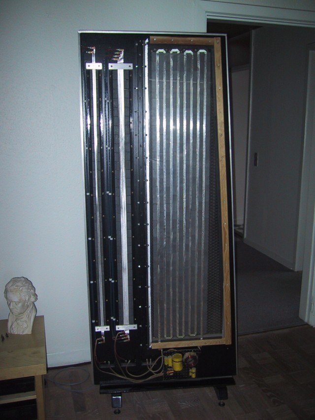

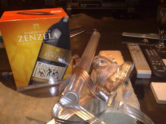

Its the stuff you can roast a chicken in, not sure what you call it overthere. I didnt try the Shiraz bag, but might be worth a try:D The alu strips are made from foodwrapping paper with thin alufoil on one side and paper on the other. It is easy to handle with the paper still on. Once the ribbon is finished, the paper is stripped off, with help from a little water. The alufoil is very thin, and impossible to handle by itself. Seems that foodwrapping stuff is great for speakers. Here is a finished speaker.
