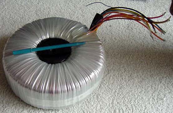

I need to find a metal shop that can do the metal work here locally but that shouldnt be a big deal. I can AutoCAD the layout etc. I have already been talking with Chris from the other post and i will see how he feels about joining forces!
I have a pair of transformers already i would like to use if possible for at least 1 of them as i want to build mono blocks for myself. But i could build the 2nd amp a stereo version or what ever you want..
The transformers i have are 2KVA Medical Grade Isolation transformers. with quad primaries of 100, 110, 200, 240V and dual 120V secondaries.
My intent with these was to run them at half voltage. IE: run them from 120V on the 240V tap to produce dual 60V 500Va secondaries. this should get me/us +/- 85Vdc @ 1Kw correct??? If my calculations are correct. that should be good for about 400 watts including losses. But correct me if im wrong.
these are BIG 9" diameter, 4" thick and 35lbs each (see photo)
For the other one. i will have to locate what ever is needed.

Zero,
If I read your post correctly, those transformers will probably work, assuming that Nelson doesn't go single-rail on you. Start amassing 100V caps, heatsinks, etc. Word to the wise: An unexpectedly difficult item to find is...a reliable power switch. Expect to spend a young fortune on good switches or use a small switch to control a high power relay.
