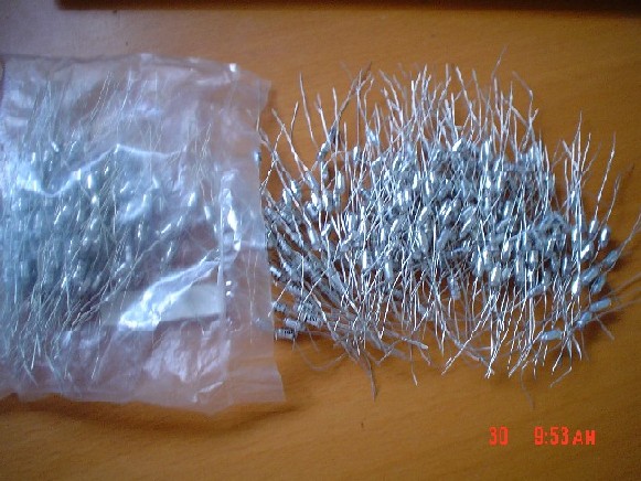

These are 160 volts Siemens polystyrenes(styroflex's)
For some reason overhere these are periodically dumped on the web since a year or so.
Bought this bag of 500 for something like $0.03 the piece.
Siemens(Epcos) used to produce 1% accurate polystyrenes (square orange B31531 series) which were marvellous for RIAA circuits
