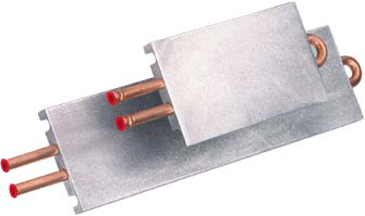

Yup, pretty easy. Built my own a/c unit with about 1300w of peltiers and a surplus hydraulic cooler.

Several of these handle 10-15kw worth of power in argon laser supplies used them in my a/c unit.
