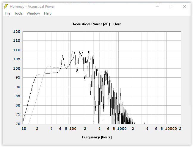

I'm interested in building a 4.5foot tall version of this box can any one offer me some advice. on weather extending the horn path and refolding the horn to create a cabinet of suitable dimensions for my needs is going to have a negative effect?
Chances are that unless you are very well versed with horn resp & have a multitude of horn designs under your belt modifying the Othorn will prove a frustrating and arduous process with very little gain.
A 4.5' tall x 3' deep x 2' wide enclosure is gross 27ft^3 & with that size in mind I would say you should look at either other plans floating around or, if you really want to do some heavy lifting, simming up your own design in that size range.

Hi bendepearce,
Assuming that you want to extend one of the 36" dimensions to 54" (4.5ft), and using as reference: the Hornresp simulation from Post #1, and the technical drawing from Post #2:
As a first attempt, if you leave L12 (throat, and the whole left side of the box) alone, and just pull out the right side (mouth, and the turns above the mouth) by moving it 14" [45.72cm] to the right you will increase the individual section length as follows:
L12 from 27.50 to 27.50 (original + 0 x 45.72)
L23 - 218.46 - 355.62 (+ 3 x 45.72)
L34 - 102.76 - 148.48 (+ 1 x 45.72)
L45 - 36.51 - 82.23 (+ 1 x 45.72)
L_total - 385.23 - 613.83 (+ 5 x 45.72)
In other words, take the plan from Post #2, cut it vertically in the middle, add your desired additional box size in the middle, and connect the old turn (corner) points to arrive @ the new divider positions/angles.
You'll end up w/ a lot of low frequency extension, something similar to the DTS-10. I would expect the big peak @ 69Hz to be smaller than in the simulation, but the upper end will not extend as far as the Othorn.
P.S.: I used the manufacturer's T/S and Eg=2.83V in my attached simulations.

I should have caught that while I was typing away, but in the second paragraph: 45.72cm is not 14" but 18". The rest seems correct.
