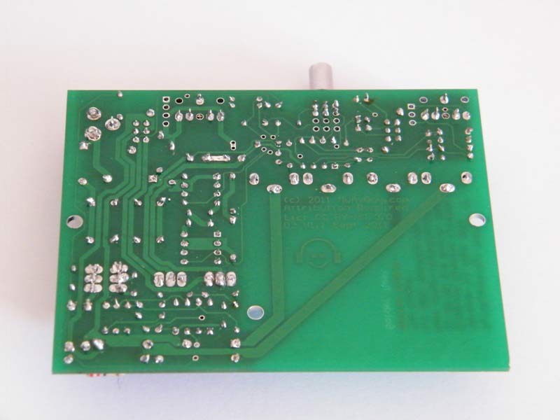

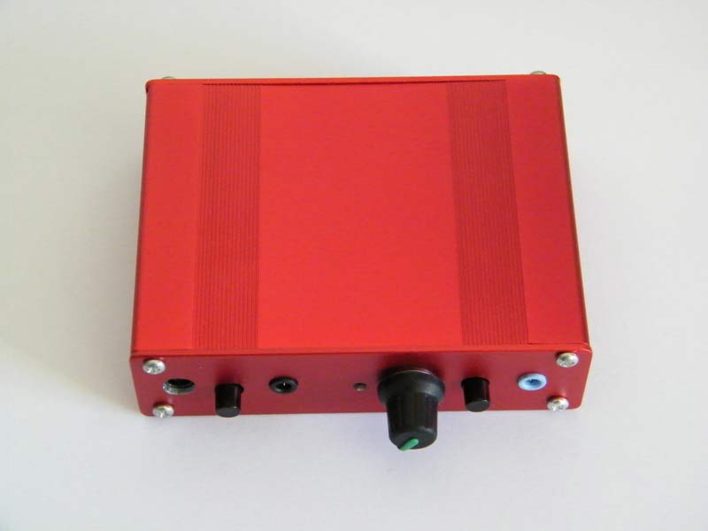

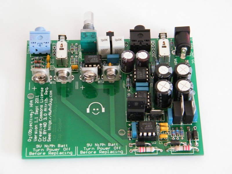

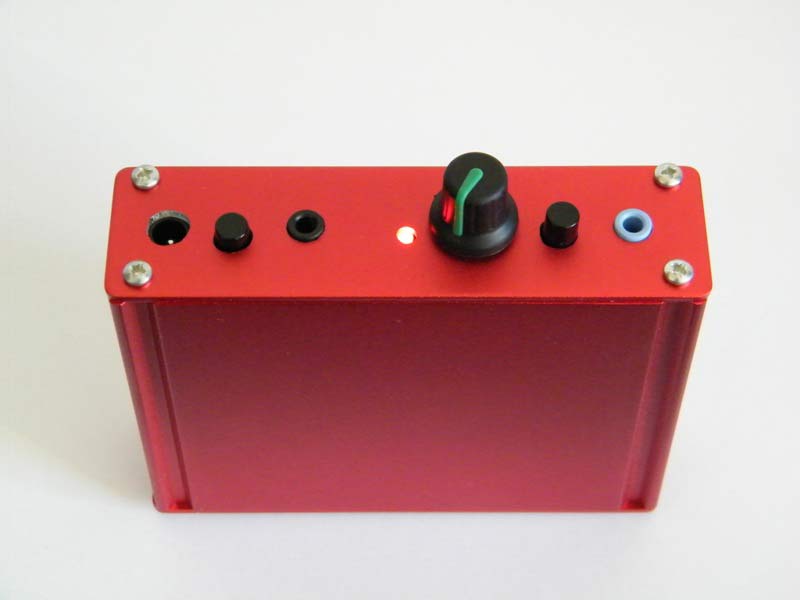

Just thought i could share the pics of my finished O2.
Not the most professional look of the front panel holes, but i don't really have the apropriate gear to make them better. For me, they are good enough.
Seems like the forum is not friendly accepting imageshack links...
I can't edit my previous post, so i'll try again.
The holes were made with a dremel like tool, with a small drill and widening the holes slowly, checking the fit now and then. Not the best method, but the only one i could find.
