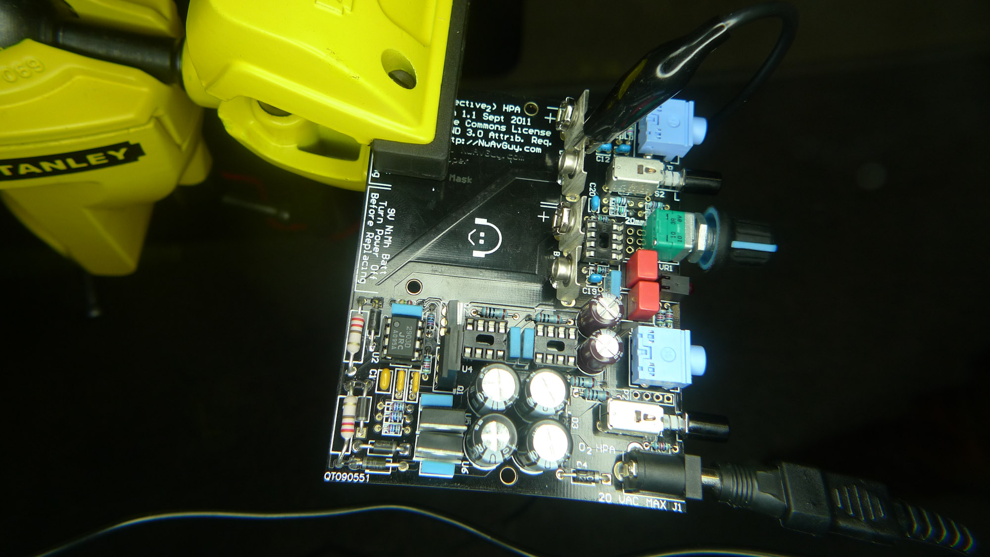

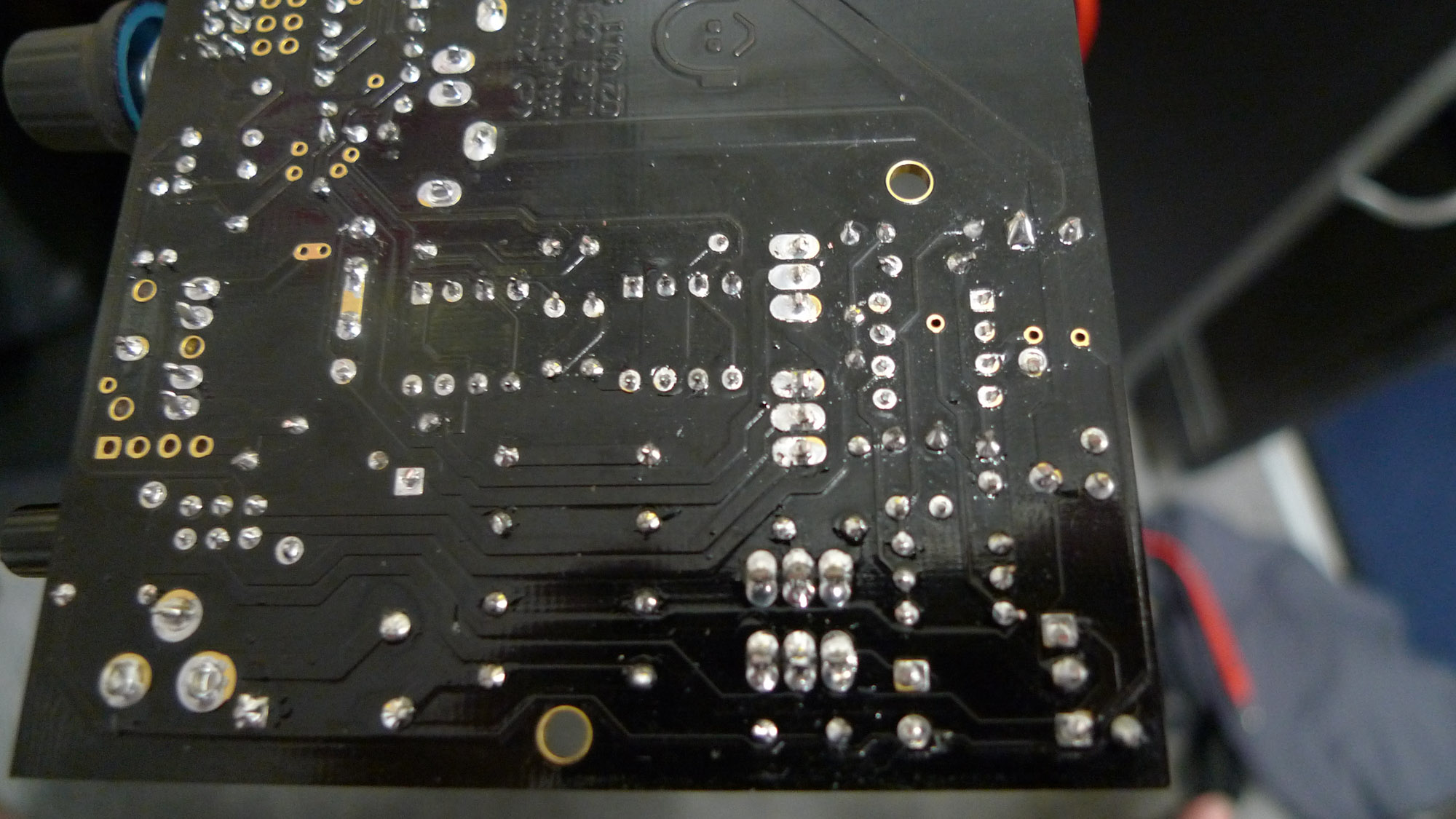

Just tried to build my O2 last night.
I'm having some problems with the voltage regulators though. I think they may be cooked but would like another opinion before I go buying more just incase I'm wrong.
AC adapter output is 14.5VAC.
Input to voltage regulators is 16.9V and -16.9V for +/- reg respectively.
From output of the voltage regulators though I'm getting -6.9V and 7V. Polarity same but 5V lower than the expected +/- 12V. This is measured at D1/D5 as per RS testing instructions. Is it likely that I have blown both regulators and each failed regulator is giving an output that is still this well matched?
My camera batteries are flat, I can take a pic once they're charged if it'll help ...
Doubtful that the regs are cooked. I'd take a real good look for any solder bridges at both top and bottom of the board. Also double and triple check that the power supply components are correct values and installed correctly. I've only skimmed RS's new O2 troubleshooting section of his blog, but so far he's been nothing if not thorough in his documentation. It's likely you'll find help there, aside from anything he may want to add here in the thread.
Thanks, that is hopefully good news!
Would anyone mind having a gander at these pics, I haven't spotted anything jumping off the page at me yet.
In addition to the measurements in my last post nothing is getting hot/warm which was another of the checks that RS recommended checking for in his testing guide. Power button is still in the off position.
