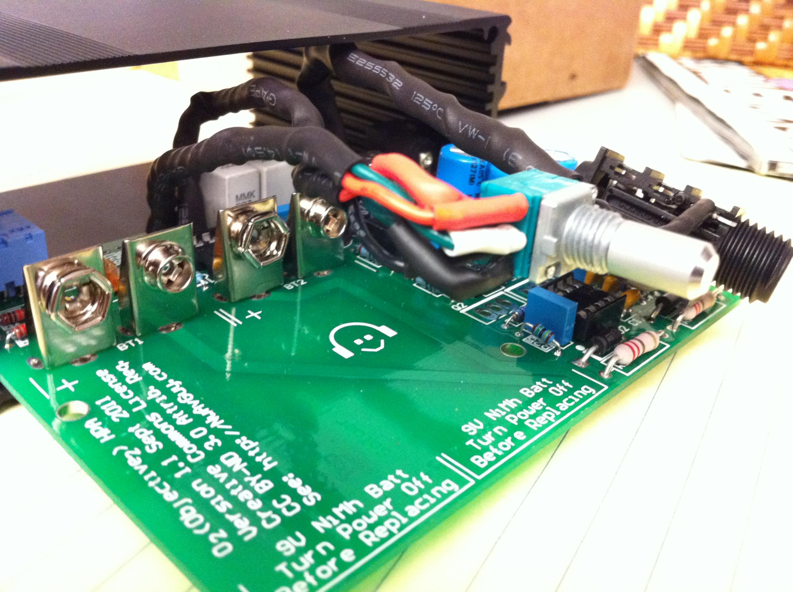

Remote mounting pot
I'm planning on running this using the batteries for most of the time. Puting the battery on the board, the wires are pretty much right on top of the batteries, may be 1mm over it. Is that ok? or will the batteries introduce noise into the pot cables?
@Limp, did you run all the power controller tests in the Initial DIY Testing section? You might have static zapped a MOSFET and one of them is stuck on which would cause one rail to turn on before the other making for a much bigger transient. With either rail low, both MOSFETs should shut off. Be sure and conduct the tests with no headphones connected.
Everything seems fine, right up to the Low Voltage Shutdown test. With one battery intalled I get ~.5V, and with the other I get about half that. Now both are below the .7V you mention in the blog, but it is still a prety large discrepancy.
Is this where the problem is?

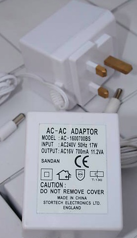

I am having a nightmare trying to find a power supplier for the O2 here in the UK. I have found this, would it work for the UK?
It will if the plug fits properly in the O2. The output ratings are fine. 16VAC 700mA puts it right between the WAU16-400 and WAU16-1000 adapters on the BOM in terms of current capability, but the manufacturer doesn't specify if the output plug is a 2.1mm.
Sandan Limited (BS)
If you have access to the adaptor just try it to see if it fits, otherwise maybe the seller could confirm what output plug it has.

Thanks for the info. I am not too worried about the output plug, that can easily be sorted out. I will get one and see how it goes as it is not so expensive.
Thanks again

Just curious - which mosfets from those listed on the BOM did you use (which part numbers)?
FQU17P06 for Pch and the Nch says FQPF10N20C. It's what was supplied with Jokeners kit.
I have now replaced both MOSFETs and all tests seem ok. I get ~250mV on the Low Voltage Shutdown test, but there is still very loud 'pop' when I turn it on.
