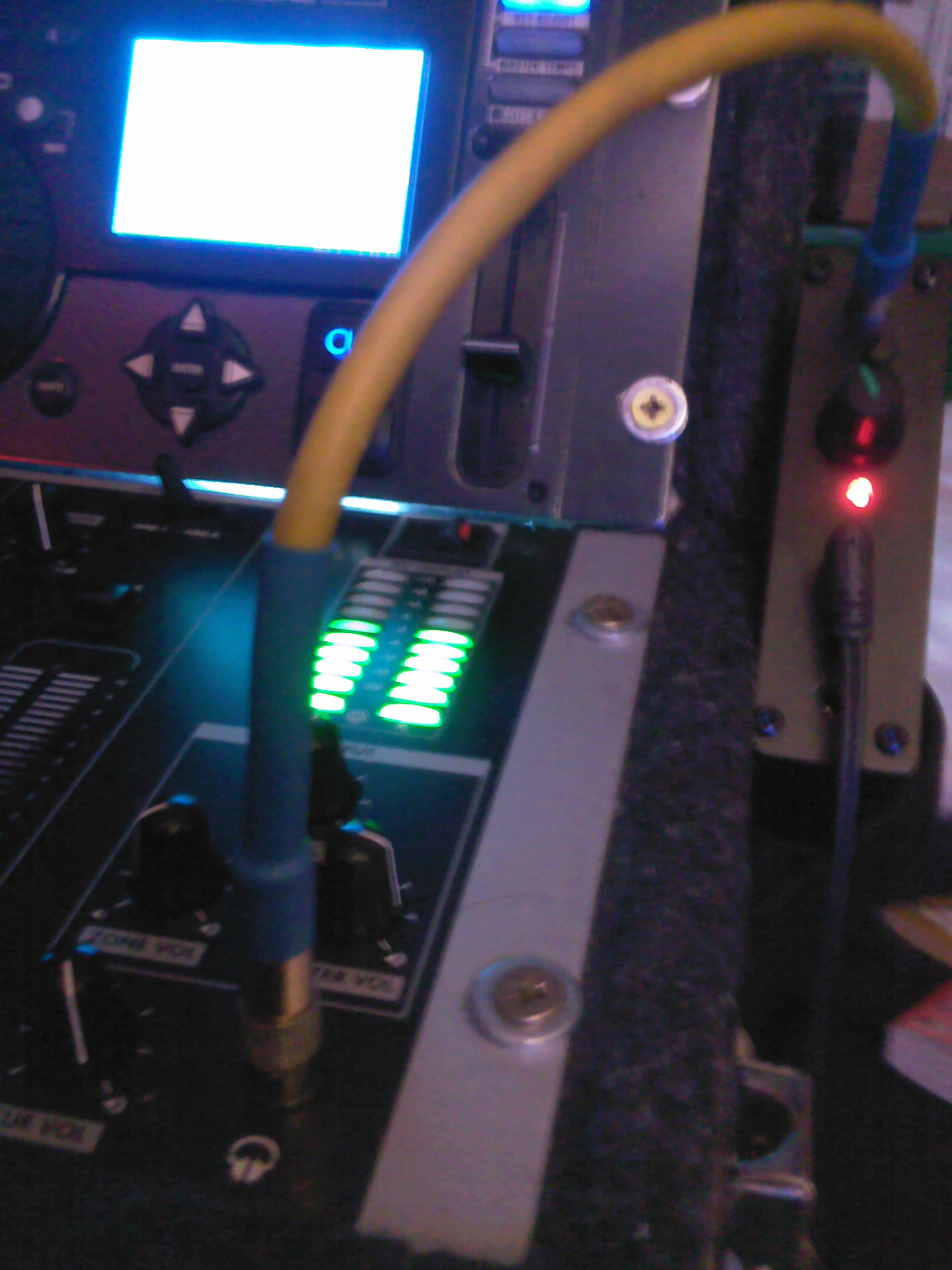

'Hardcore' use of the O2!
The output level of my DJ mixer was never enough to drive a pair of HD25 headphones to a high enough level to match my PA system. Now, however, boosting it with my O2, there's headroom to spare - certainly need to heed the warnings about being careful to avoid hearing damage by not turning it up too far. What a wonderful sound, clear, clean and powerful. Just as a bonus, the O2 drops neatly into the console's carrying handle, which positions it in exactly the right place...
