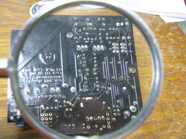

.... What could I try?
I don't see anything out of place in the photos. For starters, if you have a meter, do the test I posted here for BobSaysHi and lets see if your power supply is OK. Note that this test is with the power switch "off" - out position. In your case you would measure to those pads where the battery terminals would be, since you don't have battery terminals soldered in yet. Alternatively you could measure to either side of those big R1 and R2 resistors.
http://www.diyaudio.com/forums/head...headphone-amp-diy-project-19.html#post2797483
You should read somewhere within +/-0.1Vdc of +/-12.0Vdc.
If that works then do the same voltage measurements between ground and the battery pads with the power switch "on".
It looks just fine to me, was the exploding opamp turned in the wrong direction? What about the diodes, are they pointed right? They are a bit hard to see the direction on.
Brgds
Checked then and checked now again:
All diodes are in correct direction.
The amp directions were correct too, double checked before first power on.
I will do the suggested measurements later and report on that. Still curious about the reason why the LED stays off since the error occured.

Agreed! That is why the voltage measurements. If you get +/-12Vdc with the switch off, then your power supply is OK, at least with no load. And when you turn the switch on (all the chips still out, of course) if you get +/-12Vdc then things get interesting, since the power LED and a series resistor are right across the power supply rails after the power switch.
Also FWIW, here is a picture of the backside of one of my unmodified boards. Your solder joints are fine, but it is easy to "flood" them with solder if the solder is too big. I've actually been using 3 sizes of solder, which helps: 0.015" for surface mount and the very smallest O2 holes; 0.022" for most of the pads on the O2; and 0.050" for the bigger pads like the battery terminals and power jack. Looking at your board I'm guessing you may have used 0.050" or larger for most of the holes. The tiny tip I'm using on the iron helps a bit too, but solder size is probably a bigger factor.

The LED is literally right after the power switch. The voltage from the LED is used by the power management comparator (U2) but the LED itself should come on even with U2 not installed. Where it's drawn on the schematic might not make it obvious, but it's literally hardwired to the power switch.
So if the LED isn't coming on, on AC power, the only possibilities are the LED itself, R6, a bad solder connection/trace, a short or something drawing way too much current (the regulators would get hot), or something upstream of the power switch which is easy enough to check if you have a DMM. Pins 3 and 6 of the switch should be close to 24 volts with the power switch on. If not, are the regulators getting hot? If so, there's a short or bad component somewhere in one or both rails to ground or shorting the rails to each other.
If there's 22+ volts across pins 3 and 6 of the power switch, check the voltage across R6, it should be about 21-22 volts. If it's the same as you measured across the power switch, the LED is either shorted, or there's a solder bridge. If the voltage is much less than 21 volts across R6, the LED has either failed open, or isn't soldered fully, or the traces to it are damaged.
You can check the voltage directly at the LED terminals. It should be around 2 volts. If it's much higher, the LED is bad (or in backwards). If it's much lower but not zero the LED is bad. If it's very close to zero the LED is bad or there's a solder bridge.
Are you using battery or AC power for your testing? One other person installed the battery terminals backwards which will also keep the LED from coming on and can damage the op amps but probably not make them explode (the otherwise high reverse current is limited by the 220 ohm resistors R1 and R2). So, regardless, make sure the "+" terminals of the batteries are the left (input side) of the board.
