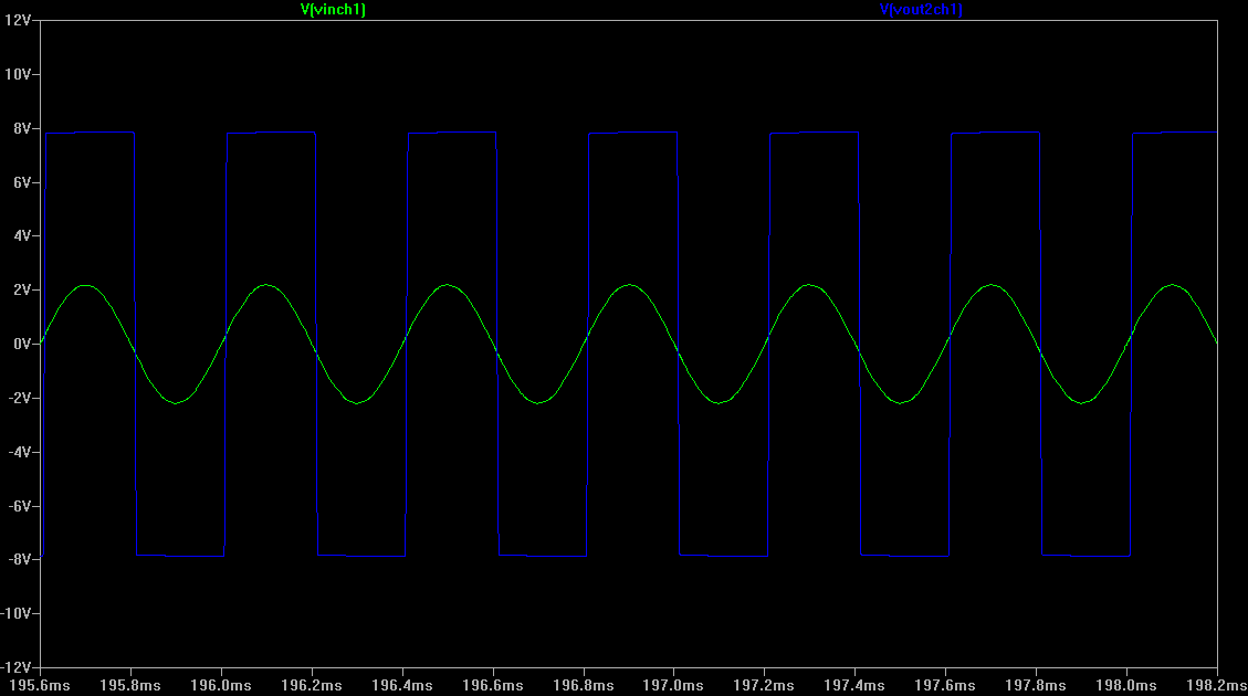

Got my amp all built using stock gains, x2.5 and x6. With my HD558s only one channel plays normal on the first gain x2.5 and on x6 both channels are balanced just fine. Not sure if that is something to do with the gains or if something went wrong with the build. Any suggestions as to what should check out?
Check around the gain switch and U1 for solder bridges to the PCB ground plane. The metal shell of the gain switch is connected to ground via the two pins at the corners and the two middle pins of the 6 gain switch pins are soldered to ground. You might have a bridge from one of the remaining 4 pins of the switch to one of those. A magnifying glass is highly recommended for this one! Some bridges can be very hard to see just by eye.
If the gain switch were just bad/open (no connection) you would get a gain of 1 in that position. Would still sound OK in that channel, just not as loud. But if the gain switch gets shorted to ground in one channel the inverting input of U1 gets grounded and effectively turns the op amp into a comparator. 🙂 Your incoming music waveform would get converted into square waves at the same frequency which would sound very distorted. Below is a plot of what happens there.
You can also test for a solder bridge by unplugging the amp from the AC adaptor and pulling out the batteries to disconnect all power. Then measuring with an ohmmeter from pin 6 of U1 to ground (metal shell of the gain switch) and flip the gain switch in both positions. Then do the same with pin 2 of U1. If you measure a dead short to ground at either pin in one of the gain switch positions, there is your solder bridged trace.
The other thing to check is that the values of R17 match R21, and R19 matches R23, of course. With the amp powered down and disconnected as above you can just measure across those resistors with the ohmmeter. In one position of the gain switch you should get the right reading.
