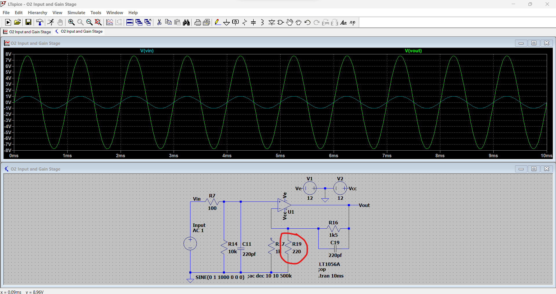

Hi, I have Hifiman HE6SE V2 headphones now and want to up the gain on my O2 (odac combo) as on some songs it is not loud enough. What is the max gain i can set the O2 to and what resistors need be soldered where? would 2,5x and 8x be possible?
You can set the gain as high as you want.
A gain of x8 needs a 220 ohm resistor here. 1 volt in gives 8 volts out. Also make sure the 100 or 274 ohm input resistor is correct. To high and it will attenuate the input. In my diagram the gain is R16 divided by R19 and then you add one to the result. So x7.8
The 274 ohm shown on the original circuit is close enough though. Make sure these resistors are fitted and that they connect correctly to ground. The lower the value the higher the gain.

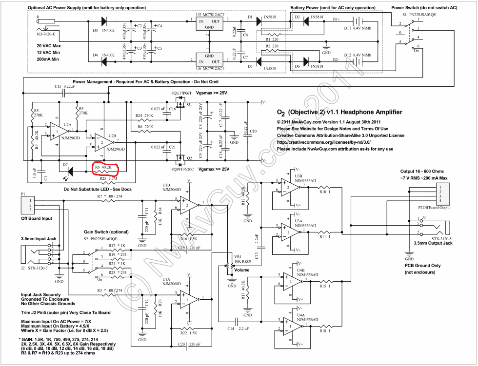

I want to bypass/remove the volume pot to use an external volume control before the amp.I can put voltage divider resistor sets instead of volume pot.What is the minimum attenuation level amount to obtain low noise and maximum output voltage for this O2 amp?

There are unity gain buffers after the pot, so you can just bypass the pot, and not need any pad to replace it.
The voltage gain stage and the output buffer stage will now both clip at about the same level.
Remove the pot, and for each channel, add a jumper between where its top terminal and its wiper terminal were.
Of course, you could also just turn the pot to maximum and not remove it. That would work just as well.

You don't need any added resistors, just either turn the pot to maximum, or remove and jumper it.
The output buffer stage has no gain, so a pad is not needed.
Changing the pot to an L pad would require the same total resistance as the pot.
Smaller resistors would load down the preceding stage and cause distortion.

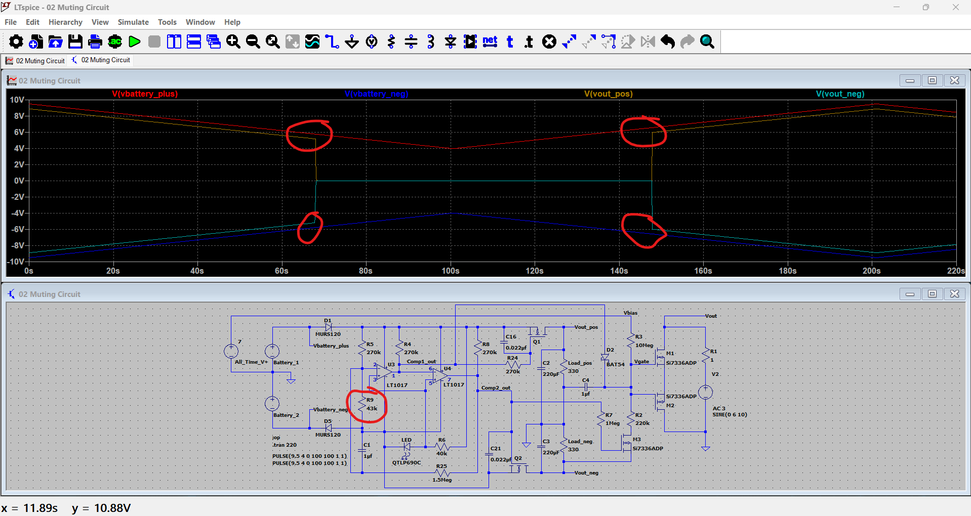

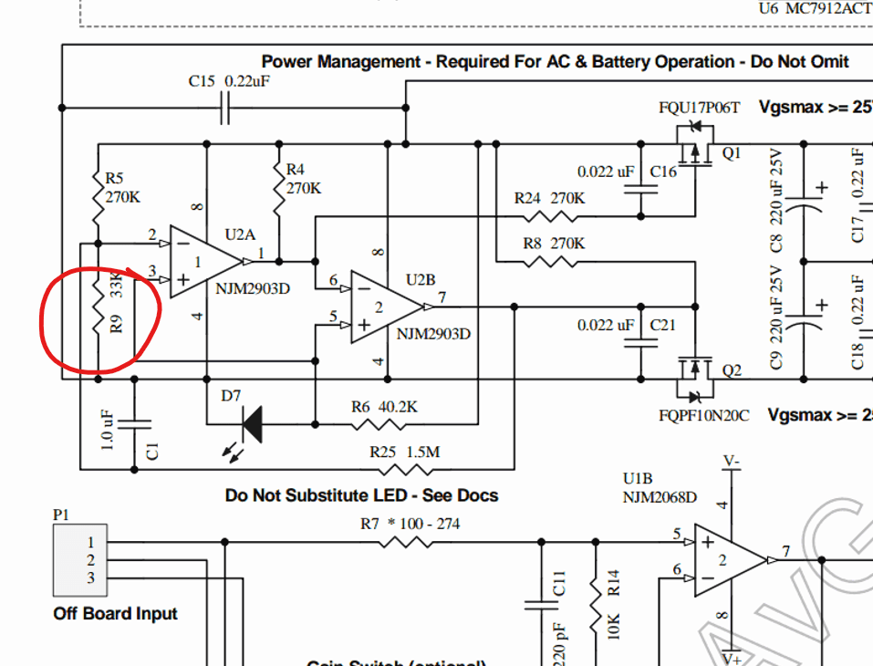

I also have one more question if someone wants to help.Do you know how to lower the "shutdown voltage" like 6v exact or 5.5v-6v interval?I looked at the documents,it only say that LED substitute in battery management section and 4.6v for input stage clipping.I am asking because I will use a single 12v battery with a virtual gnd circuitry.
Make this resistor a preset and you can set the trip points to whatever you want. This shows the unregulated rails falling and shutoff set to 6 volts per rail.
R9, the one at the left 🙂
All the LED does is generate a fixed reference and that is why the correct LED was always so critical in this design. You can use 'any' low current red led as a reference if you alter the divider network to get the trip points you want.
R9 and R5 form a divider and when the voltage on pin 2 passes through the fixed voltage reference on pin 3 the comparator changes state and turns the rails off. R25 introduces a small amount of hysteresis to stop the output entering an indeterminate state when the input pins are exactly the same voltage. The change in comparator output voltage feeds via R25 and pulls the input even more in the wanted direction ensuring the changeover is clean.
In other words the trip point for shut off and turn on are slightly different which is all to the good.
