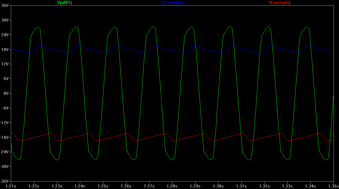

I wonder if it's possible to use a 24V AC adapter in O2. Yes, I did read the max voltage should be 20V AC.
Since the caps (470uF/35V) and both MC7812ACT & MC7912ACT are all capable to handle 35V, I thought 24V should be ok. Have I overlooked sth?

I think the regulators would cook.
Lets say 24VAC winds up around 30VDC after the half wave rectifiers and filter caps. Ignoring line voltage fluctuations and transformer regulation increase with light loads, that would be (30VDC - 12VDC) * 0.1mA = 1.8W each with 100mA loading. But there are no heatsinks on the regulators, no space for any, and they butt right up against each other.

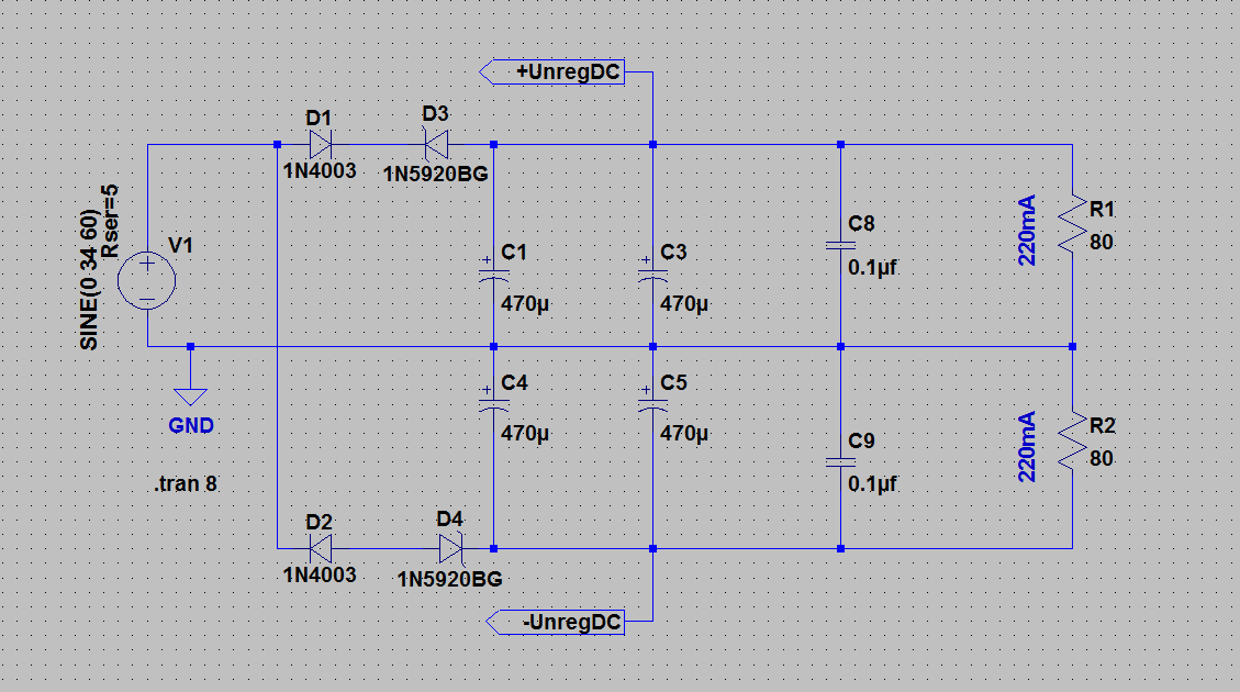

You could try adding 6.2V or so zeners in series with the rectifier diodes to knock the voltage down to level that isn't so close to the voltage regulator maximum. The resulting power dissipation is more in line with what the un-heatsinked voltage regulators can handle. The zeners then share in the dissipation.

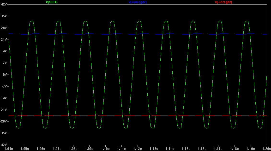

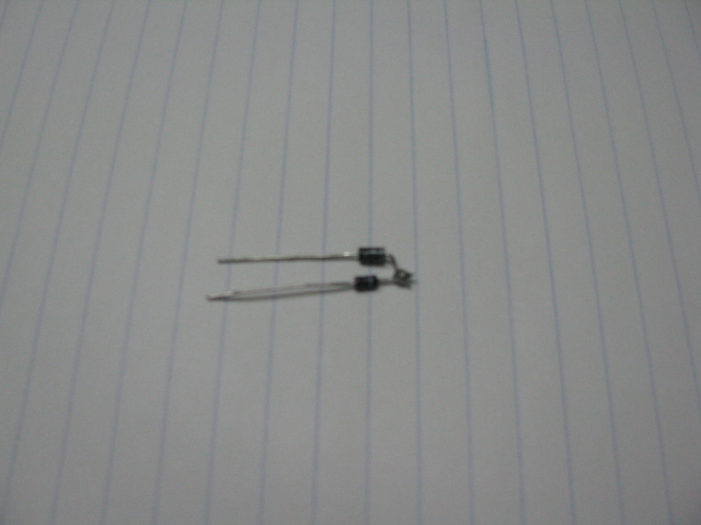

24VACrms = 34VACpeak = 68VACpeak-peak, of course. The first plot is with a 220mA load, around the max the O2 can handle, producing about +/-18VDC going into the voltage regulator chips. The second plot is with a 22mA load resulting in about 24VDC going into the regulators. The picture is how to make it work. Solder the rectifier to the zener, then stuff the free leads in the holes where the rectifier would otherwise go.
6.2V 3W zeners like this would work just fine
