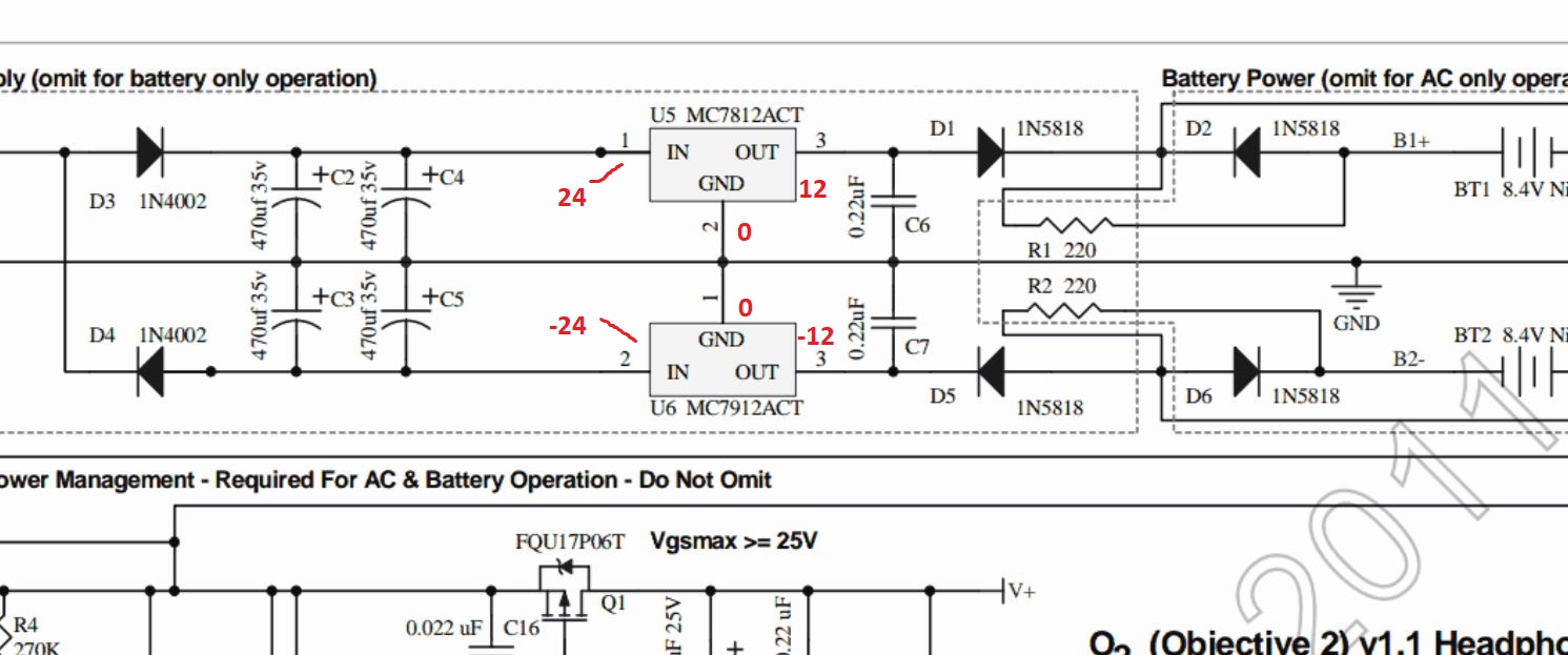

Oh well, I was doing the Initial diy testing (again) as described in NwAvGuys blog, sorry for any confusion.
As ground i used the connection from C8s minus to C9s plus, i hope thats ok!

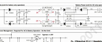

So,"Measurement" went fine, I got respectively 24 and -24 volts.
But coming to "Checking the output of the regulators", for 1) I measured 22.5V and for 2) ca 100mV.
I am pretty sure, that I fitted D1 and D5 in correctly - striped end to striped end can not be that hard, also i got everything running once - so, the diodes are probably faulty? 🙂
Your ground point is ok :checked:
Plus 24 and minus 24 is fine :checked:
You have a problem with the regulator outputs. Work on one at a time and check that the correct input voltage appears on the correct leg. Also make sure that the regulators are fitted correctly, the 7812 is the positive and the 7912 the negative. The pinouts are also different so look carefully at the diagram and measure all 3 pins on each regulator.

Your measurements suggest a problem with both regulators... which is unusual because electronic components like these are ultra reliable when used correctly.
With it in this faulty state it might be worth you switching it OFF at the mains and then checking to see there is no short between pins 1 and 3 on the 7812, and no short between pin 3 and ground of the 7912.
Beyond that and we have to say that the regulators need replacing before we can go any further.

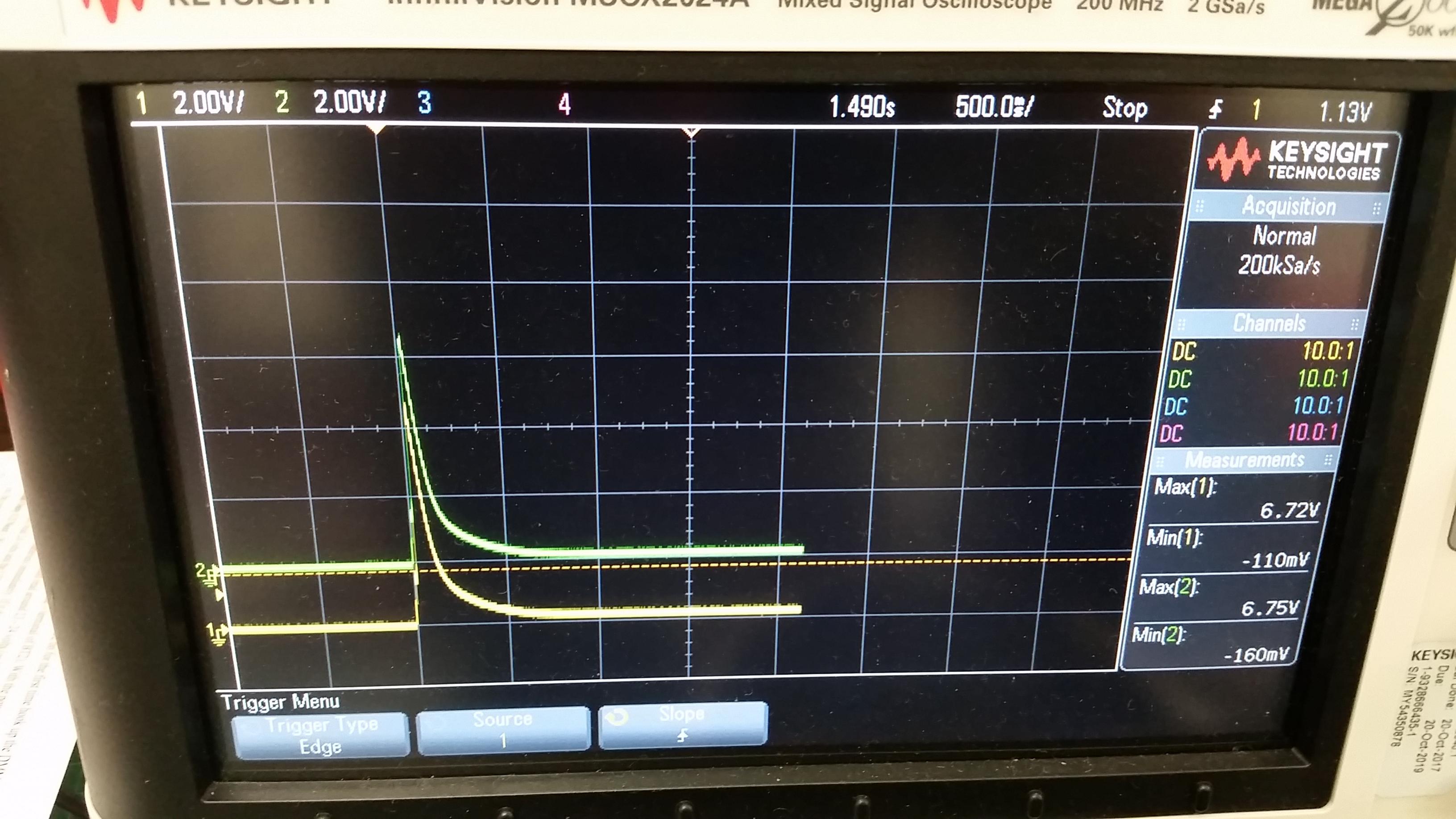

I've just completed my O2 amp. All of the tests passed except some of the resistances around the power management were slightly off and the low voltage shutdown test failed.
When removing one of the batteries whilst the amp is turned on with no headphones connected I get the following results on the L & R channels. The instructions say that these measurements should be below 0.7V but as you can see removing battery 1 produces -2.1V and takes about 1 second to drop below 0.7V ; removing battery 2 produces a larger spike to 6.7V which drops more quickly but still ~0.5s to drop below 0.7V.
Removing BT1
Removing BT2
I've tried replacing U2 and Q2 to no avail. Can anyone suggest what the problem might be, where I should look in more detail and how to fix it?
The test itself seems a bit unrealistic as there in no load attached to the output. Should it be carried out with a dummy load?
I've listened to the amp with cheap earphones and everything sounded good but don't want to plug in my expensive headphones until everything is perfect.
You don't need a load to check this, although a load will alter the time constant i.e. how long the supply takes to fall due to the action of the 220uF caps on each supply rail.
It sounds like yours is fine tbh. The rails can not fall to zero immediately because of the caps.

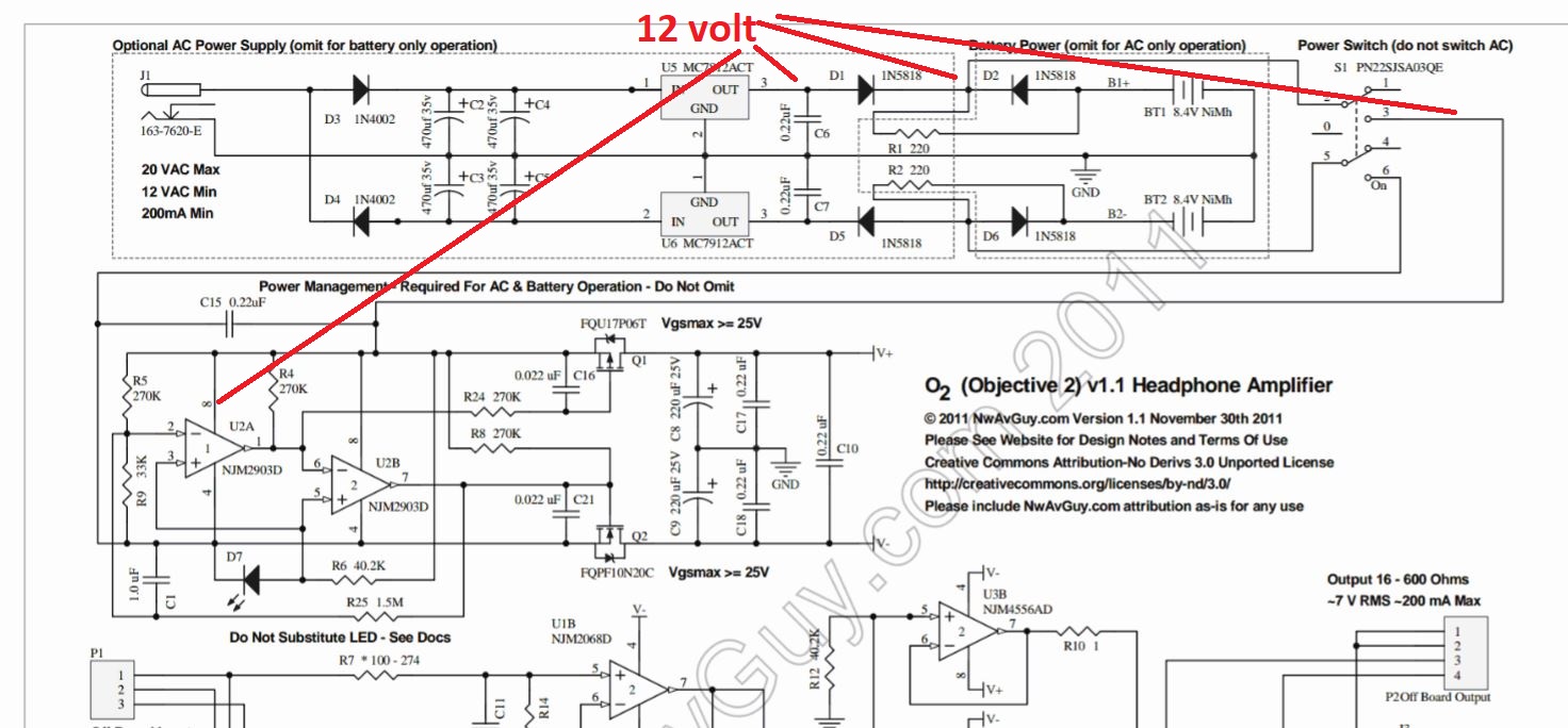

Oh well, it took me some time to get the replacement voltage regulators and the time, to desolder the old ones. Oh man, that was a real pain, needed some help of a good friend of mine for that.
They are replaced now and they work correctly.
But the amplifier still does not work.
So I went ahead in your guide. In "Checking the voltage comparator and switched output rails" I don not get the correct voltages on pin 8 of U2.
I am going to order new ICs and see, if that fixes it. 😀
If the regulators are working correctly you will have +12 Volts on the 7812 (U5).
If there is no 12 volts on pin 8 of U2 then you either have broken print, a faulty switch or D1 is fitted wrong way around.
