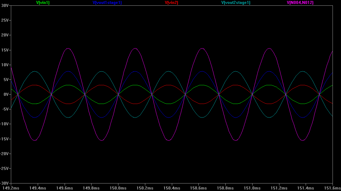

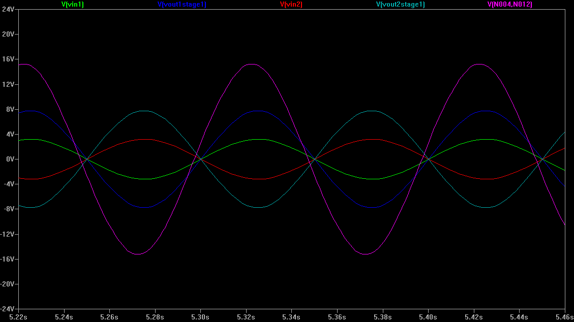

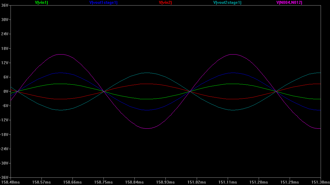

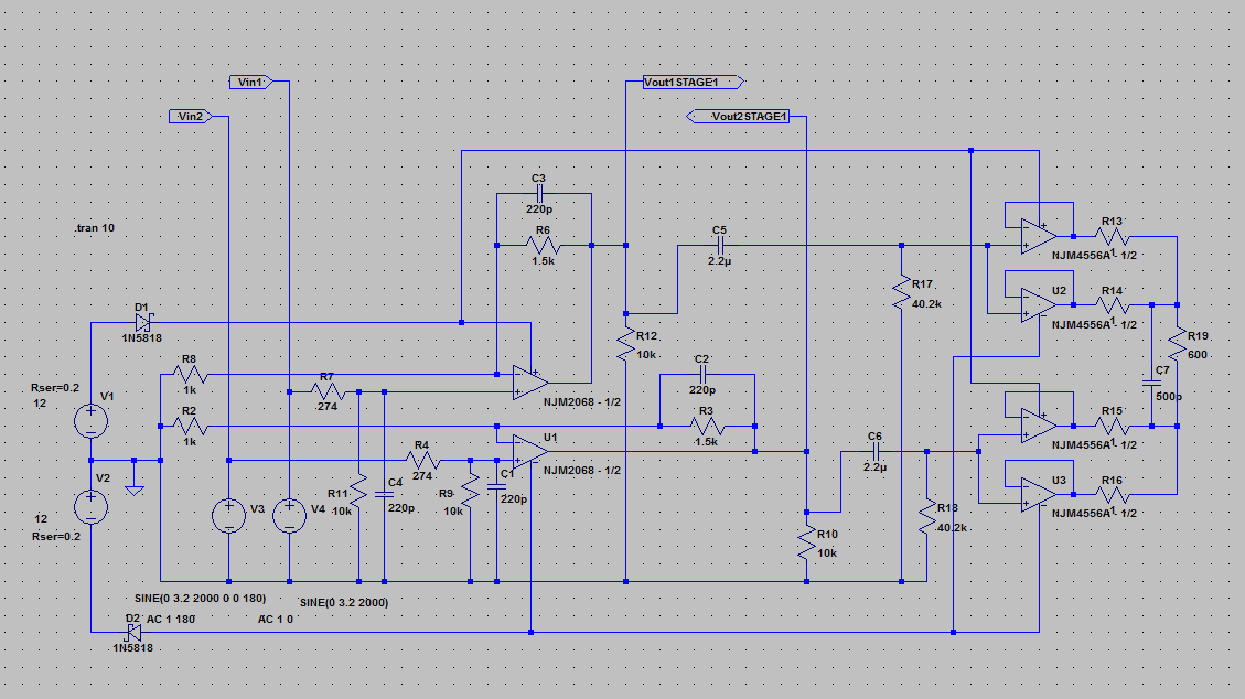

Attached - LT Spice sim of one O2 board set up for balanced output into 600R with 500pF in parallel for the headphone cable. Driven with out of phase 3.2Vpeak (2.26Vrms) with 2.5x gain, +/-12V supplies. That input level is as high as I could go in the sim to preserve a good waveshape with the balanced config.
Disclaimer(s): I can't claim to know squawk about balanced systems, never have messed with them much, so I may have mucked something up here. Also just to re-iterate RocketScientists' warnings about hearing and equipment damage! So not recommended that anybody actually do this, just academic curiousity. 🙂
The key is at the top of the plots. Green and red are the 180 degree out-of-phase 3.2Vpk inputs to the two channels. Dark and light blue are the 1st stage outputs of the two channels. Magenta is the difference voltage across the 600R load, which would be equivalent to putting a DMM or isolated scope probe directly across it - what the balanced headphone would see.
With the 3.2Vpeak differential input, the difference output shown is 15.6V peak = 11.0Vrms. All is sinusoidal, of course, if anybody hasn't seen it yet check out RocketScientist's good recent blog post on music power. 🙂 That would be 202 mW into 600R.

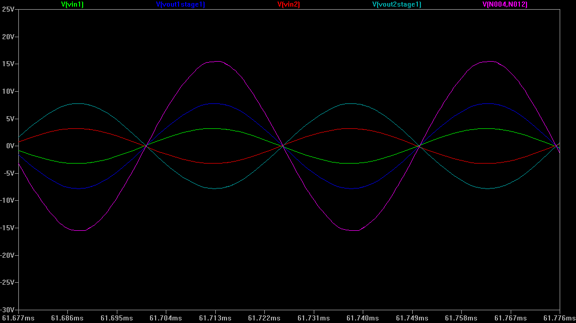

The remaining two plots are the same thing done at 10Hz and 20kHz inputs.
