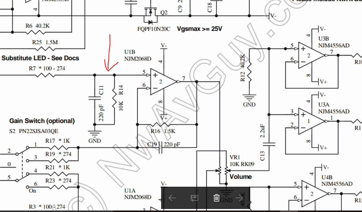

Hey guys, I recently have started making an o2 amp. While checking through all voltages on the board, using NwAvGuy's guide NwAvGuy: O2 Details I noticed that the DC offset at P2 measured 36 mV and 16 mV, which is a lot higher than it should be. According to NwAvGuy, it should be less than 8 mV. I measured the voltage at the op amps but again it was the same values and swapped around, they presented the same value, so I don't think it's the op amps.
I checked all the solder connections, reheated them, and the resistors R12 and R13 both measure 37k ohm.
I then checked pins 1 and 7 on U1 as according to this post http://www.diyaudio.com/forums/head...eadphone-amp-diy-project-378.html#post3806667 and the voltages came up fine.
I'm wondering what I should check at this point or fix, or whether 16 and 36 mV is fine?

Hey all.
I have an O2 built from a PCB NwNavGuy sent me way back when, in the JDS enclosure. It's been working great for a few years. Recently, I built up a Raspberry Pi 3 with Allo Boss DAC running MoOde Audio. I just got an iFi iPower 5V for it too (nice improvement in sound quality from that!). Then I noticed that I have a problem... Ratty buzz or hum, like a ground loop.
Here's a funny thing -- That buzz only happens when no audio track is playing from the RPi. If I put MoOde Audio on pause or stop playback, no hum. (??)
To troubleshoot:
- I tried the RPi playing through my home stereo. No buzz/hum that way, so the problem seems to be in the O2 only.
- I tried the setup with the O2 running from battery power. Buzz still there with a file loaded up but MoOde Audio on pause.
- I tried the original Canakit 5VDC psu instead of the iPower. The hum/buzz is much reduced. It's still there, but barely noticeable. (??)
- Finally, I just noticed that if I put something under the line input plug to prop it up (puts leverage on the input jack) the hum/buzz goes away completely. This makes me suspect the input jack is not making good contact with the ground bus on the pcb. The thing is, I re-heated all the solder joints yesterday, to make sure of no cold joints. Nothing changed. Maybe I'll hit the solder joints again this evening, just to make sure.

I have an O2 built from a PCB NwNavGuy sent me way back when, in the JDS enclosure. It's been working great for a few years. Recently, I built up a Raspberry Pi 3 with Allo Boss DAC running MoOde Audio. I just got an iFi iPower 5V for it too (nice improvement in sound quality from that!). Then I noticed that I have a problem... Ratty buzz or hum, like a ground loop....
I think I've found the answer. From O2 Mistakes
"Don't forget the wire you have to solder onto the middle front (ground) terminal on the input jack and wrap around the nearest case cover screw. This single point ground puts the case at the same potential (voltage with respect to earth ground) as the PC board ground, which helps eliminate sources of noise and hum."
Ah ha! I don't think I have the case grounded to the pcb ground. I'll try that this evening, see if it makes a difference.
