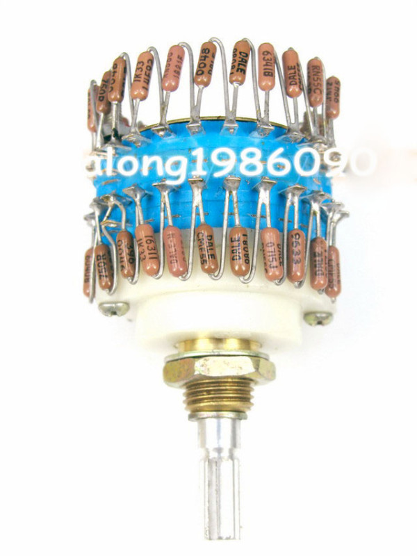

I solve this problem by connecting input somewhere in the middle of the pot so that it becomes a ~12k pot. Adjustment is pretty bad now...1st step is my normal listening level 😀 I guess I could customize the steps..I can use resistors of the remaining ~11 steps. How would you go about solving this, Mooly? 🙂
It sounds like the pot/and/or wiring is picking up stray interference. Also, if you have built the O2 on anything other than the official PCB then you need to ensure your wiring and grounding scheme is OK.
What would I do 🙂 I'd use a good quality conventional pot. I don't like stepped attenuators for these very reasons, prone to noise pickup and too course in resolution.
