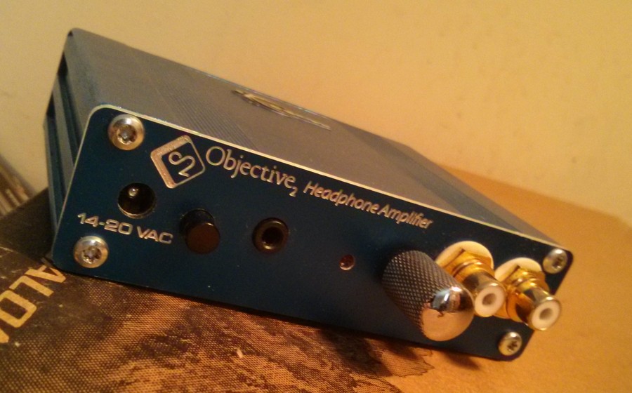

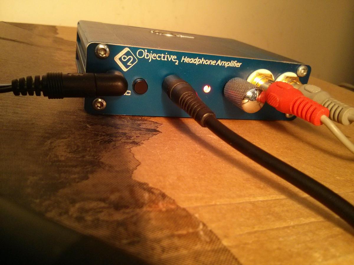

First post! Just thought I'd show my take on the O2. It's the standard sized case with RCA sockets and the front panel I had made by Shaeffer-ag. Knob is from an old effects pedal.
Next step is to put an ODAC in there too.
