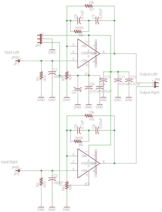

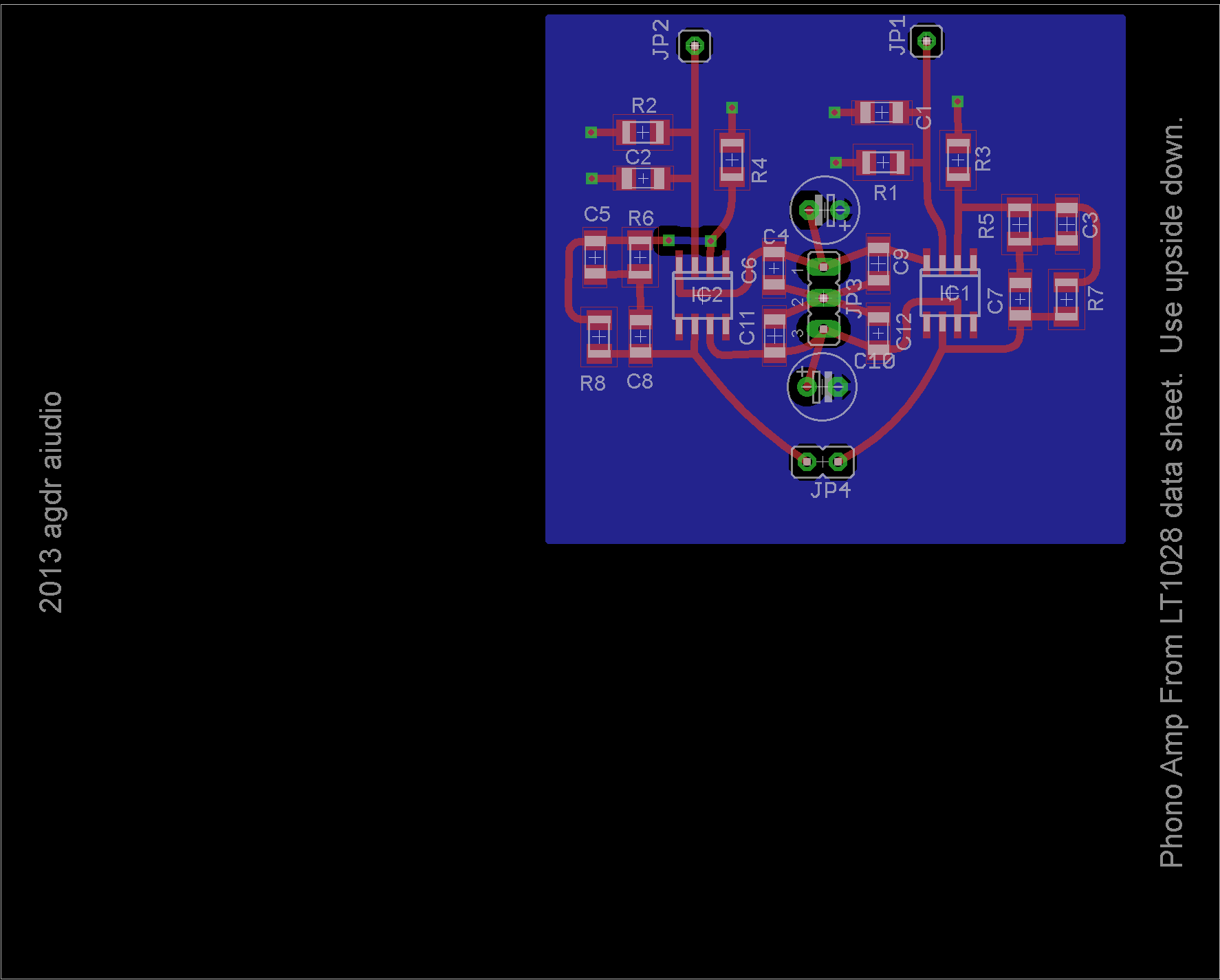

DJNUBZ - here is an implementation of the simple phono pre-amp in the LT1028 data sheet
http://cds.linear.com/docs/en/datasheet/1028fb.pdf (opens PDF, picture top of page 18)
that would fit in the top slot of an O2 amp in the taller B3-080 case. The board goes updside down from the image so the two electrolytics point downward. The power and ground wires into the O2 power, outputs go to the O2 input PCB holes, and inputs probably should go to RCA jacks mounted in the O2 amp front panel (that would fit with the taller B3 case).
I know you have wanted that phono pre-amp for a while.

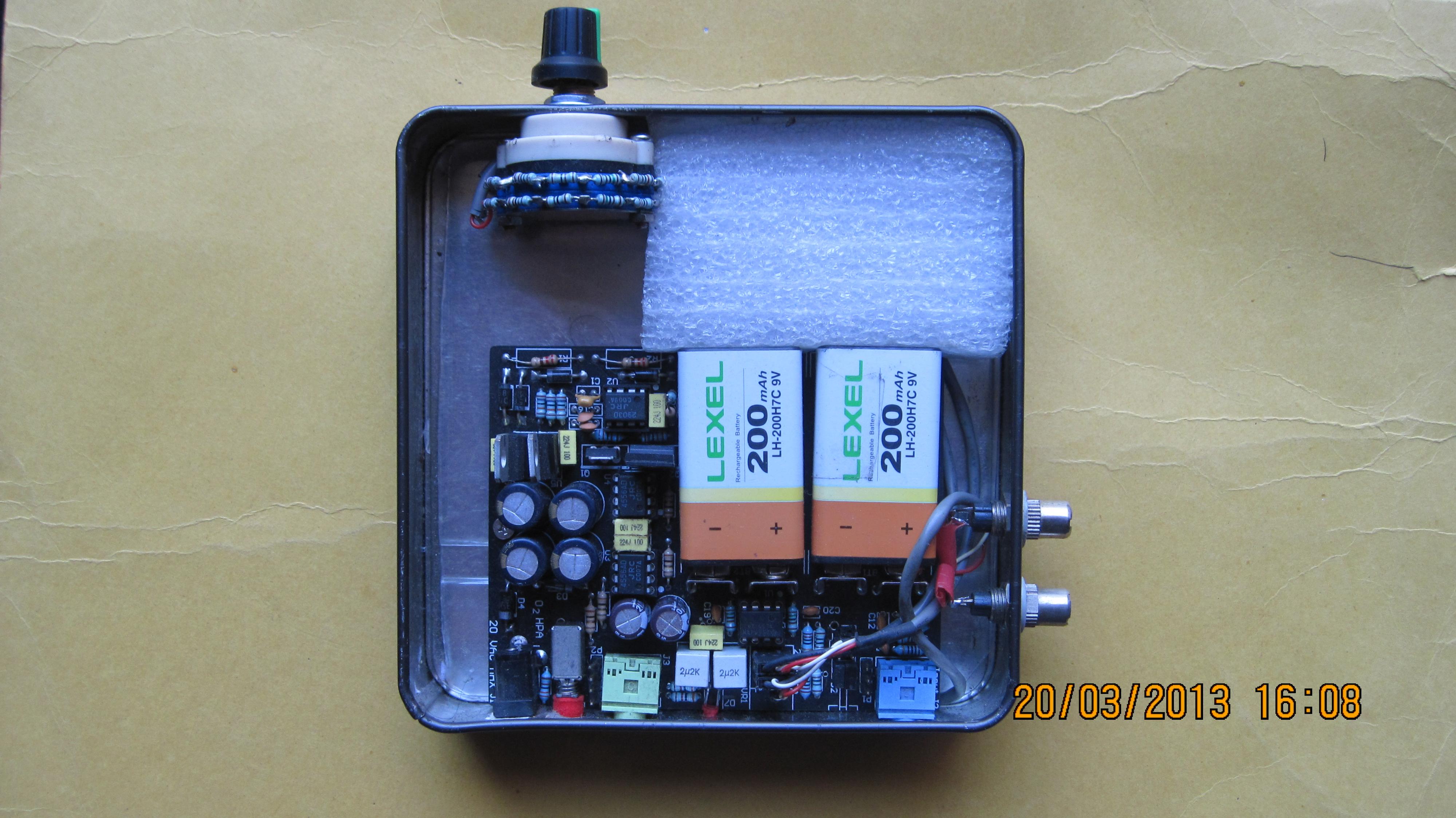

I can upload some more snaps of my O2 to help you out with RCA, 1/4 H/P, e.t.c. connection or PM you.

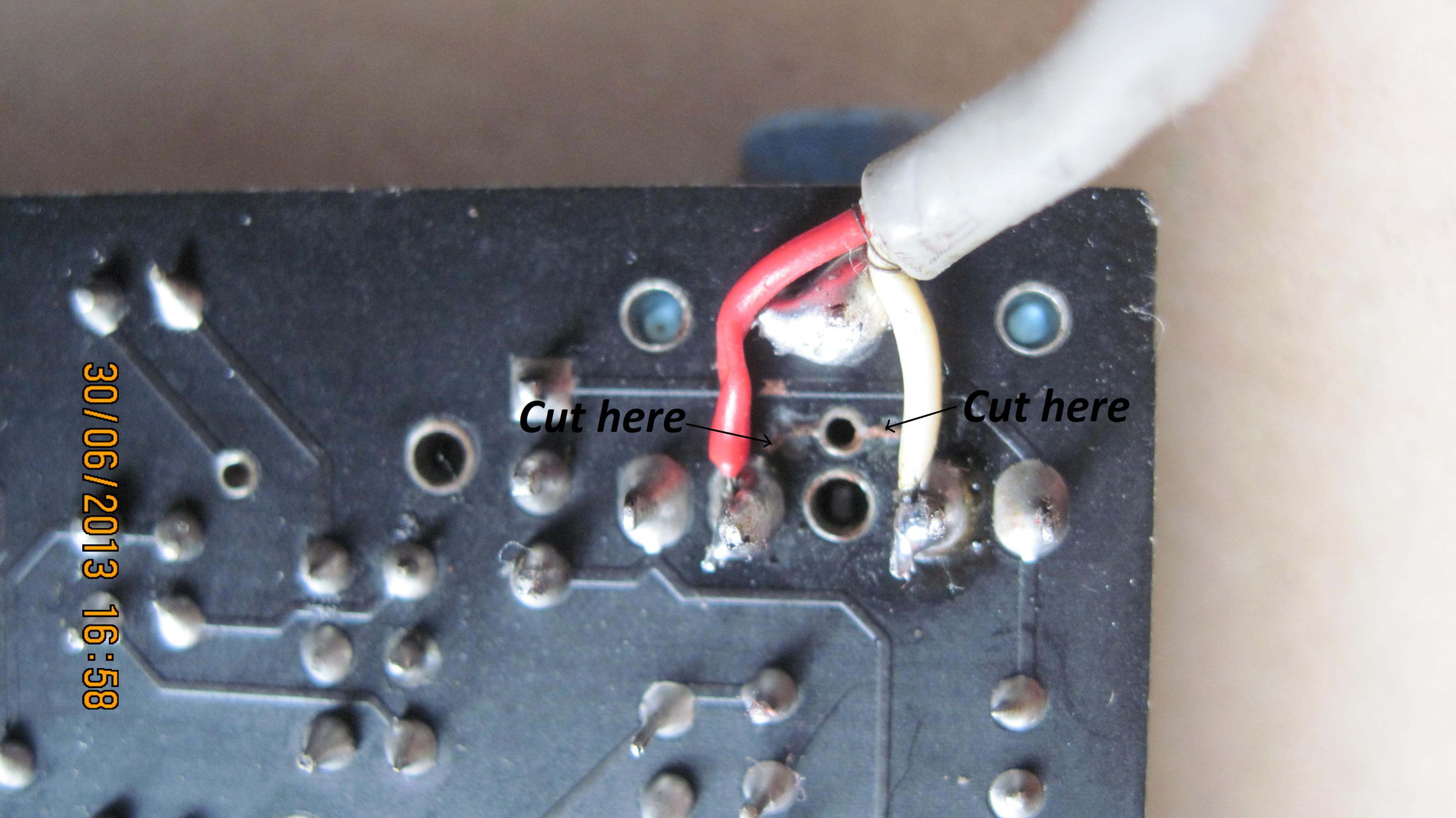

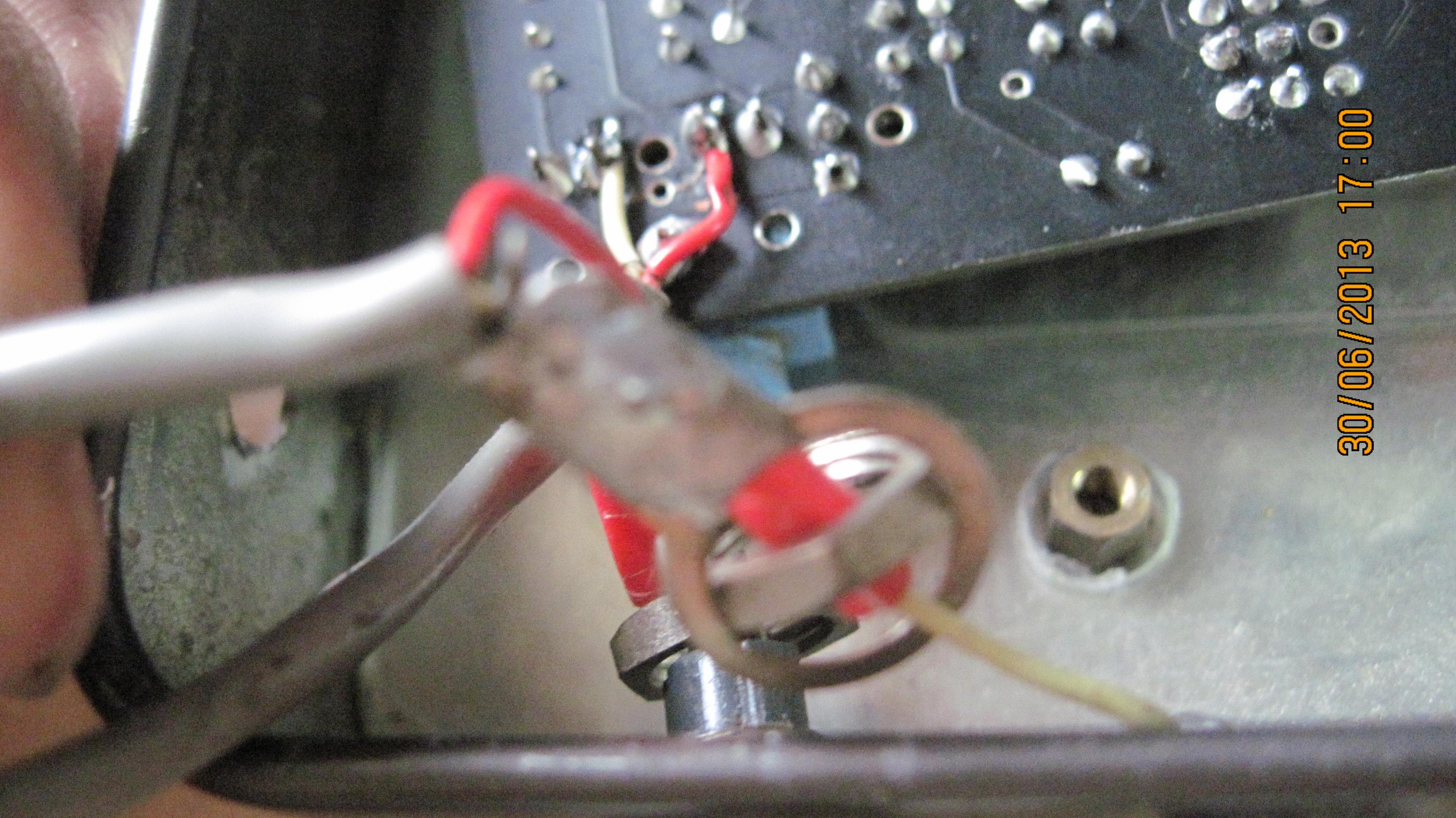

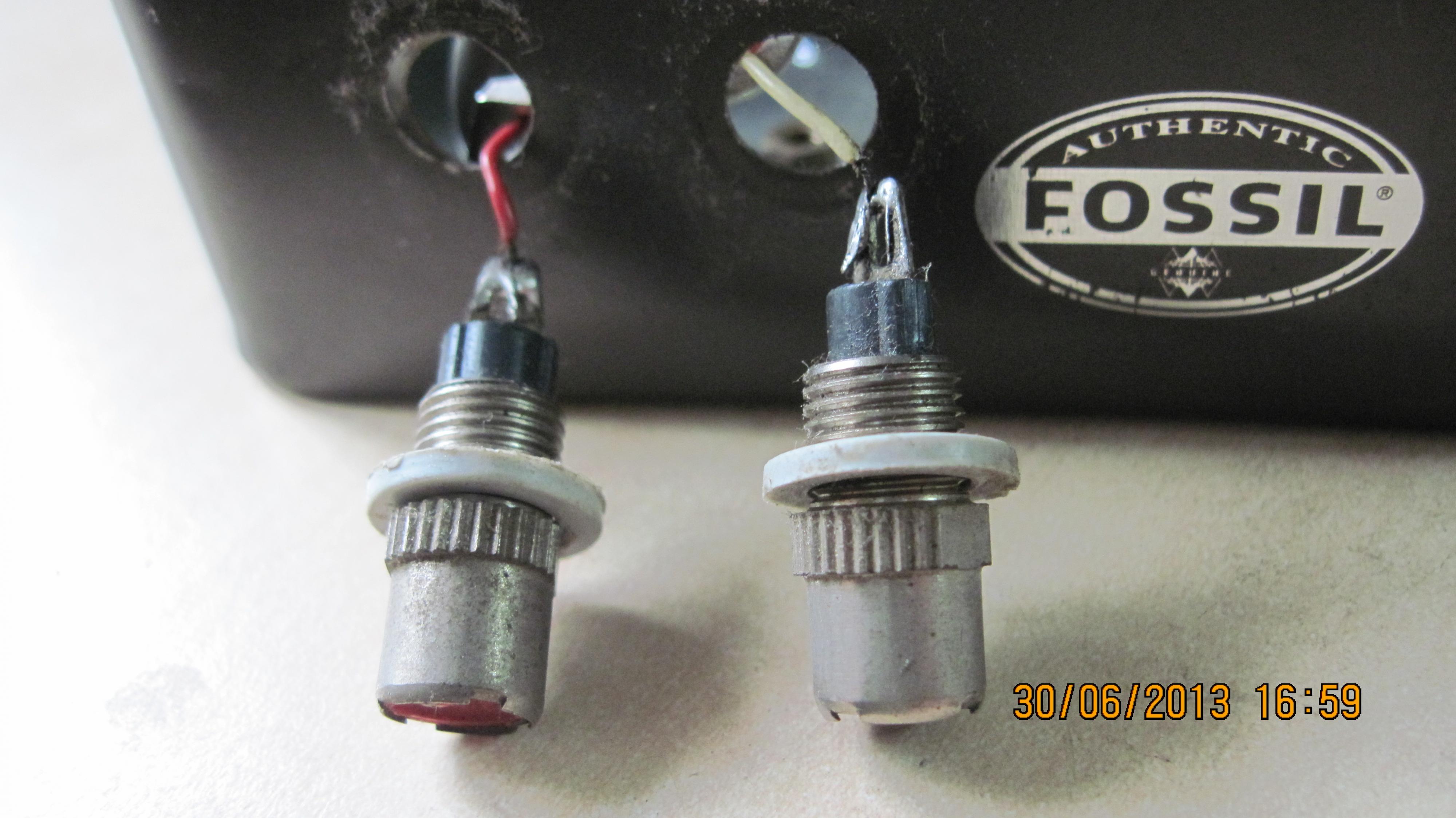

Steps for RCA connections
@sallau
Before proceeding-remove any batteries / AC power.
Steps for RCA connections-
1. Carefully cut the GND track joining 3GND & 4GND using a sharp knife. Use continuity meter to verify that there is no continuity between points GND & 3GND or GND & 4GND.
2. Strip stereo shielded cable & solder one of the inner two wires to point 3GND & the other wire to 4GND. Usually RED is LEFT CH. & WHITE is RIGHT CH. The outer copper mesh /shield is common GND. The end result should be something like image01.
3. Solder the inner pin of each RCA connector to the respective RED & WHITE wire. The outer “ring” of the RCA connector is common GND.
