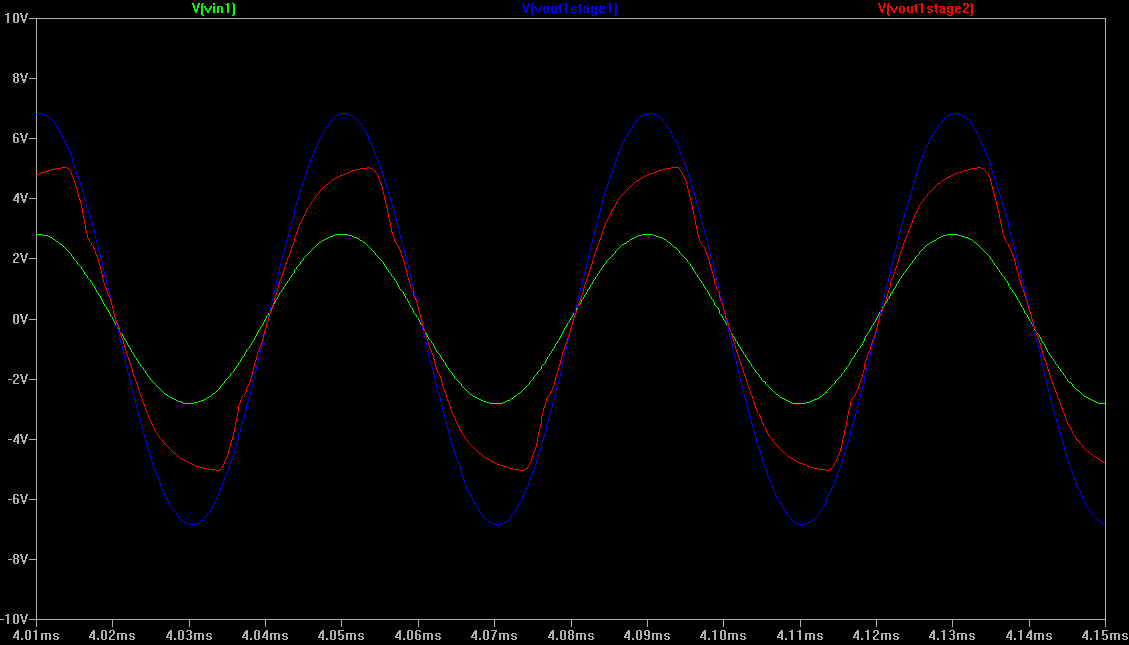

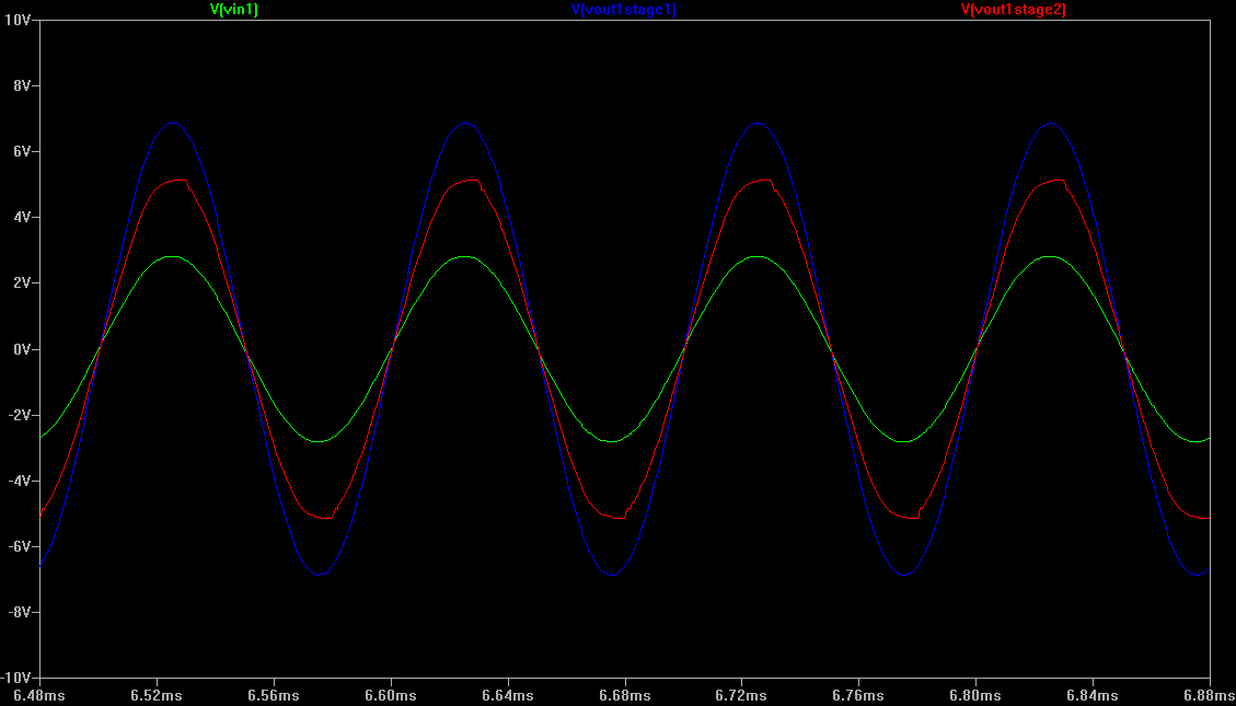

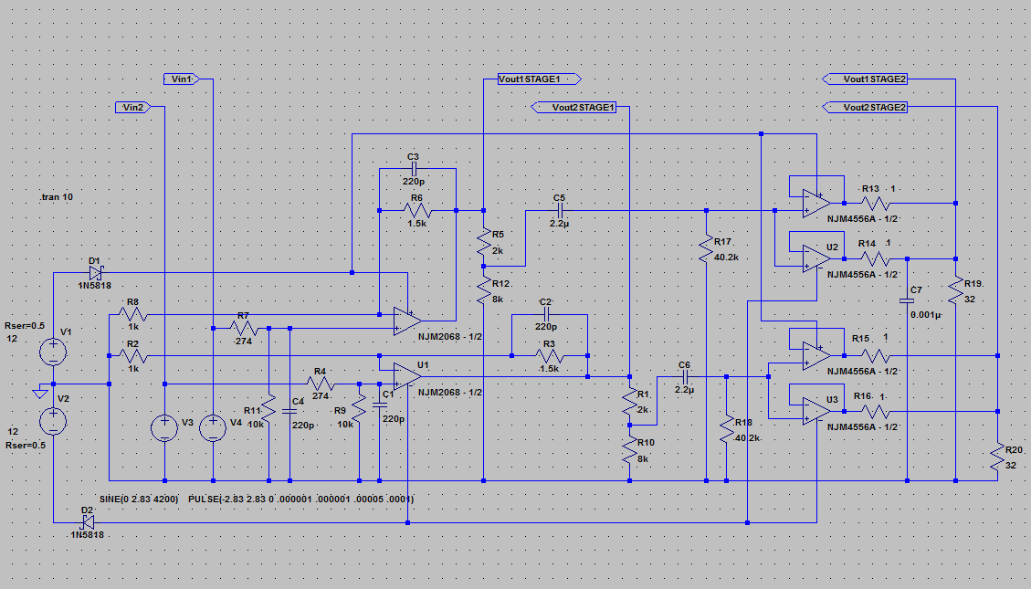

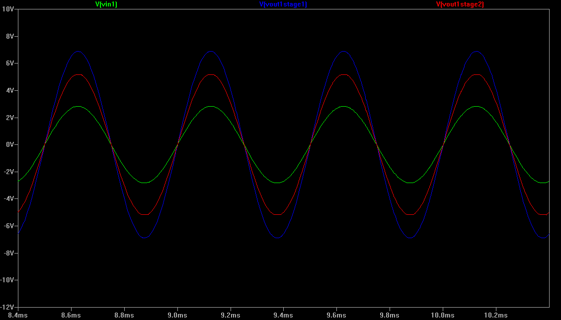

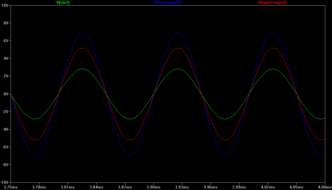

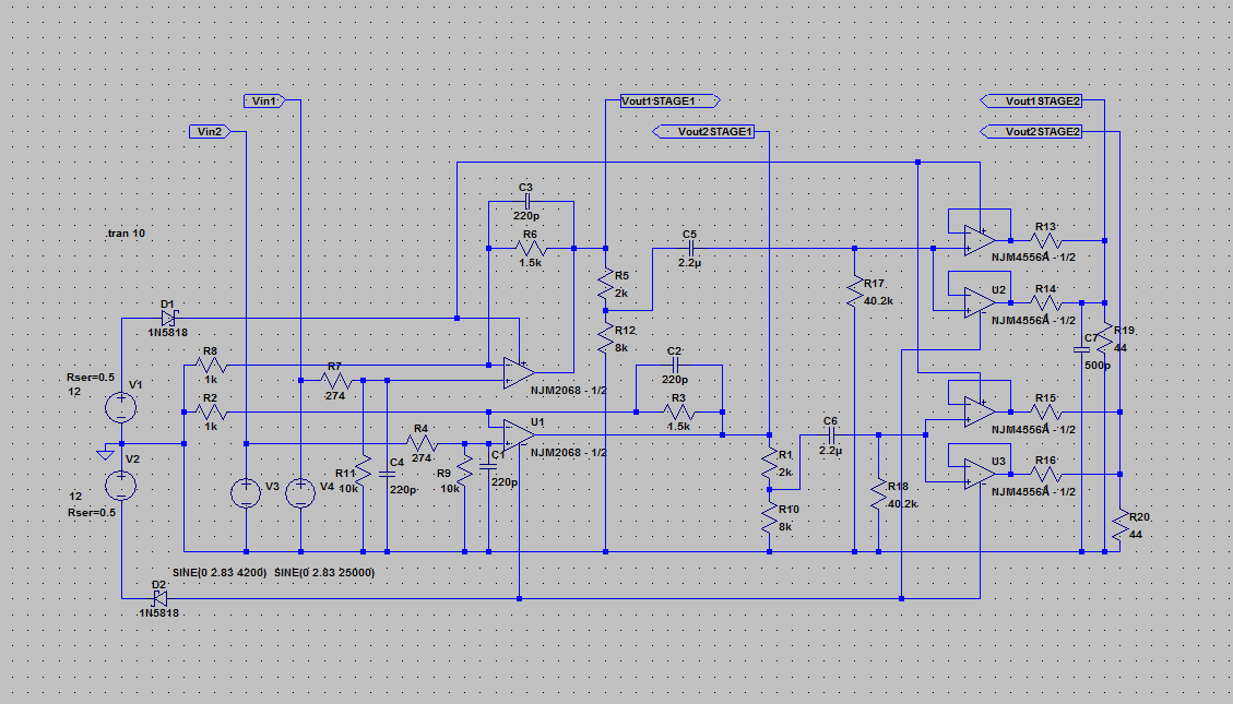

O2 signal path sim using real NJM models!
Well it turns out that New Japan Radio actually does have Spice models for the O2 parts! Fairly good models too. Each model comes with a verification/comparison document of the model vs. the actual part measurements in a test jig for various parameters. The NJR Spice models work just fine in (freeware) LT spice when new symbols are created and linked to the NJM model subcircuits.
NJM4556A (macromodel in lower right corner, site registration is required)
NJM2068
The Spice simulation really doesn't add anything at this point to the O2 results since RocketScientist has made actual measurements with his equipment. But for any electrical engineering students out there who may be buying an O2 and wanting to try their hand at inserting the models in LT Spice, this is proof it can be done! 😀 Hint: the subcircuits are for dual chips, as shown in the schematic below, so you have to supply 4 inputs, 2 outputs, Vcc and Vee and the symbol then has to have 8 pins in the appropriate order to match up with the subcircuit arguments.

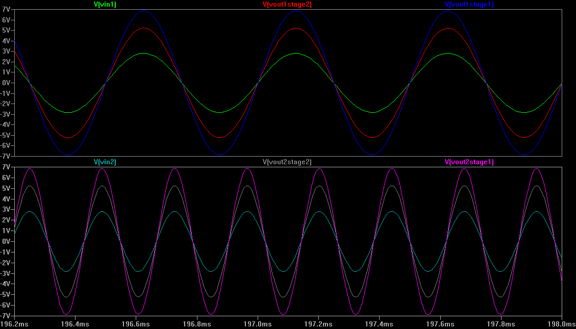

The legend on the plots are at the top of each and match up with the labels in the circuit. The top plot is the top channel and the bottom plot is the bottom channel. The input signal is 2Vrms for each, with the top running at 2kHz and the bottom at 4.2kHz just to be different. The pot is "set" at 80% rotation for each channel with the 2k/8k resistive dividers. The load is 44R resistive, Shure SRH840 or 940. Clicking on the arrows in the lower left of the plot with blow it up to full size.
Something fun to try: slap some capacitance (150pF, 250pF, 500pF) across the 44R load to simulate headphone cable capacitance and then check to see if the amp simulates as still stable with no ringing (it does).
Notice that right now the input signal and the output signals of the two stages are all in phase since the audio band frequencies are significantly less than the Fc of the input RF filter, the RC stage going from the pot into the output stage, and the op amp feedback loop compensation RC. Another fun thing to try is increase the input frequency closer to the Fc of each, say 200kHz, and then check phase and amplitude vs. audio band signal at 25kHz. Everything works the way it should. 🙂 With proper part selection like this the audio band passes through unfazed but RF and gain at RF frequencies (which can produce oscillation) gets reduced toward unity.

@agdr, thanks for the sim notes. I didn't know about the models for the NJM parts. That's a good find.
I'm curious what the sim does with a 32 ohm load (I used the Sennheiser CX300 headphones) and even 0.1 uF (100,000 pF!) in parallel? In real life the O2 still doesn't become unstable with 10 Khz square wave even at that high capacitance.
Also, did you use 1/2 ohm output resistors (rather than 1 ohm) on purpose to compensate for the 4556 "dual" model in some way?
RocketScientist - those NJM4556 chips do have an amazing ability to handle load capacitance! Headphone cable capacitance and parasitic headphone capacitance shouldn't be a problem with the O2. I've run sims below with the 32R and 0.1uF on one channel, and again with 32R and 0.001uF (1000pF).
The output resistors actually are 1R. The labels for the 4556's (NJM4556- 1/2) are just sitting right on top of the "1R" labels. 🙂 Thanks for the heads up on that, I've moved the resistance label above the resistors here.

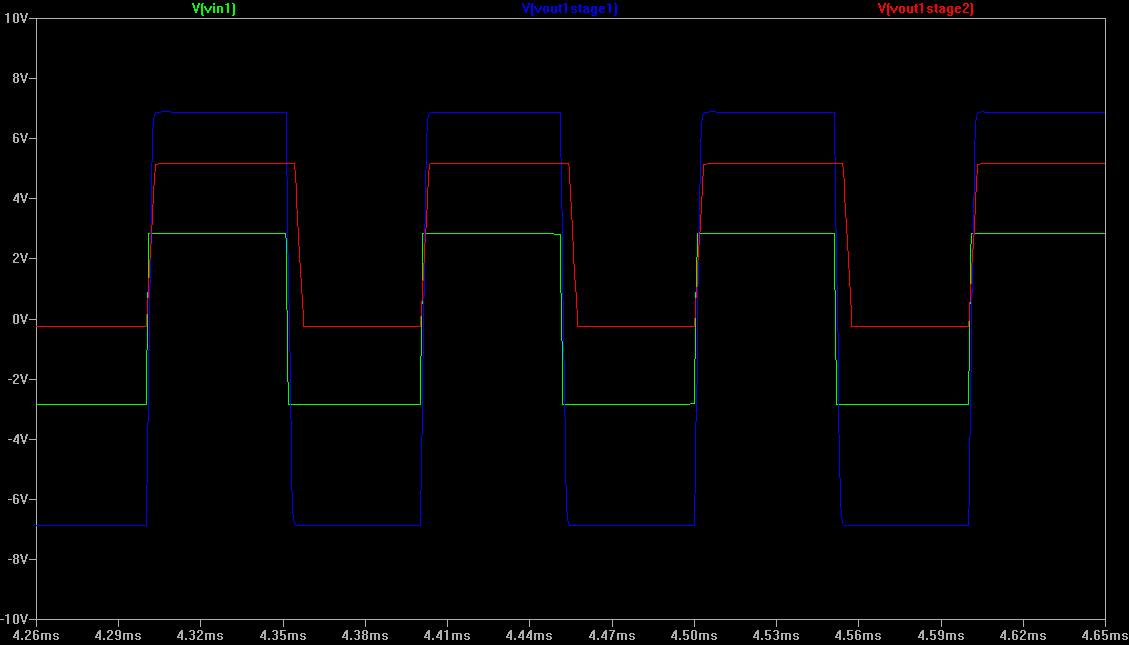

The first plot is 32R with 0.1uF across it at 2kHz sine, and the next two are the same at 10kHz sine and 25kHz sine. No oscillation, just a small amount of waveform distortion on the 4556 output at the two higher frequencies. But good grief, that is something like 500 times the capacitance of a headphone cable! Pretty impressive. The next plot is 10kHz sine with 32R load and 0.001uF across it. Also just a reminder to anyone reading this - it is just a sim - the actual circuit measurements are the truth of course. 🙂
The last plot is 32R load with 0.001uF and with 10khz square waves. I'm clearly doing something wrong here to have the output just going between the positive rail half, and I'm not seeing the problem right at the moment. But the waveshape looks good given that high capacitance and high current load. No significant undershoot, overshoot or ringing.

@agdr I believe the offset in your last square wave plots is a simulation issue as you suspect. I've not observed any such offset from the O2.
