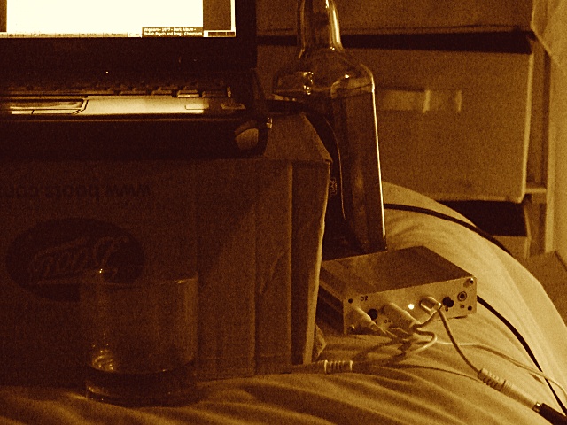

In the meantime I'm listening, on my bed in my dimly but warmly lit room, to my O2+Odac with a nice bourbon and the 800 CD collection of my off-the-beaten-track-musical-taste flatmate. Here's raising a glass to Wigwam "Dark Album" which I've just happily barged in to.
