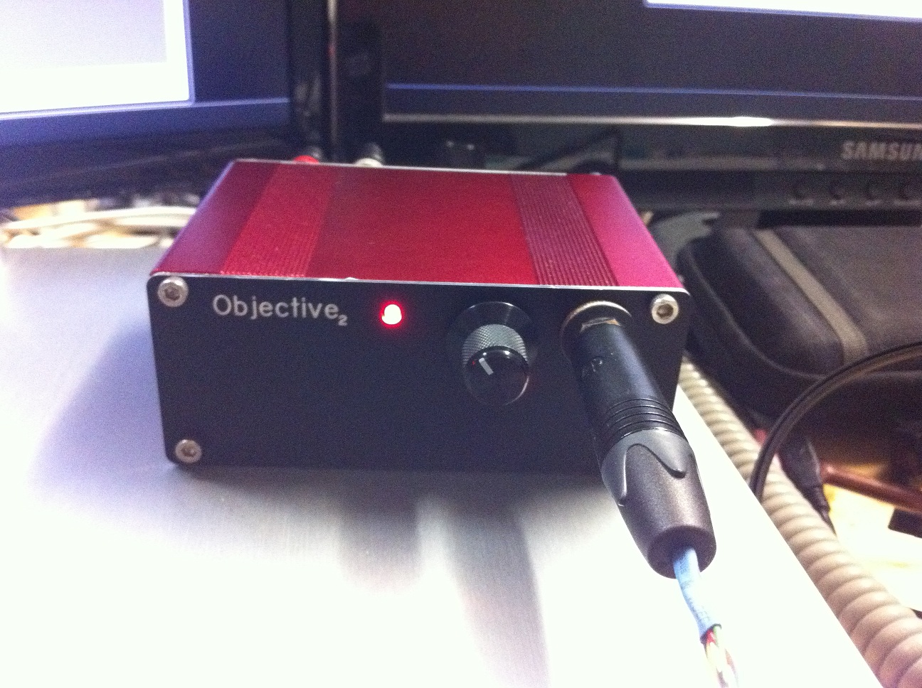

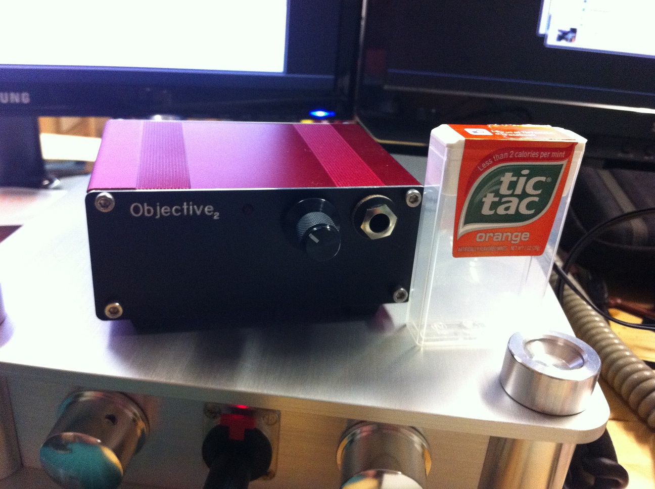

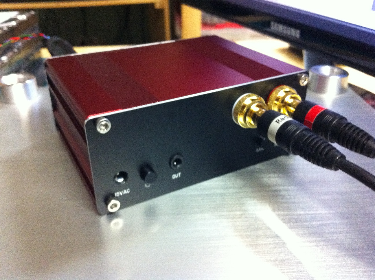

Pics of the o2 i built today for a customer. Nothing special inside except I used sockets for solderless gain changes
the outside I used some stainless hex socket cap screws and a black metal knob. The back RCA is gold plated.
