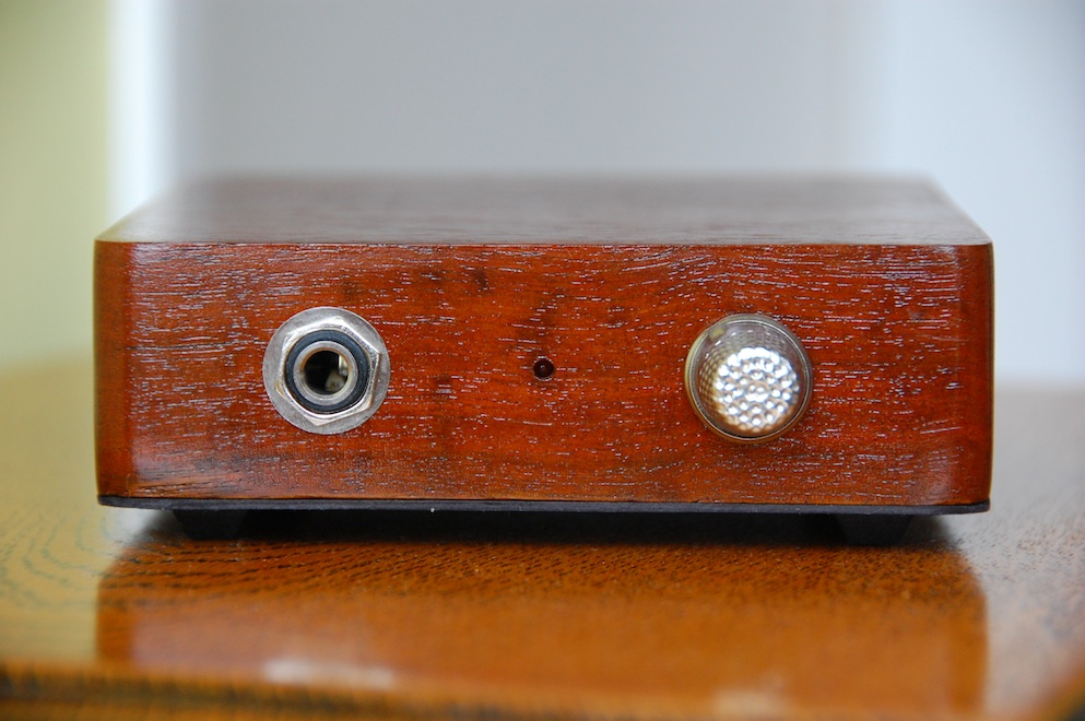

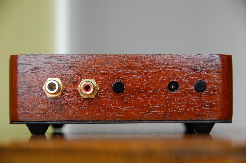

Hey, nice pictures of the custom cases and the bamboo front panels, too. It's very interesting how this O2 revolution is taking on different directions from an aesthetics standpoint. Lots of great custom work going on out there.
