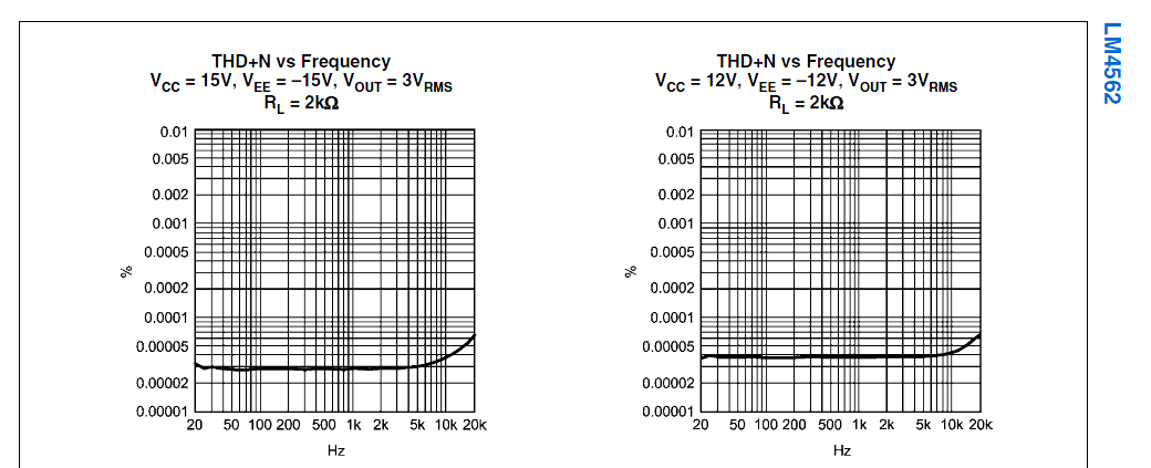

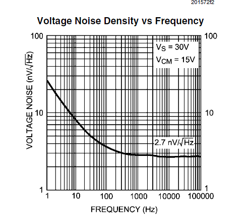

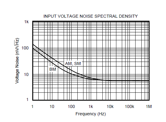

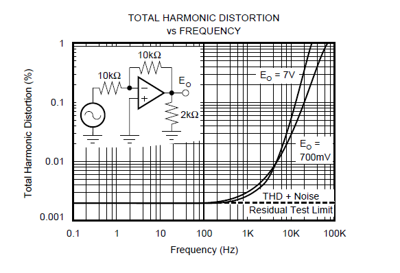

Hello MoonL,
Thank you for sharing your build! The case is just fantastic as so is your PC board. I wish that I had woodworking skills like that. :)
I have a suggestion. For an upgrade chip on the gain stage you might actually get more milage out of the $3 LM4562 (same chip as the LME49720). I see RocketScientist has done a review on the LM4562 in his latest op amp review:
NwAvGuy: Op Amp Measurements
The OPA2111 is certainly a high end chip - I see it goes for about $17 USD - but it may be more tailored to life as an instrumentation amplifier. The LM4562 is probably more optimized for audio. Here are a couple of comparison graphs I pulled off the data sheets. It is hard to get an apples-to-apples set of test conditions with data sheets, but these are fairly close.
The first (leftmost) graph is OPA2111 THD+noise distortion vs. frequency and the second graph is the same for the LM4562. Both are feeding a 2k ohm load with +/-15V rails. The LM4562 is only swinging 3Vrms though while the OPA2111 is doing 7Vrms. On the 20kHz end of the graph the OPA2111 is clocking in at 0.1% THD+N while the LM4562 is at about 0.00007% THD+N. On the 20Hz end of the graph the OPA2111 is at about 0.002% THD+N while the LM4562 is at about 0.00003% THD+N. Lower is better, of course, in these.
The third graph is the OPA2111 input voltage noise vs. frequency while the forth graph is the same for the LM4562. Both are done with +/-15V rails again. On the 1Hz end the OPA2111 clocks in at around 100nV/sqrt(Hz) while the LM4562 gives about 28nV/sqrt(Hz). On the 20kHz end the OPA2111 runs at about 5.5nV/sqrt(Hz) while the LM4562 is down to 2.7nV/sqrt(Hz). Lower is better again.
If you happened to socket that gain IC and have an opportunity to try the LM4562 in place of the OPA2111, I would really be interested in your thoughts on the listening results! The numbers on both chips are so good that any difference may turn out to be totally inaudible anyway. But at least the LM4562 may save you some money if you build any more O2s.
Thanks again for sharing your build pictures and info! :)
