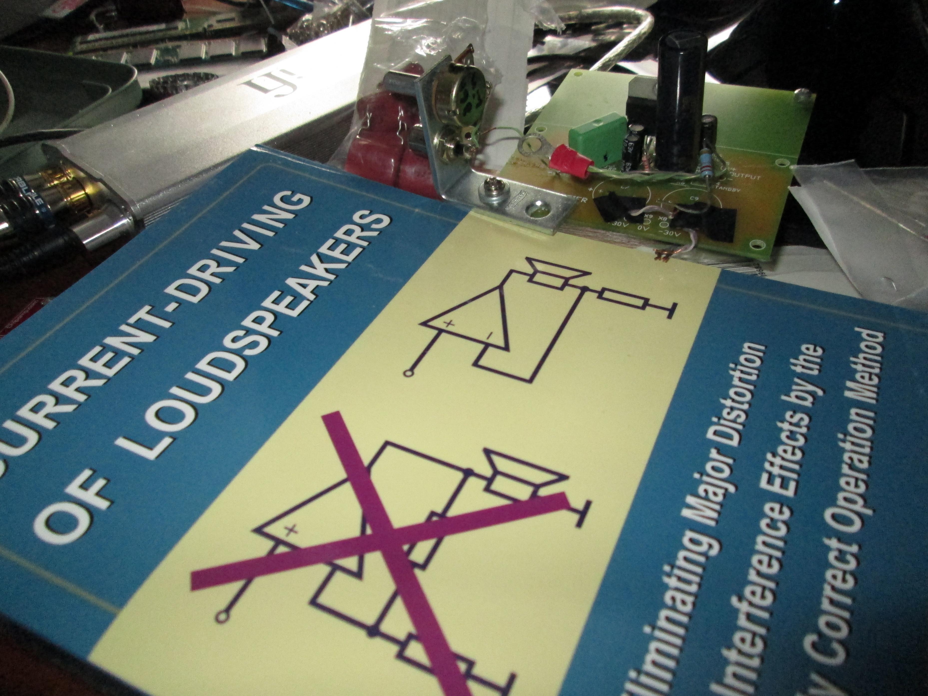

On that note, current drive is supposed to be better for speakers, although somewhat more difficult to implement. So perhaps the same could be true of headphones? Just EQ out the impedance curve If you can measure the impedance of your headphones this should be easy. Unless your source impedance changes with volume, then the EQ would wander.
The serious flaws of voltage drive - Current-Drive - The Natural Way of Loudspeaker Operation
Any headphone which has an almost perfectly resistive impedance is basically operating in current-drive due to its own internal resistance swamping out the coil reactance. So those AKG's probably tolerate high source impedances better than most headphones.
It reminds me of current drive too. I've played with currentclones and loudspeakers but ... I've been keeping that way of looking at it quiet because it would be confusing to people with less technical knowledge.

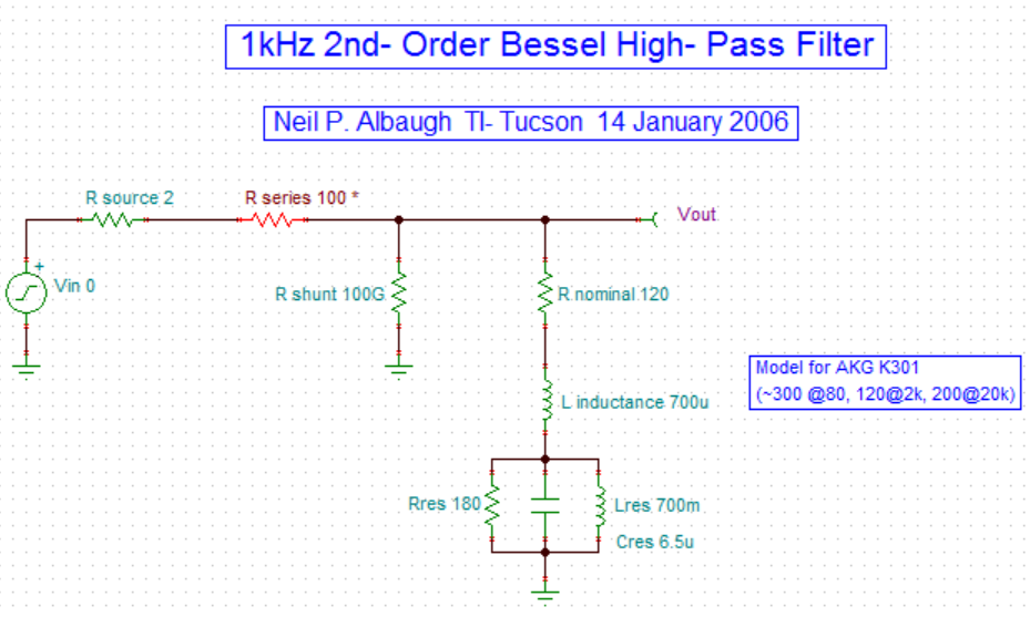

Perfect, thanks xnor. I'll get to step response and damping soon, first I want to explore frequency response.
I tried to model my AKG K301 as 300 ohm res peak at 80Hz, dipping to 120 at 2kHz and up to 200 at 20kHz.
(Not in this case because I have no graph but ... what's cool here is that if you produce an electrical circuit that follows the impedance of measured headphones then the electrical circuit is modelling both the electrical and mechanical properties of the phones!)
So ... you start with the nominal resistance 120ohm, then you add a resonator circuit that produces the peak at 80Hz [RLC res, 120+180=300], then you add an inductor to cause the hf lift:

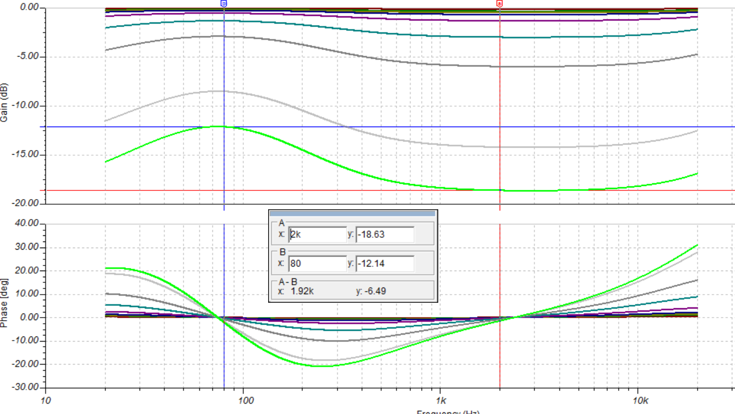

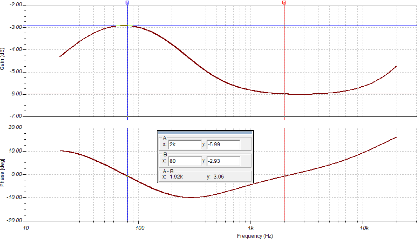

I just opened a Tina simulation and cut out the middle, here's the frequency response for a variety of R series
Basic 2 ohm out for source then totals of 2, 7 [ipod], 10 and 20 ohm [standards], 50, 120 [standards], 500, and 909 ohm.
Nothing significant for the lower output impedances but, of course, my crazy circuit produces a 6.5 dB hump at resonance (assumed 80ish) as predicted by xnor. Also interesting is that crazy old standard of Rout=120ohm (dark grey) produces noticeable boost and phase shift.
Here's TINA
SPICE-Based Analog Simulation Program - TINA-TI - TI Software Folder
And the circuit if you want to play:
View attachment No Headphone Amp simulation.zip

...On that note, current drive is supposed to be better for speakers, although somewhat more difficult to implement. So perhaps the same could be true of headphones? ...The serious flaws of voltage drive - Current-Drive - The Natural Way of Loudspeaker Operation
Thanks for the link keantoken...
Some posts of Hifiman HE-6 owners using transconductance (current drive) amps as headamp with great results.
HifiMAN HE-6 Planar Magnetic Headphone
First Watt F1, F1J, F2, and F2J are transconductance amps from NP
FIRST WATT PRODUCTS
Here's a great book from 3 years ago and an inverted current clone from a decade ago!
Current drive is confusing and turns everything 'upside-down'. For those trying to get used to seeing things from a voltage perspective (even if idealized and inaccurate) ... 😱

120 ohm produces a 3db bass boost and 1.5dB lift @20kHz on my K301s
