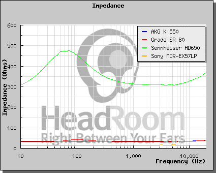

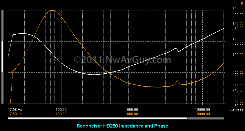

Resistance at 100 Hz = 40 ohms
Resistance at 1 kHz = 30 ohms
1 V input (100 Hz) -> 25 mW
1 V input (1 kHz) -> 33 mW
Higher efficiency at 100 Hz (for example the resonant frequency) means that less power will be dissipated. The shape of the graph would be the opposite.
I'm also talking about real headphones. I was saying ideal because you cannot double the voltage indefinitely. There's usually a limit around 120 to 130 dB SPL.If headphones were ideal we would have nothing to discuss. I'm talking about real headphones. The discussion is about frequency response not amplitude response. Maintain the same voltage input over a range of frequencies and the output will vary. That's what I meant when I said that voltage input is not directly related to sound output.
I do not understand the rest. Amplitude response is the absolute value of the frequency response.
Input voltage is related to sound output, just not in an absolute sense. That's what I meant, hence the "on top of the headphones' frequency response".
There is no such thing as "your maths". Are you tinyman392 from ifans?If you examine your maths you will also see how the dBV relates to power. Double the voltage doesn't result in double the dBV, notice? Why not? Where does the 6 come from, don't you wonder? Could it be because double the voltage results in four times the power, which is a rise in power of 6dB? How can you say the dBV is not about power when the relationship is so clear? dBV may be regardless of resistance, and therefore regardless of absolute power, but it assumes constant resistance, and is therefore directly proportional to relative power. The dB is essentially about power and nothing else but power.

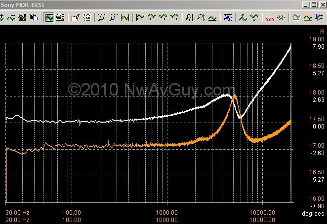

If you look at the frequency response of dynamic headphones you will see that high output impedance will add a peak at the bass. One could also say the bass rolls off faster.]That sneaks in a judgement that makes your argument circular. Headphones designed with 120 ohm source in mind may not be peaky in the bass output. If they were flat in the bass, then a lower source impedance would render them lacking at whatever frequencies the headphone impedance were higher, or peaky wherever it was lower.

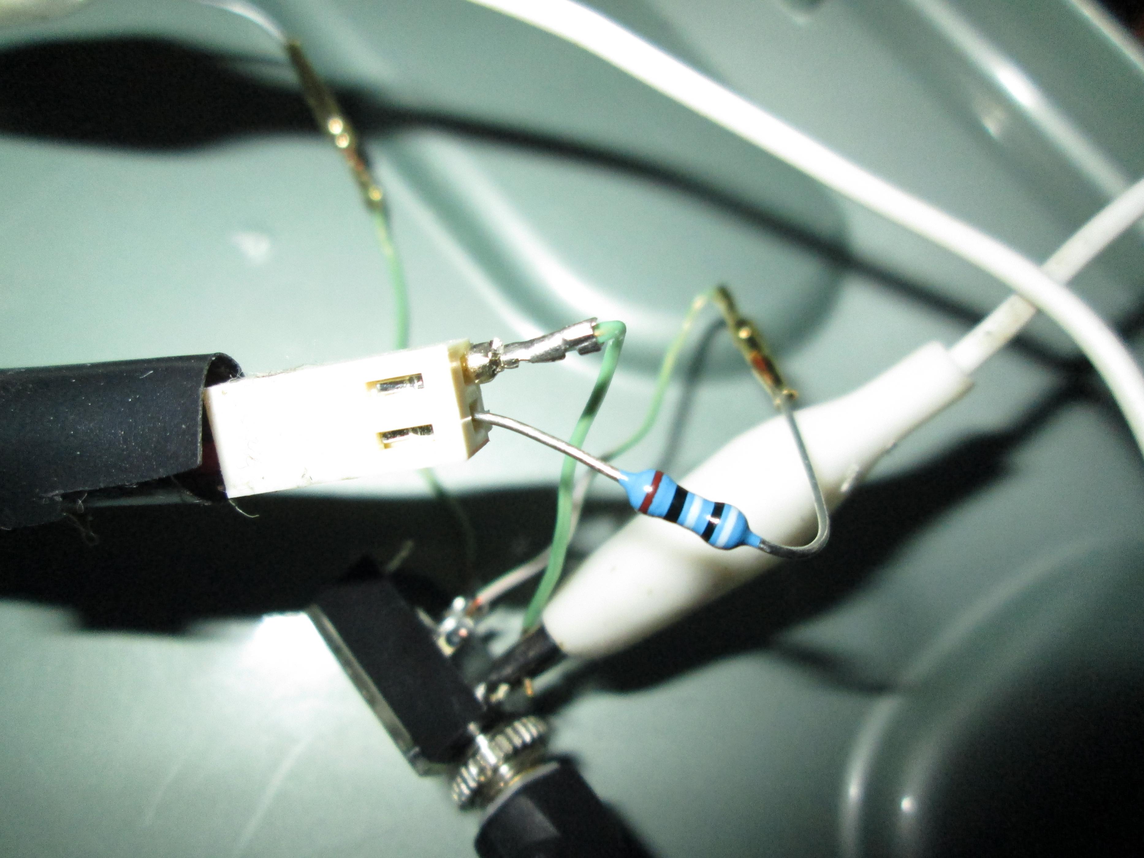

Not op-amps but speaker taps. The resistors are just used as attenuation circuitry and since the manufacturers don't care about low output impedance (the headphone out is just an afterthought in such devices) the output impedance can be rather high.Of course. As I said, added series resistance allows a normal opamp to drive any headphones without fear of overload. For headphones with 120 ohms source in mind, this gives cheap, bomb-proof high fidelity. The recent fad for low source impedance headphone amps rather fouls the plot.
120 ohm source impedance is not about high fidelity, it's about a stupid standard that nobody follows anyway, for example, to protect users to blow their ears with low impedance headphones.
