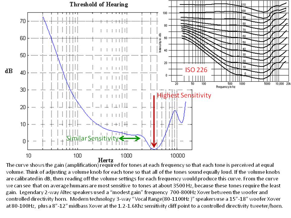

The "vocal range" midbass design philosophy with 80-100Hz to 1100-1400Hz coverage.
The ISO226 sensitivity graph shows that the 3.5KHz region is the most ear sensitive, and although ~1.4KHz is more sensitive to the ear than lower frequencies, there is a plateau in this region that makes it a good choice for standard midbass-tweeter Xovers.

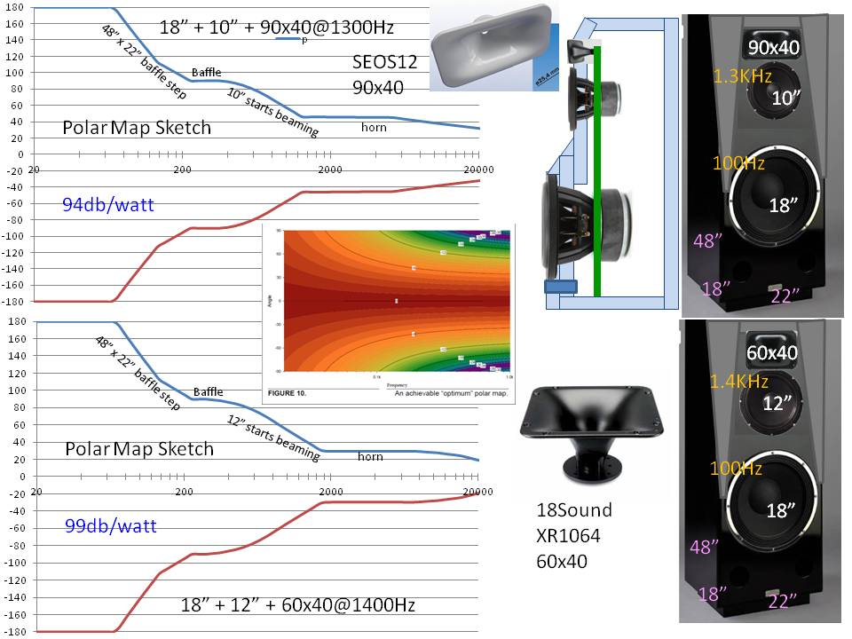

Physics requires that any source which is Constant Directivity cannot also have a flat on axis frequency response at the listener, so flat response controlled directivity designs that narrow the polar response with increasing frequency are popular.
Home Theater: 360degree bass --> 180degree at the baffle step --> 90degree at tweeter Xover frequency; --> 40degree for 10K-20K tweeter physical size beaming.
The ISO226 sensitivity graph shows that the 3.5KHz region is the most ear sensitive, and although ~1.4KHz is more sensitive to the ear than lower frequencies, there is a plateau in this region that makes it a good choice for standard midbass-tweeter Xovers..

Cone profile has very little impact on beaming, which is directly linked to driver diameter.
TMM has made a most relevant remark in #11. Therefore, the choice of the xover frequencies can be based on technical considerations only. In order to maintain constant directivity, crossing over as low as components can comfortably handle is recommended, on the whole.
As vacu said cone diameter is by far the most important factor when it comes to beaming.
Generally a cone beams at 90º when wavelength equals diameter.
For a 12" that happens to be around 1200Hz. If the tweeter has a wider dispersion at that frequency you'd really want to cross lower. Conversely if the tweeter has a narrower dispersion you should cross higher.
Unfortunately I've never worked it out beyond that in detail.
Mostly because I'm lazy, it is easy to remember as it is, I think 90º is a good choice in 99% of all domestic applications and most waveguides and a plethora of horns are 90deg jobs anyway.
Since you mentioned Beyma the obvious one that comes to mind is the TPL-150H at 80º.
No idea where one should cross it to a 12" but I suspect 1400-1600Hz to match dispersion.
