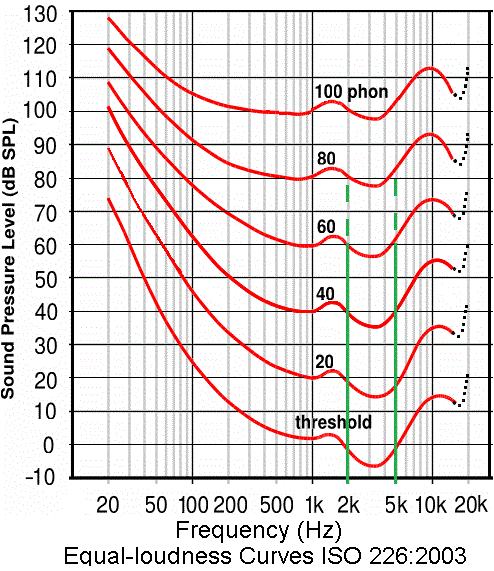

This may have already been answered, but this indeed is the audio-industry-standard allocation and labeling of the c.-10-octave range of human audibility--3 octaves of bass, 4 of midrange, and 3 of treble.
If you meant 'human voice' instead of 'human', you're correct, but the industry's products are expected to cover the vast majority of the audible range of 20Hz - 20KHz.
