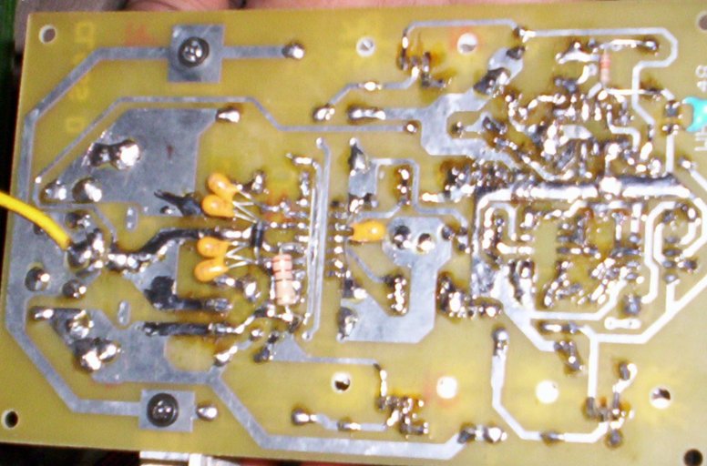

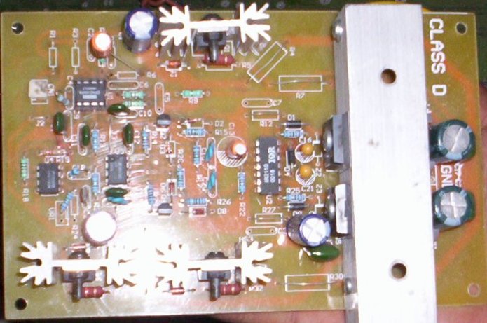

Hi Workhorse
Nobody prevents you from using gapped E ferrites, the useful range of operation of standard low frequency SMPS materials will be extended greatly as the gap is made longer. You don't even need to order them gapped, you may insert pieces of plastic or PCB material to form an uniform gap of the desired length on all core legs. I tried N27 cores at 100Khz that way and they ran cold (because most of the hard job is done by the air inside the gap).
Forget about air cored inductors (except in case you want to confine each one into a thick copper box, which would also change inductor parameters) and consider flux bands with the gapped ferrites. That's the only way to avoid having the switching waveform being induced into every circuit in the nearhood (and thus demodulated). Note that the flux band changes completely the parameters of the gapped inductor, so it has to be designed taking that into account (funny).
BTW: I won't believe you until I see some pictures.
Well, now I have to believe you, but where is the output filter? which switching devices are you employing and which supply voltages?
You don't have much choices with air cored inductors. If you place it in the PCB near the rest of the components, the stray magnetic field will cause induction into all the tracks and components (except if you place the coil in the right axis, or make a dipole or shape it as a toroid)... If you place it away from the PCB, the wire carrying the switching waveform will become the antenna of a nice AM/FM transmitter due to coil capacitance...
I feel than in class D it's not hard at all to get a working design, it's not even hard to make it reliable, the hard part is to make it quiet.

Eva said:Well, now I have to believe you, but where is the output filter? which switching devices are you employing and which supply voltages?
EVA,
The Output Inductor is Offboard....
I would Try the Ferrite cores with Gap in between them and post the results in couple of days...
Devices are IRFP260N , supplies at +-85VDC
